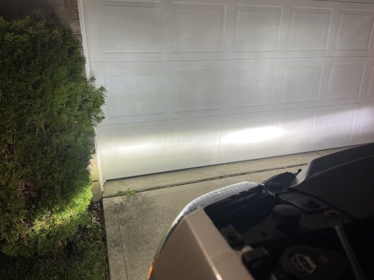

Tried something with the LED fog light bulbs in my ‘13 Escalade ESV.
Was doing some reading and found that the H10 9145 OEM bulb size is the same base/socket as the HB3 9005 (high beam) bulb.
Bulb on the left driver side is:
Bulb on the right passenger side is:
A noticeable brighter output width and distance on the road.

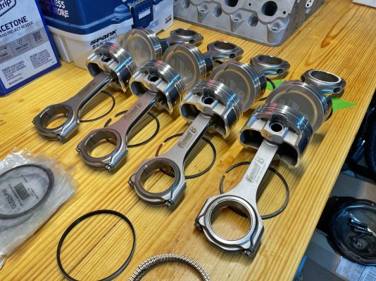

Piston rings are gapped. Aimed for .028 top ring and .030 2nd ring, but I overshot a few of them a tiny bit lol a little loose is fine. Checked the rod bearing clearances. Had to run extra clearance half shells on 2 of them, but now they’re all .0028 with one being .0027 and one is .0029 so I think that’s perfect. Rods and pistons are together now. Those spiralocks are fun but not too bad when you get the hang of it.

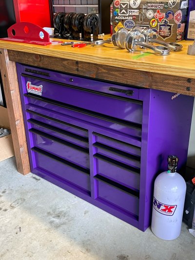

Glad I didn’t make the workbench any shorter! I removed the casters but left the bolts which protrude just enough so it’s sitting in the bolts and not the box. Also superglued some of those little felt pads to the bolt heads.
This 5-75 is such a good range and the size and 3/8 drive is nice. I really like Icon stuff
