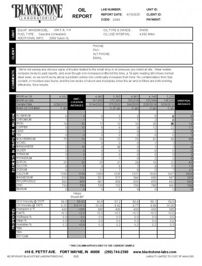

Posted elsewhere but this is where I said we'd test the oil after changing brands.
First is the Yukon XL and oldest two samples were on regular Mobile One and all the others are ACDelco oil"

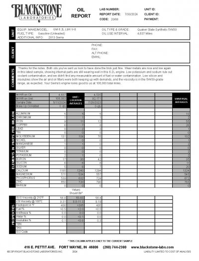

This is the sample from the 2013 GMC Sierra. Oldest sample was taken after 3 oil changes with ACDelco oil and the latest after 3 oil changes with Quaker State Full Synthetic:
