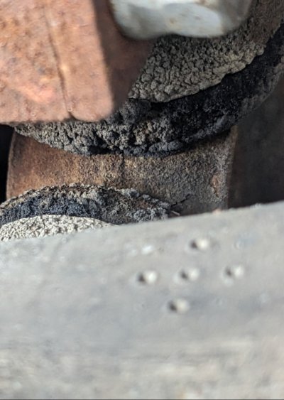

still looking for my weird sound/vibration. I'm pretty sure at 70mph it's the drive shaft. ugh. but the low hum that sounds like it's from the front that starts right at 40 mph. I was hoping was wheel bearings but after having it on the air and listening all around with the stethoscope. I have no idea what it is. not a single sound from the bearings, on the hub or the spring, front or rear. nothing from the front diff or t case. fluid in both look perfect. I'm stumped on that one. going to just have to let it get worse till I can find it. blah
rubber on the u joints is literally fossilized and falling apart. lol they do seem to have outside clips and not the nylon crap. I wonder if should break my own rule and try replacing them. I see rock auto has the gm ones for 140$ each thou.
that doesn't look good but if they still move smooth then they are probably fine, the only way to really tell is to pull the shaft out and check by hand
yeah I didn't feel like pulling the shaft. I was more looking for the front sound. I'll get around to pulling it another day.
half temped to order some hub/bearings anyways. maybe those skf hybrid ones? since at 166k they are probably do. but man, I thought forsure I'd hear something.
I guess it's an excuse to buy one of those mechanics ear things
