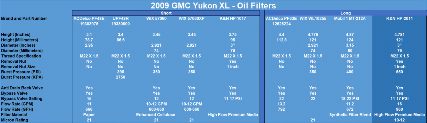

I never really gave it much thought, but I wanted to find a quality filter that had the larger case like the K&N I've been running, but with no bypass valve. I couldn't find one with no bypass, but this WIX had twice the bypass pressure rating (22psi vs. the K&N's 11psi), so I went with it:

I thought the K&N were better all around (psi and micron)?
Nevermind…I just answered my own question. Be quiet, be humble, admit when you’re wrong and learn something new. Damnit!
How did ACD, M1 and K&N lose out to Wix? Probably because they are all now manufactured in China?
45,011
According to that chart, the K&N has a much better micron rating. I didn't even notice this when I was focused on finding a no-bypass or high-psi bypass filter.
There are some conflicting perspectives here. Assuming these figures are factual, which would you prefer? The filter that catches smaller particles but could more easily allow bypass (no filtration at all) or a filter that can't catch as small of particles, but still keeps the oil going through the filter?
How easily and/or often does a filter go into bypass? How small of particle is still okay to circulate through the engine?
BTW, according to the labels, the K&N HP-2011 filters I was using were made in USA.

In the scheme of things and considering the possible damage of a by-pass problem, WIX IMO, wins hands down. For me it has served me well all those years and were on my Harley's as well. I still say also, that the time frame between changes is very important and should be less than any of the oil companies say. I consider all my driving as severe and still stick to a low mileage and short time between changes. It is, IMO, the cheapest insurance I can recommend to take care of the engine.

What's the importance of the oil filter bypass? And about the psi that the bypass opens?
Instead of a long typed response, here is the jest of it:
"The bypass valve – otherwise known as a pressure relief valve – is an integral part of the oil filter. The valve is designed to open when the oil filter becomes clogged or when the oil is too thick. This allows the oil to bypass the filter through a center tube. The oil then goes straight to the engine to prevent starvation and damage.
If the bypass valve doesn’t open when needed, the filter will swell and eventually burst. When this happens, the engine looses all oil pressure. The end result is either extensive engine damage, or complete engine failure. Choosing a high-quality oil filter for your vehicle helps to prevent this from happening."
But remember, if it does open and it does bypass, the filtration is lost but if the filter is clogged enough to allow bypass, it is not filtering anyway.
