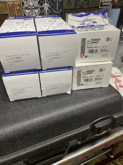

Parts arrived this morning, along with the new O2 sensors delivered late last night
Oxygen Sensor - 12583804
Oxygen Sensor - 12609457
Ride Height Sensor - 15098628
Ride Height Sensor - 15098629 (RH)
Driveshaft Bolt - 11548472

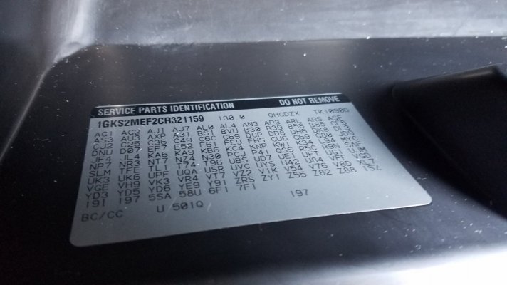

I ordered all the parts from RockAuto. There a quite a few different models of strut "cartridges" and you have to find the ones that have your suspension code listed. The suspension code is usually the last 2 RPO codes listed on the sticker and one is for left and one is for right.
Mine are the 6F1 and 7F1 shown on the sticker below
