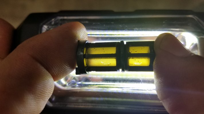

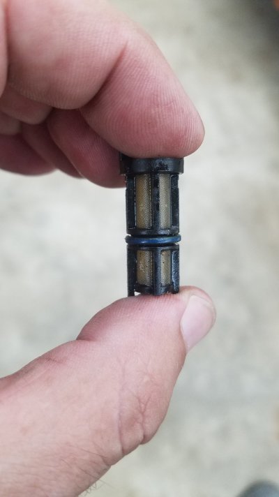

Was the screen underneath clogged, or any debris in it?
Apr 11, 2018
7,124
14,376
St. Louis
Nice. So a clogged filter wasn't part of your issue.
Nope, bad sensor.
Engine ran fine, just yellow engine light on and pressure gauge on zero. Checked DTC, got P0523 (engine oil pressure switch voltage too high). Cleared it, restarted and gauge slowly swept all the way to the other side and light came back on.
When this first came on, we were out shopping and just got back in vehicle to go home. I checked the oil level and it was fine, and there were no unusual noises from the engine. I figured it was just a bad sensor. The oil light never came on and never gave the "low oil pressure stop engine" message on the DIC. Drove it home 35 miles with the dead gauge and engine light on.
