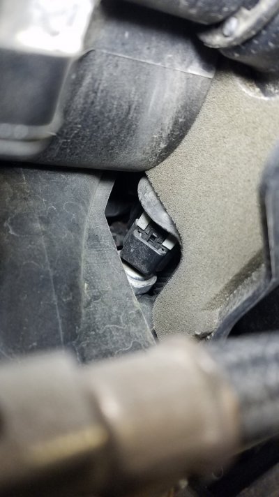

I got the connector off.
I noticed I could get to it with a long screwdriver through that hole in the plastic cover. I had to stick the screwdriver between the fuel rail and fuel hose. After getting grey plug up, I used screw driver to push in on the black tab then used my other hand to reach around to the plug and pull it off 20210629_142549.jpg

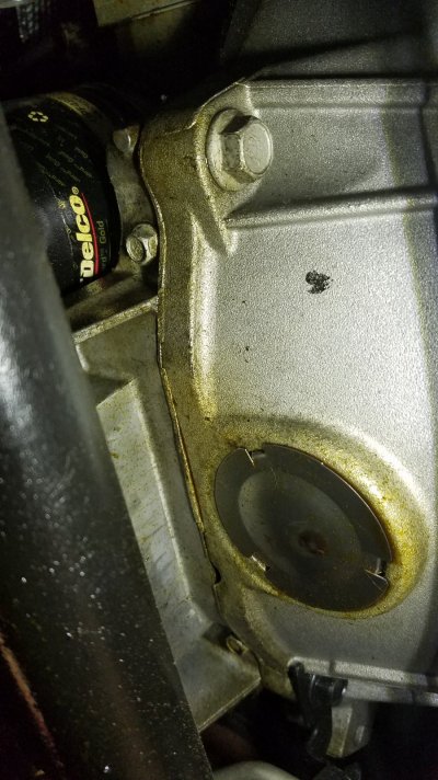

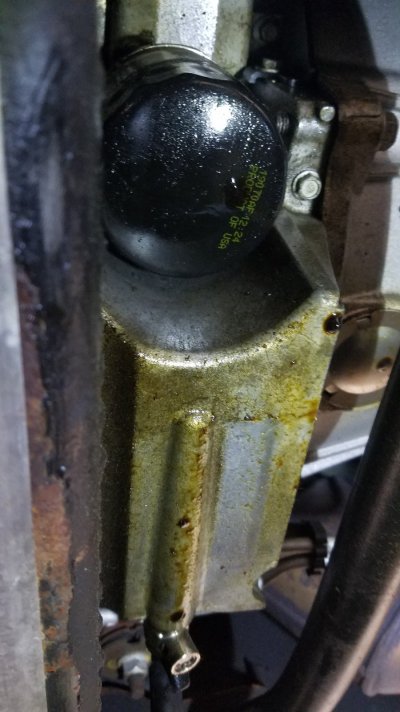

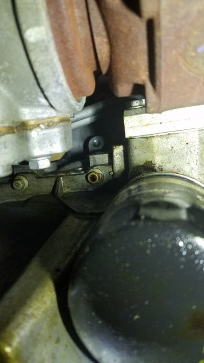

I'm noticing oil on bottom of pan near drain, on sway bar, and oil filter. Last oil change there was nothing. It was also the first time I used an ACDelco UPF48R filter instead of Mobil 1. Maybe I didn't tighten filter enough. I included some pics. Gonna wipe it all off and check it in a week or two. 20210629_153730.jpg
I noticed I could get to it with a long screwdriver through that hole in the plastic cover. I had to stick the screwdriver between the fuel rail and fuel hose. After getting grey plug up, I used screw driver to push in on the black tab then used my other hand to reach around to the plug and pull it offView attachment 343396
The classic reach-around works again!

Interesting that the oil pan bolt above the filter is ready to drip.
Yeah, and it's only oily around that lower back half of the pan. I was thinking rear main seal, but I popped the inspection cover, and while the cover had oil around it's edges it was all clean/dry inside.
I then thought that Allen plug on the rear of the oil cooler line block but that's all dry. The bottom and sides of the oil cooler line block where it meets the engine looks fine unless it's seeping from the top which I can't see.
The engine block is clean above the pan on the sides. I forgot to check some of the pan bolts to see if they're tight. Maybe I'll do that this weekend when I rotate the tires.
Everything else on that side looks clean going forward, but there is a little gunk on the oil cooler lines where they transition from hard to rubber. I've heard those crimps don't hold well, but I don't think any oil leaking from that far forward would leave the mess I have in those pics

you might check above the oil filter where the oil cooler line adapter is those are known to leak sometimes, check your valve covers, front of the oil pan where the timing cover is.
get a bottle of purple power and spray it all over under the engine and clean it with a pressure washer then check it every morning to see where the leak is, if it is dripping on the ground then put some clean cardboard under the engine area and look at it in the morning.

Classic filter leak eithr loose or too tight
I'm hoping that's what it is. The last time I changed the oil was the first time I used one of those ACDelco filters and I always just hand tight.
When I was replacing the motor mount about a month ago I noticed a bit of oil around the filter area and the filter was still able to be turned/tightened by hand. When I just now removed the filter it was super tight.
