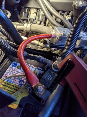

Been having a ongoing problem with my amp cutting off, thought the remote was bad, thought the amp was bad, thought the ground was bad, nope mf been loose for a minute I guess, it would work but then cut off when there was a good draw, wire must have finally just fell out and was sitting on the positive connection. Fml just ordered a new amp today also, fixed the wire and everything works perfectly again

That’s why I also solder those big crimp connectors. I don’t trust them.

ya it was fine before, kind of funny it was staring me right in the face I had my meter on the negative post and the other end shoved inside the fuse connector and watched it drop to like 4 volt's and I looked down and see the wire just sitting on the battery post, lol **** face-palm.
