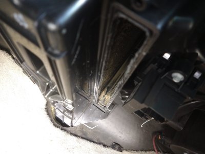

Been putting it off. Looked at it yesterday. Seems like a PITA.
The right tool is a real powered hot knife. I used a combination of dremel, spaded drill bits, and utility knife w/ blow torch.
far from perfect, but i still have a little material left that i might have to file down a bit more.

I broke two utility knife blades. It was naaaaasty up there too. Jammed a rag up there with a screw driver a few times, but I am hoping to look into disinfecting the system with a product or with steam...we'll see.

Mine was actually surprisingly clean.
I did stick my shop vac crevice tool up there since I was using it to vacuum the carpet of the plastic bits
