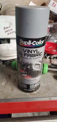

What are you painting with? Damn scope creep... I have some of my interior plastics out might as well paint them right?

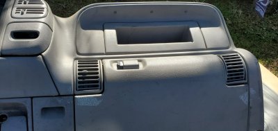

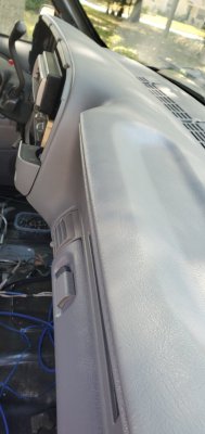

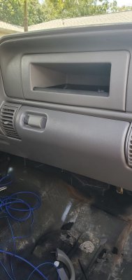

Used this. You can get it at Advanced or wherever. Scrub with water, wipe down with mineral spirits. Light even coats. Viola!

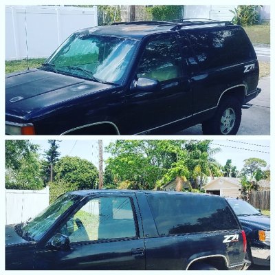

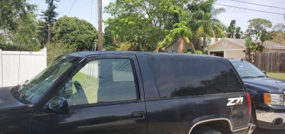

Roof rack delete. Wasn't expecting to but the bolts wouldn't come out and water was getting in because it had loosened up. Just got my headliner done. I think Tim really enjoyed swinging that 3 lb hammer at it to get it off. He drilled out the top of the bolts and it would not come lose. When all else fails, swing something heavy. Thankfully no rain for the next four days. Put some flex seal tape on it and gonna find a body shop to weld the holes closed.

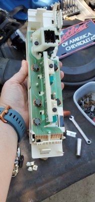

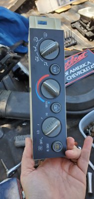

It's a/c day...again. I got my visors from the interior shop. Cannot wait to put them in! They look gorgeous. Guess we found more of?? That Tennessee mud!!! I swear I need to just go soak this thing in a freshwater creek. Still fighting a leak, gonna try to remove and reinstall the weatherstripping on the rear cargo doors and see if we can get that resolved. Next step....well I need new exhaust. So I think we are going to do some shorty headers and flowmasters. Still have it exit right behind my tires. The fab shop and interior shop gave me thumbs up on the progress so far. And shout out @NoReverseYukon /USER] for hooking me up with a damn near brand new ac dash controller.
