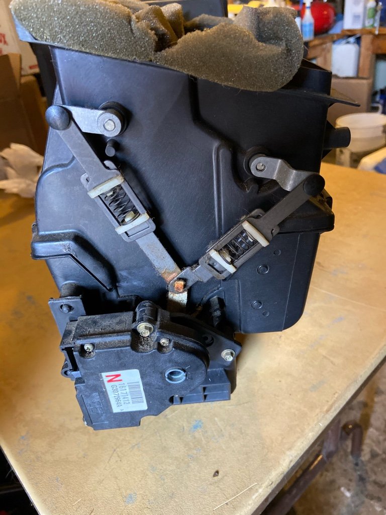

I’ll toss out a suggestion in case you run into this.
The box containing the three dampers (defrost, panel and floor vent) has two that are pressed into brackets that connect to the actuator motor. Your dampers are likely rotted at the edges and the foam on the top of the box is probably shot as well.
Getting those dampers pressed off of the linkage is difficult even with the box sitting on a bench. Mine broke at the plastic, requiring either careful gluing or just replacing the box. I just bought a new box - it’s GM part number 52467204 and available on amazon for around $70. It includes the dampers already installed. The third damper that routes air to the floor just drops in and is easily replaced. I’d replace that as well and put some new foam on the top of the box.
Separating the top of the box without pulling it from the vehicle may be a challenge since there are several screws that are against the firewall. It fits together like a clamshell. I haven’t tried to do it without pulling it, but pulling it requires a coolant drain down and opening the a/c lines.
It can snowball if you pull it - the evaporator line loves to rust and seize where it connects to the accumulator and there isn’t a lot of room to work to begin with. In my case, I was replacing the entire a/c system so it didn’t matter, but it’s something to keep in mind.

I changed all three blend doors same situation the rubber edges disintegrated can be done without disconnecting a/c lines east302 is correct on blend door housing on one side is clam shelled by hvac box what you need to do is remove center console on floor to let dash hinge down far enough to access milk crate to sit on all the work is in the center take out all screws on inside of black box and carefully wedge it apart it won’t give a lot but enough to do so I used wooden wedges you will notice blend door housing has a lip under black box once you wedge apart should be able to carefully pry top out and blend door housing should come out take photos where blend door linkages go can be confusing on reassembly all three doors are inexpensive on Amazon now for the hard part putting it back together blend door housing splits in half four clips slide bottom half in get your doors and linkages in order then work top half back in its like surgery take your time you can do it remove wedges replace screws three out of four clips go in real easy fourth one not so much but I got it my a/c works well I didn’t want to disconnect it

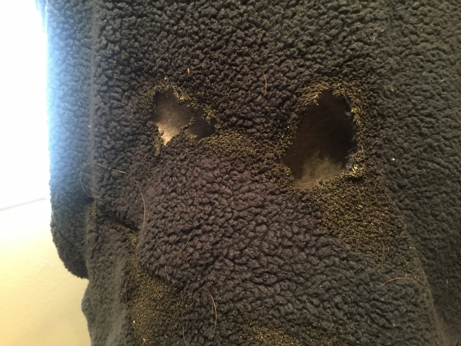

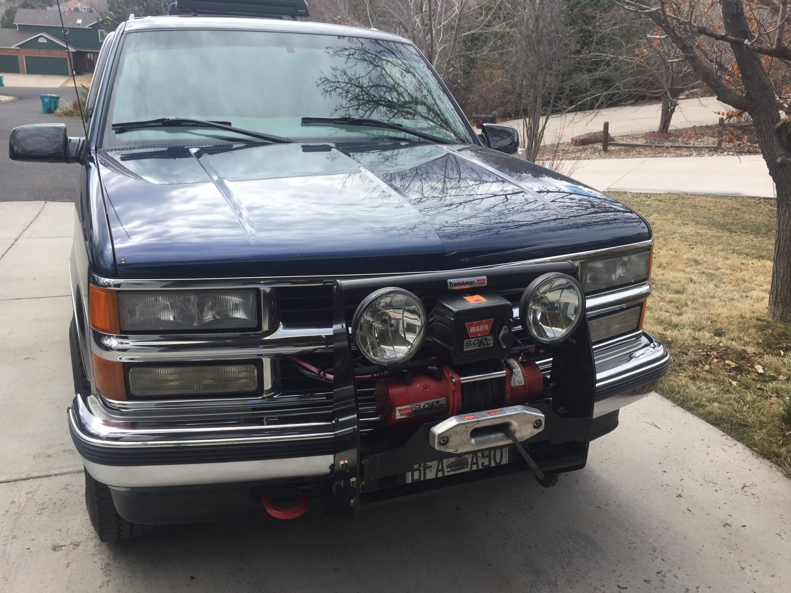

I installed a Warn RC 9000 winch, some Hella 7" driving lights and a Warn Transformer Series pushbar on the front of my 2-door Tahoe. I had the winch and lights sitting around from a previous Jeep build, so that part was free. I wired the lights into my hi-beam circuit and the visibility is amazing. The Warn pushbar was definitely not cheap, but it is incredibly well-designed, relatively easy to install and is incredibly robust compared to a lot of other light duty pushbars out there. Only bad part....caught myself on fire doing it. Note to self: don't wear polar fleece while welding.

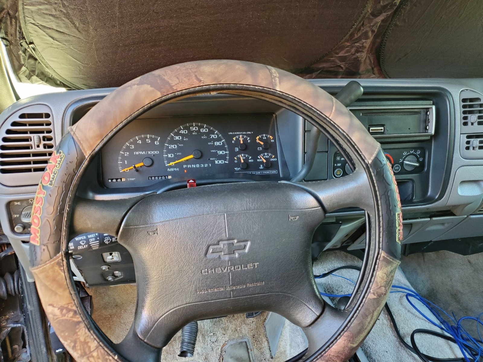

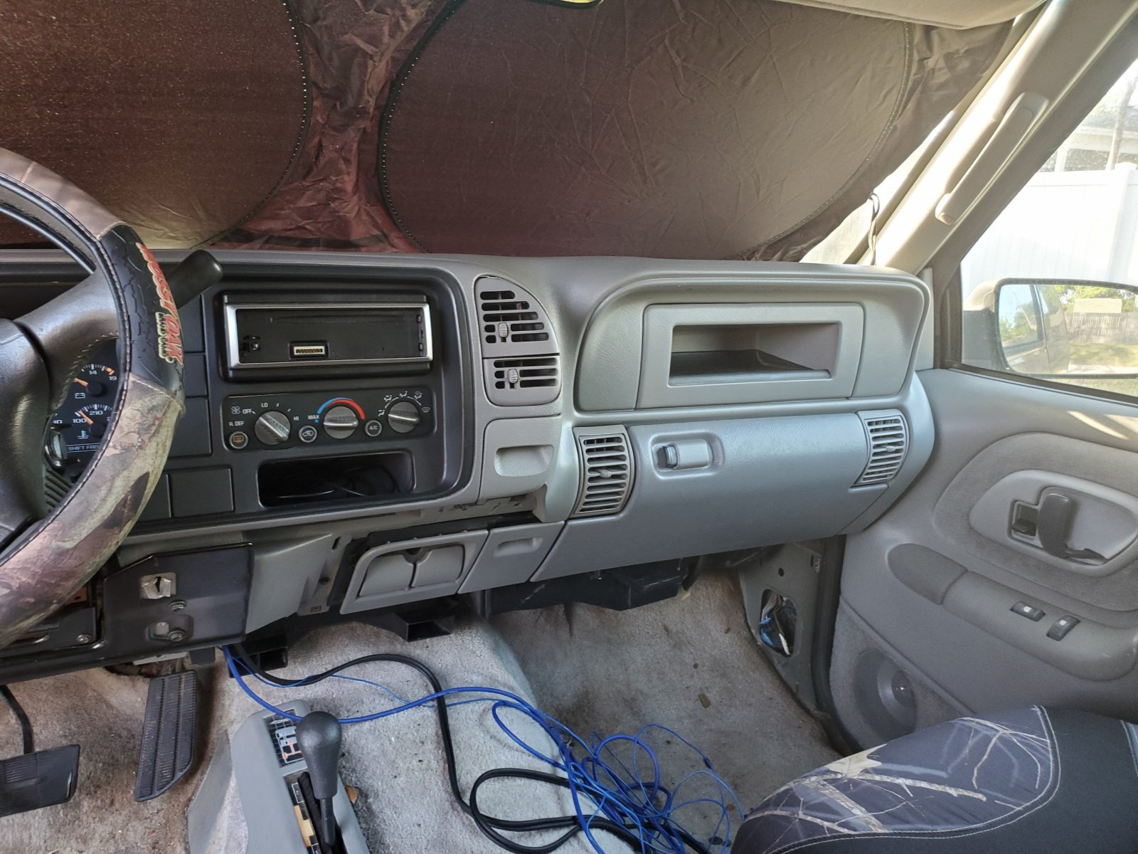

The Q Logics wouldn't work. But Tim found out the 6.5" MB Quarts will go in my doors and the tweeters. Hood release cable installed, the blend doors are fixed, dash is in and all pretty. The mirror is on the passenger side. Next weekend Tim and my son are swapping out my driver door and the fenders, running my power cables for the amps and subs, getting my steering column back together (steering column shift mechanism broke), I'll even have a nice boot on my gear shifter. I'll be mobile again on the 23rd so it better be ready to go! I've driven her once in the past 6 weeks. But the good news is I had my back surgery yesterday and I'm already up and walking around! And no more shingles.
20200311_162055.jpg 20200311_162051.jpg Resized_20200304_172415.jpeg Resized_20200304_172405.jpeg
View attachment 242257 View attachment 242258 View attachment 242259 View attachment 242260
Great news about the surgery! Take care of yourself. Thanks for sharing progress and pictures!
