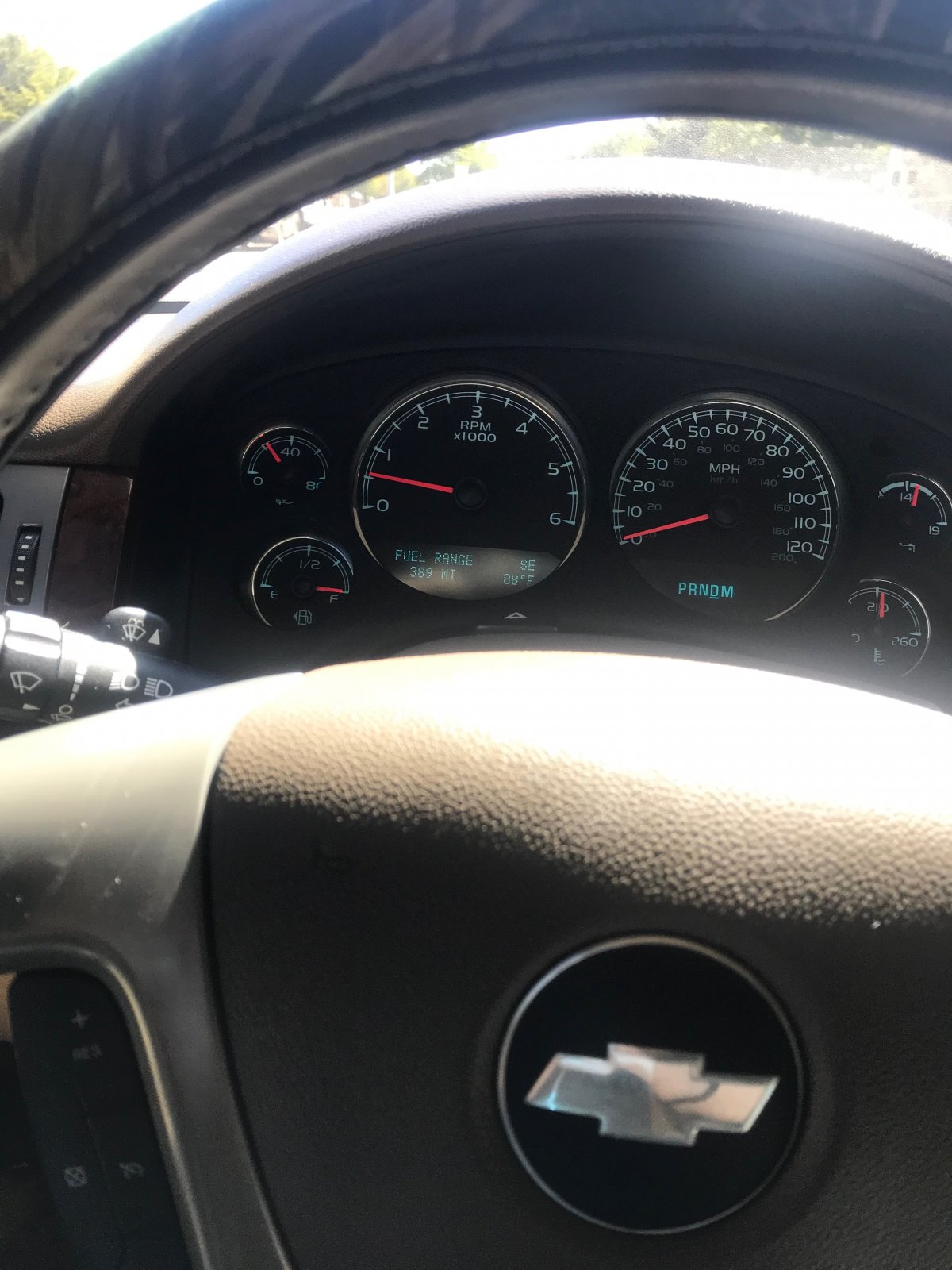

so i filmed a video of acceleration, constant gas, and took a photo at a red light is my oil pressure normal? I just got my oil changed I have 100,000 miles on it its a 2013 5.3 videos wouldn't load but idle was between the 20 and 40 mark around 30-35 and when i get on it it can go past 40. this pic was from the stop light. Also my tahoe has afm/dod turned off.

it is normal for the oil pressure to fluctuate on these trucks, but it shouldn't be going down to low enough to set a oil light, you can load videos to youtube and then put the link in here.

Sounds normal to me. LMG engine, right?

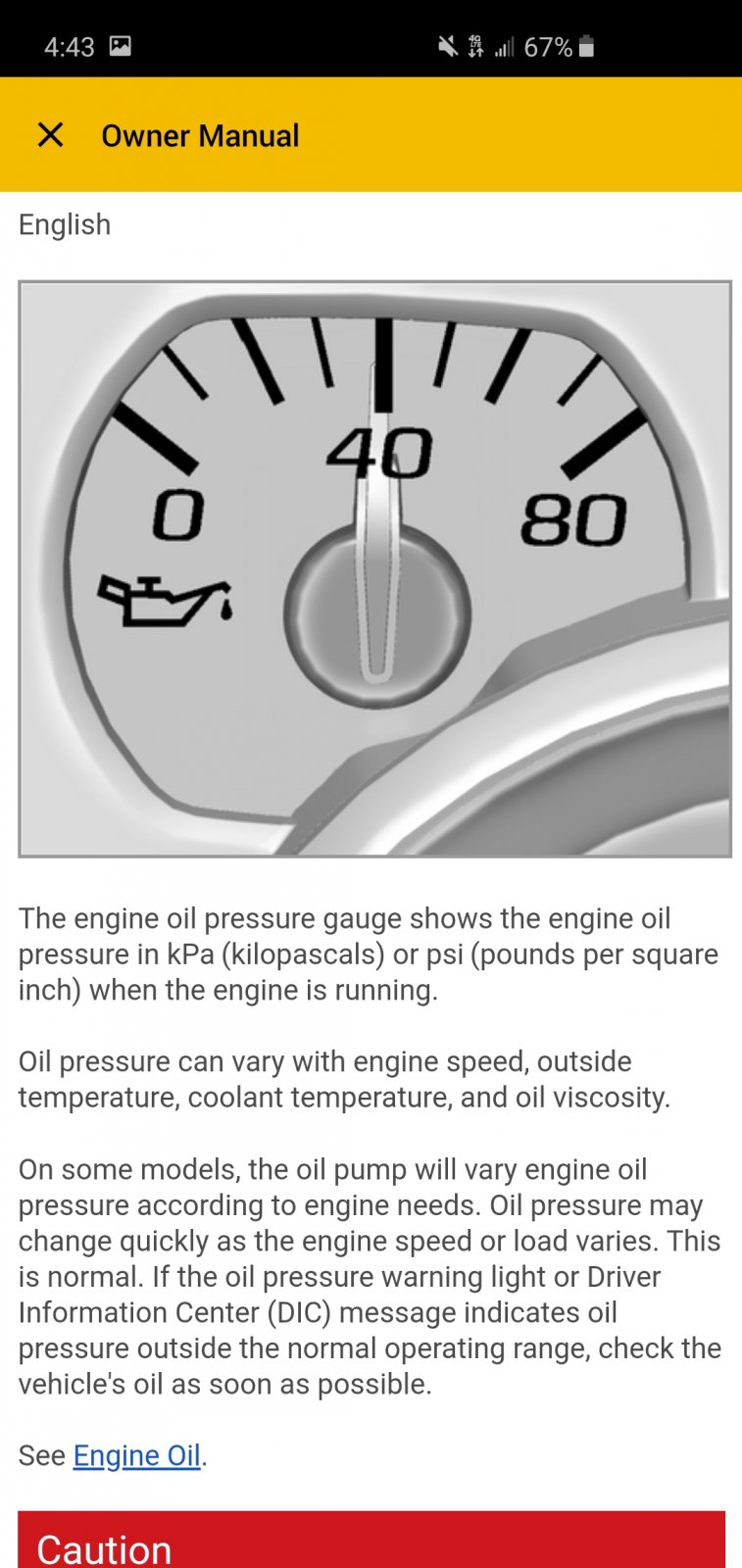

I just picked up a 2019 tahoe and was just looking this up in the owners manual! My other vehicles the oil pressure gauge stays constant but this tahoe had me all worried as the needle would move up and down depending on if I am stopped or accelerating. Per my manual it states it is normal.

Your engine has a variable displacement oil pump, pretty cool tech that is worth looking up and learning about.

It is an LMG i found it in the glovebox
21,296
30,248
cool so if it is LMG which it probably is then the oil pressure i described and sent in that pic are normal?
Yes, once hot, after driving a while, it will drop into the 20s on the gauge at idle or stopped at a light. I forget exactly but the bypass spring on the LMG is somewhere in the 40s.
