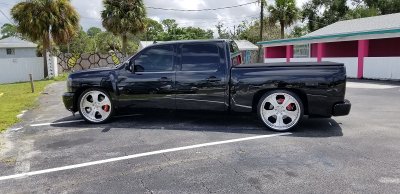

Finally a couple pictures of it bagged. Running Kelderman front bags on shocks up front with Belltech 2" drop spindles. Rear is the KP 4 link cantilever with watts link and mini notch.
It's sits on front fenders with another inch or so it could go. Sits on the rear fenders with almost 3 inches it could go. Not sure how much more I want to cut up at the moment. It sits pretty level with it on the fenders and it's going to be a lot of work to go more. The drive shaft is hitting the rear cross member, the bed will have to be cut up, and a new c notch installed to lay frame. Honestly not too hard.bad. But in the front I'd have to cut up the fenders and relocate everything only to be able to go down another inch with the setup I have. So it would lay out level like it does now. I'd have to change the whole front setup to lay frame. So for now, I'll leave it as is...
52,954
It looks great. And yes it is a surprising amount of work to get to the next step, to lay frame. Like you said, the rear isn’t that bad but the front is. Plus even harder to lay frame on 26’s or 28’s. Now you can imagine how much more work it is after that in order to lay rocker on 28’s like mine is set up for. It’s crazy. The more I look at these the more I want to do one myself but at the same time I’m glad I bought my first one already done. Yours really looks nice the way you have it right now, I’d be tempted to leave it. Like you said you’d have to redo pretty much everything. I like it.
