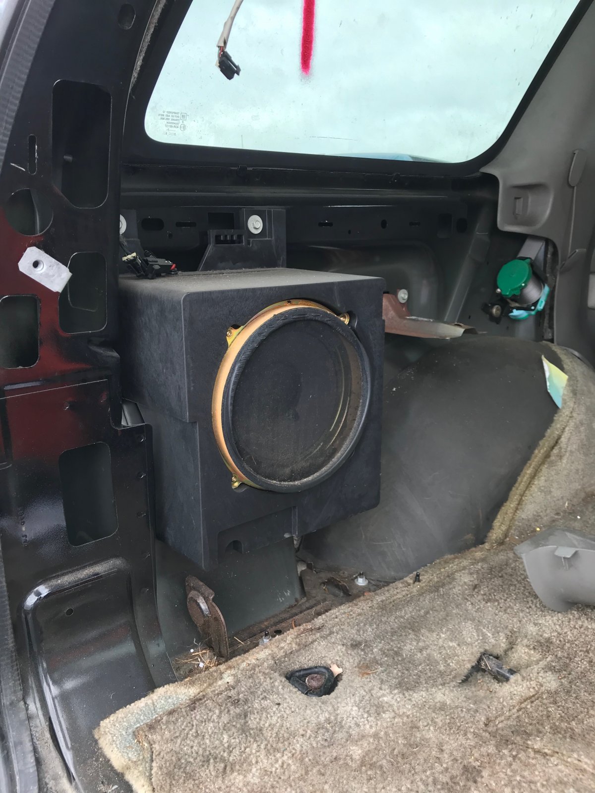

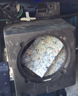

This is the 00-02 box in the back. For the short bodies ONLY!. You cannot utilize the long body box and have it fit perfectly due to the wheel well. Relocated the jack to under the 2nd row or in the engine bay in the 2nd battery tray. Both have been done on here.

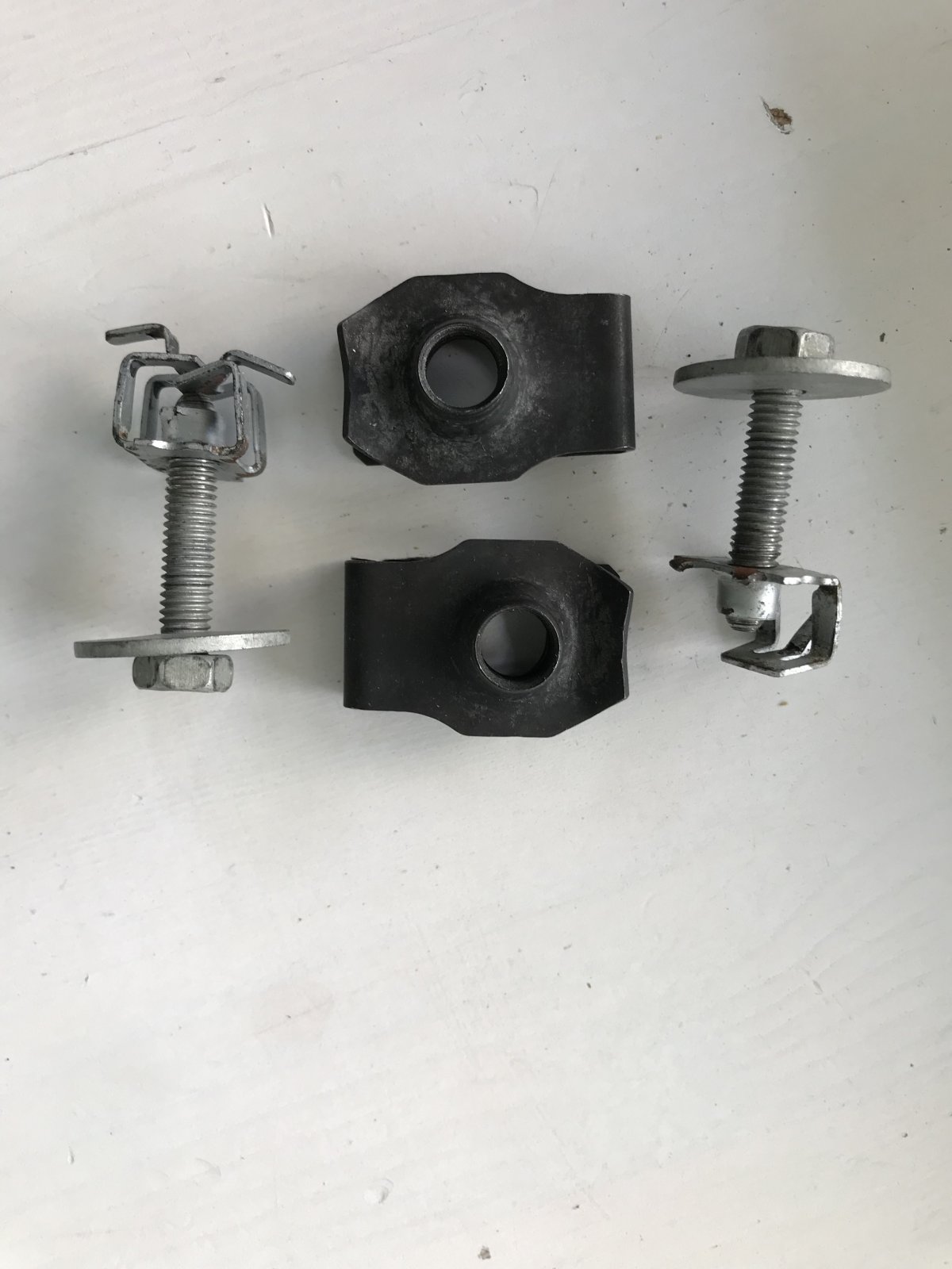

I don’t have a picture but they are those threaded style clips GM uses so the bolt threads right through to hold the box to the body.
I’ll see if I can find a picture.

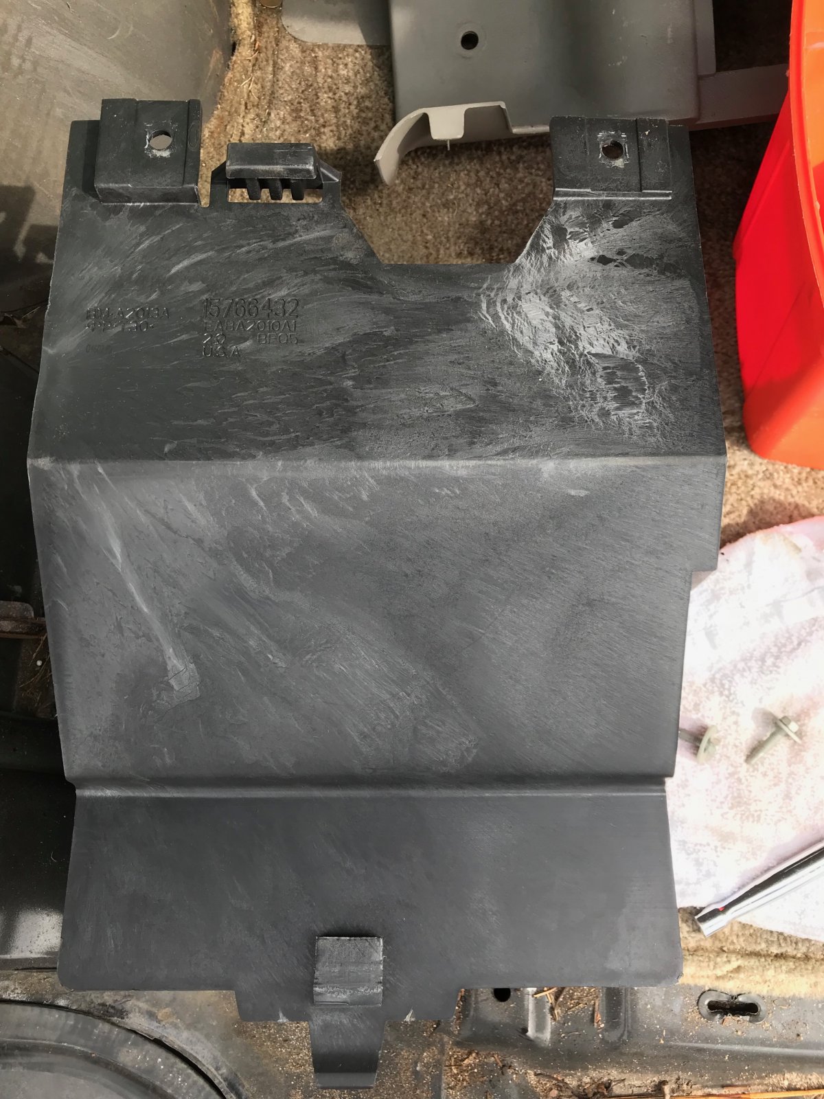

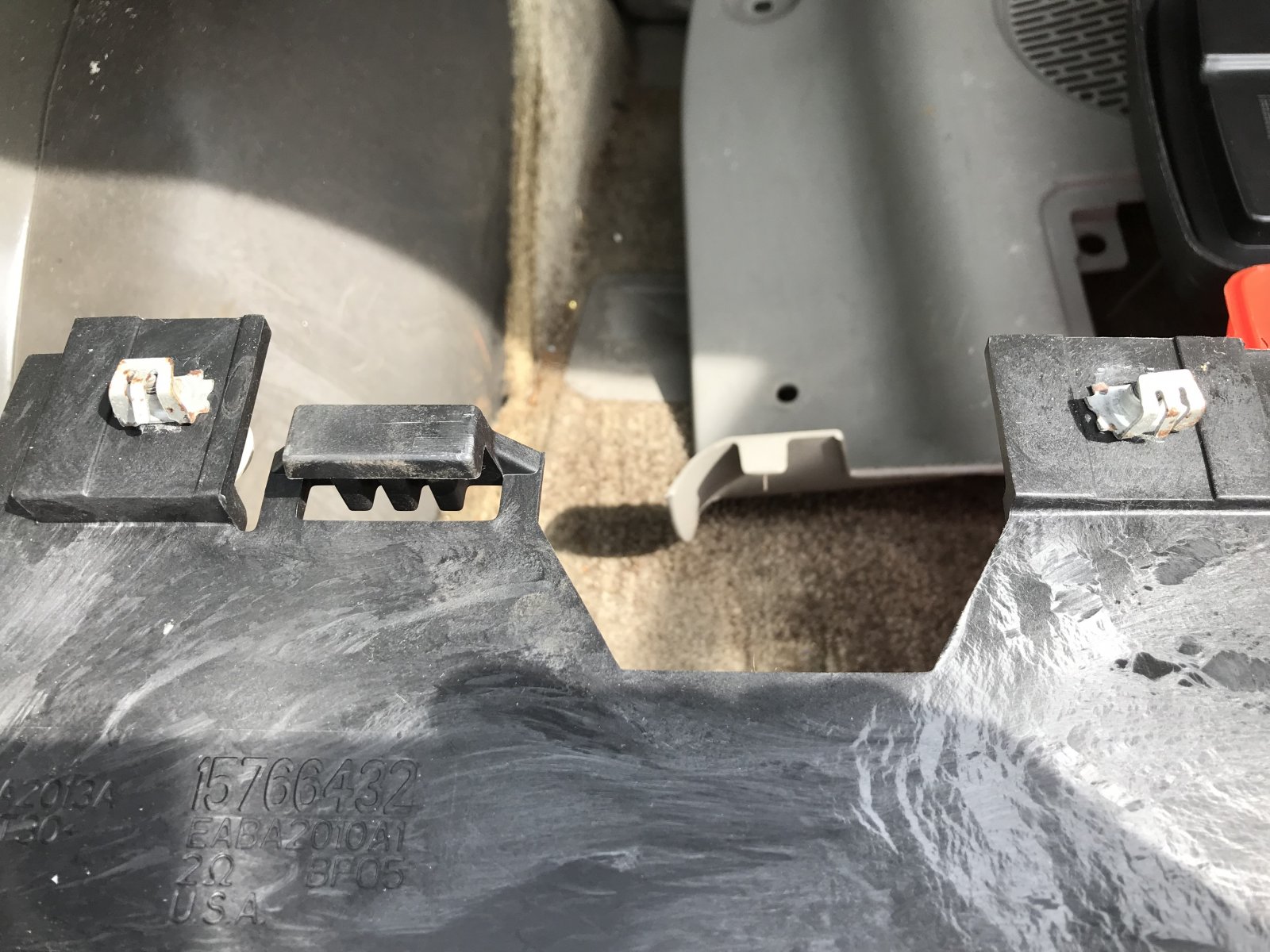

IIRC they are something like this. Clip with threads.
One of the 2 styles. It’s been a while.

Yes kind of. I couldn't make ANY of those type work though. They're more of a square that clips in and is threaded in the middle.

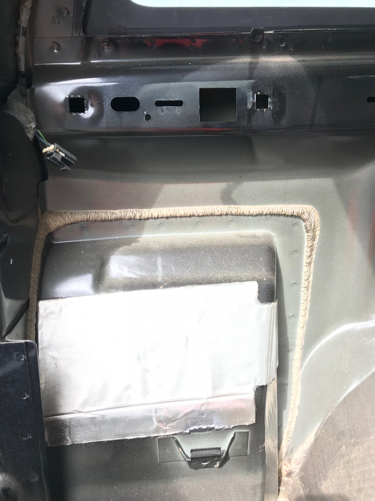

Has to be a shallow mount 8". This is the OEM box below. Those original threads had some great speakers, but a lot have been discontinued. There was a Kicker one that was recommended. Maybe a newer edition would work. I have the box, just never have put a sub in it and missed that Kicker before it went out of production.
Hope this helps a bit more. I can get some tape measurements if you want to see? There might be some dimensions in this original threads as one of the guys did a pretty thorough job of looking at the box and all options.
OEM location.
Threaded bolts that go thru the inner body frame skin. Each bolt had one of the ears break off when pulling it back thru the square holes.
OEM location minus the sub box.

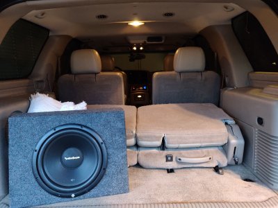

My setup is everything stock except a 12 inch Rockford Fosgate R1S4 300w with standard sealed enclosure and a BOSS Riot 1100w amp. As much as I like the overall sound of my 12, it's too in the open and my current setup takes away space from me and I want to fix it. Plus, the 12, while it has great sound, doesn't have as much volume as I wish. Too quiet and even when I crank things up it still lacks volume for the size of the vehicle. I can be sitting in the middle row and it's fine, but then I can be up front and it just sounds too quiet for me.

My current setup (though I have my woofer over on the right with that seat up and the woofer facing left), the amp is just beyond the left seat on the floor.
