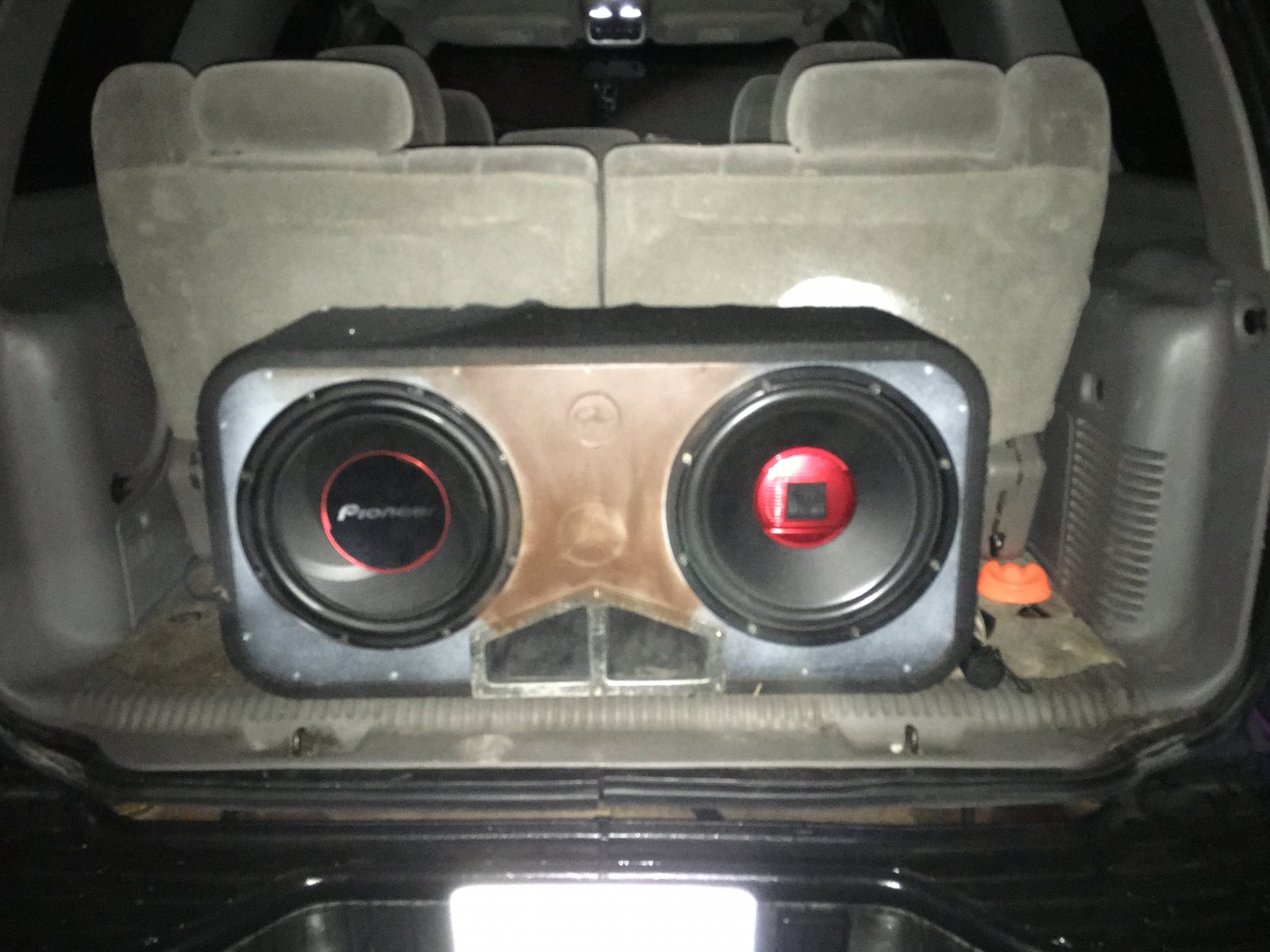

I built a box that fits between the 3rd row and the trunk door, 2”-4” space. I’ve got 2 Pioneer A series 12’s, powered by a Pioneer Gm5602 amplifier that’s mounted under the 2nd row seats. Sounds awesome, and surprisingly the trunk doesn’t have rattle, but you can definitely tell there’s something behind it. I upgraded all my door speakers to Alpine R series, and my tweeters are DB Bullets. I have a Pioneer AVH2900BT that is awesome.
Back to the box/drivers, I started with a wedge box, and recalculated the inner volume once I decided how much(6” off the back), I was going to take off. Box originally was 2.0 cu ft per side, and each driver needed 1.25-1.5cu ft ported space. So after measuring a zillion times and cutting only once, the box ended up being 1.45 cu ft ported for each chamber. Works great! Sounds awesome, and I get compliments here about not only the sound, volume and being able to feel each bass note, I get complimented on the quality.
It’s response is anywhere from 34hz to 64 hz, but I do have the frequency set to stop anything above 63, which is a radio preset that works well.
(The dual was only used while waiting for my second Pioneer to be delivered. Can’t believe they were out of stock... Faceplate will be painted also. All in time!)
