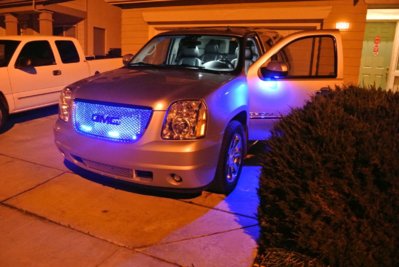

Is that blue on the front legal where you're at?

no those are on courtesy lights only, only come on when the doors are open or when unlocking with the fob or if I turn the interior lights on

Where did you patch into wiring to do the courtesy lights?
at the little black interface box on the drivers side floor just above your left foot, the black cover just pops off and there is a lead there for the dome lights, I patched the puddle lights to that and some led strips under the dash and the ones in the grill. my puddle lights do not light from my aftermarket alarm but my dome lights will so I just patched them all together

hmm, well sombitch learn something new everyday, could have used that feature a time or two, and took picture i'm liking the blue
View attachment 214703 View attachment 214704
Looks good! I wish I could do blue, but since my Yuk is red, no bueno. I considered red LEDs, but don’t think I want that. So white it is.
