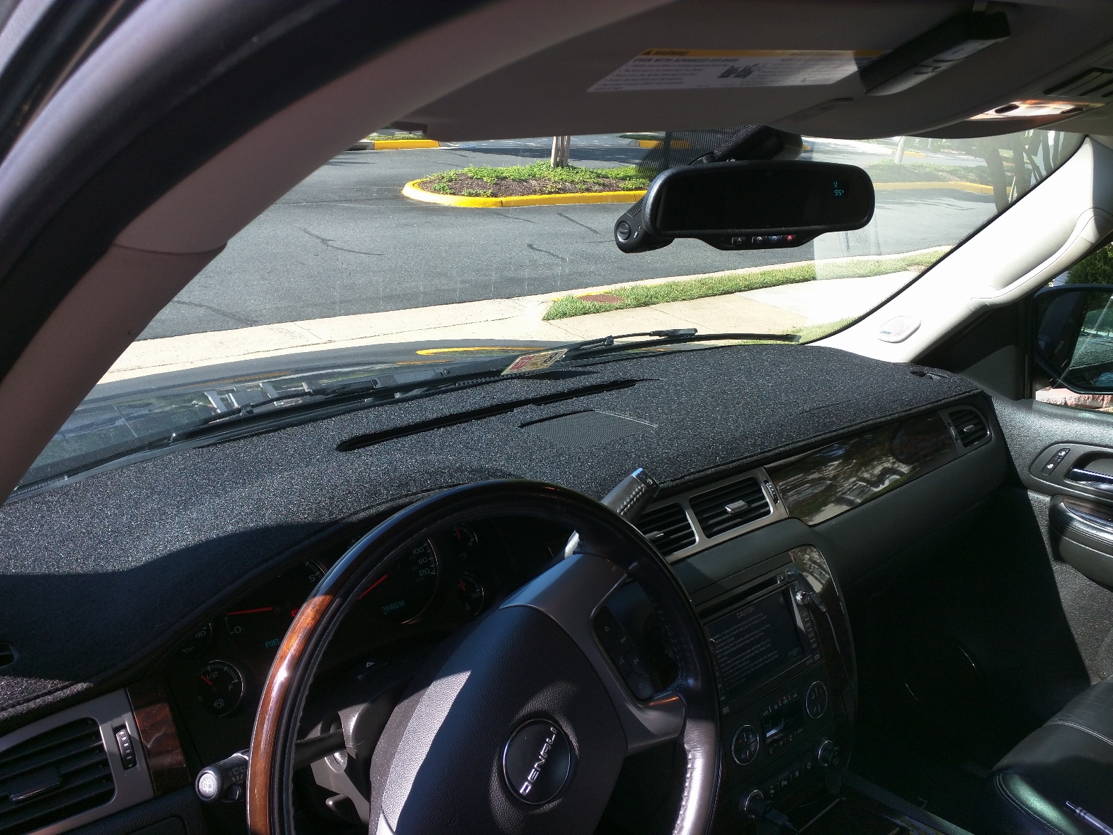

This is how I fixed my cracked dash. Cover the cracks then they dont exist.

Yall are some sensitive flowers. I'd rather not have the cracks, but I would rather spend $$ elsewhere. Plus the cover cuts down on glare. That's what I tell myself.

You covered the cracks but what will cover that ugly dash? :) J/K but everyone has different tastes and some may not like those aftermarket dashes.
Sounds a bit hypocritical that you rather spend $$ elsewhere yet you spent money to 'improve' that look. I rather be perfectly flawed in that area and spend the money completely elsewhere :), as long as the cracks wont be a safety issue which they dont seem to be. Truthfully i'm too broke to spend money on this truck unless its preventative or makes a big improvement.

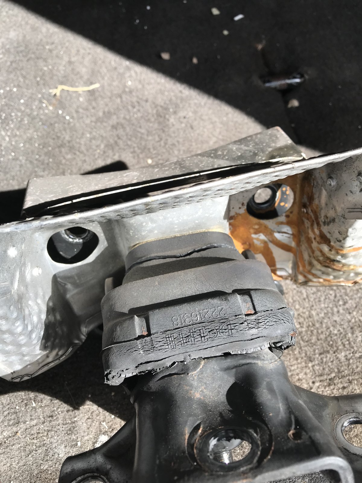

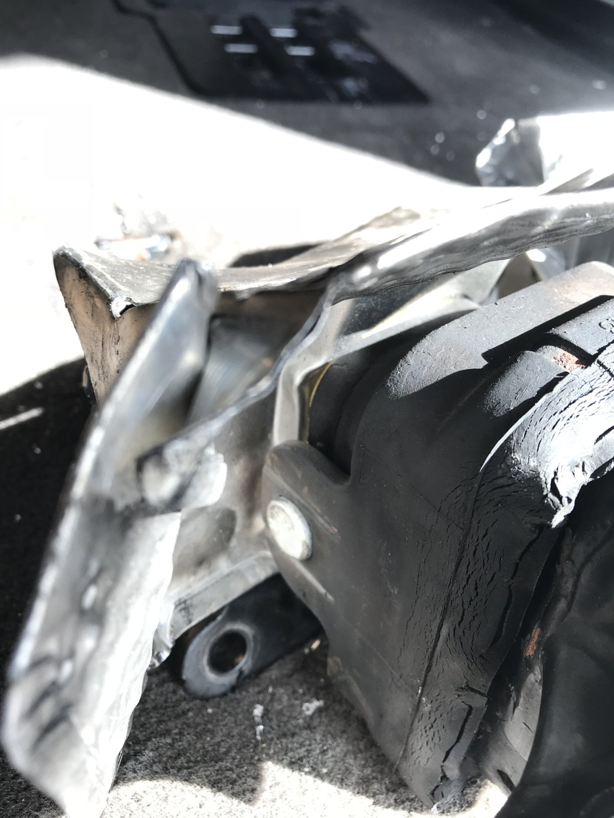

Dropping my truck off Monday morning to my buddy who has a shop to replace both engine mounts with H3 ones and getting a new trans mount as well. We’ll see how it goes. As is I know the drivers side mount is really bad. Hoping it gets rid of the vibration at idle and in drive

I know the drivers side is pretty much gone lol with that said I’m betting the passenger side is pulled apart
Mrsteef
May 28, 2018
81
67

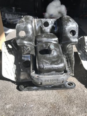

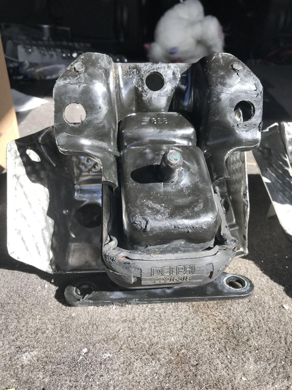

Drivers side

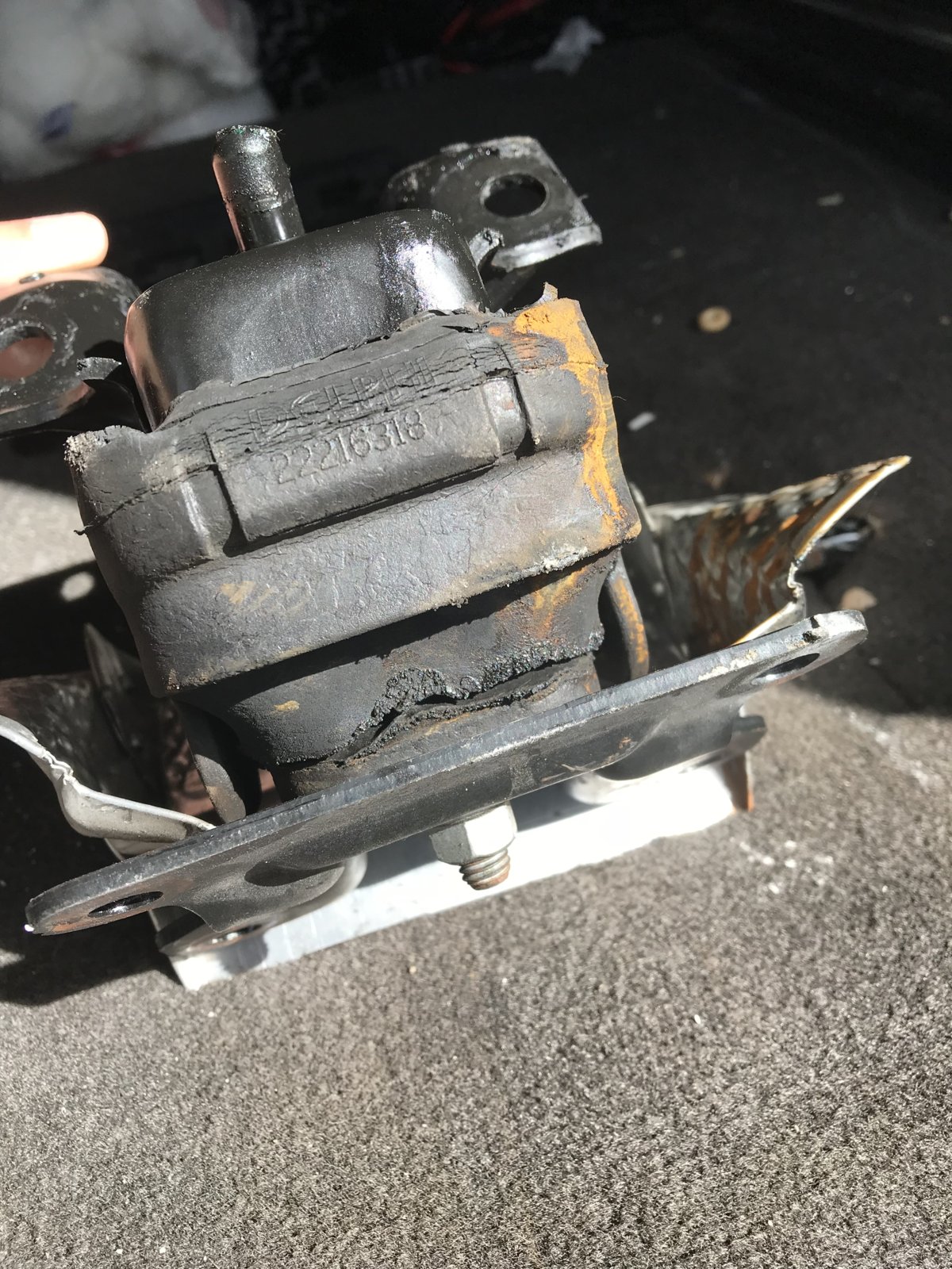

Passenger side
F5CDA536-E178-499F-8001-F34787AA13D7.jpeg 5887B1E9-F360-44E3-BBA5-39D0B92A04BF.jpeg
Also had the trans mount replaced because it was starting to crack as well. H3 passenger side mounts for both sides worked like a charm. Just another vouch!
