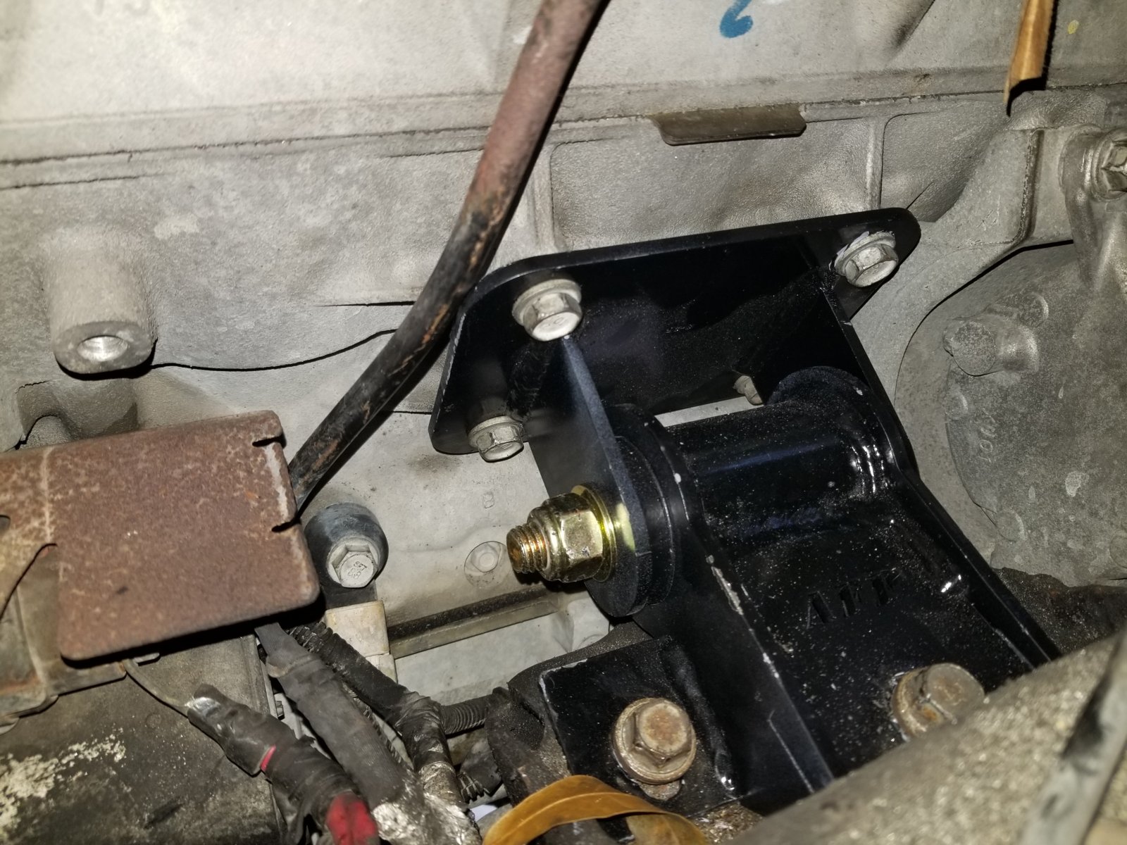

I just got my poly mounts and am eager to install but worried about the vibration.
The drivers side oem mount is the mount I destroy every year or so and have to replace. I'm wondering if I should just install the poly mount on the drivers side and either stay with oem or h2 for the passenger side. Any opinions would be appreciated.

Generally not a good idea to mix and match engine mounts. The polyurethane mount on one side will be too rigid and the engines vibrations will be channeled to the weaker durometer mount. In general the car might 'feel' like shit due to the imbalance.
I've got a Tahoe PPV which comes standard with the H3 mounts and others have them already so why not go with them?

My weak point on the oem mount it the cross bolt that holds the two ends together. Every time I change it this bolt is bent.

One thing I noticed with the h3 mounts is better gas mileage (now with new h3 mounts vs broken factory mounts). I’m not sure I would want to go with poly mounts after getting used to the slight vibrations I feel with the h3’s. If it were me I’d either go full poly or full h3. Half and half to me is kinda pointless. Quick side note also it’s alot easier to change them from underneath the truck (2wd) if possible. Passenger side just remove the starter and it’ll pretty much fall out.

They seemed to lower the engine quite a bit...went from headers tight on top to rubbing on bottom after putting them on.

Strange. I saw no height difference. It's hard to guage when stock mounts can be so ******.
Still, great install. I was amazed when I could floor it and nothing rubbed or moved

I just drove my Denali with the h3 mounts. No more vibration than with bad oem mounts.

I think it could've stayed. It wasn't torn, but the rubber was obviously aged and had some cracks in it. Compared to the new one, it was almost an inch shorter. Either the new one will settle a lot or the old one had squashed that much over time. For the additional $20 and 20 minutes of labor, I'd rather have ALL the powertrain mounts be fresh so everything is in or closer to it's originally designed location. Considering I'll be lowering it, having the tailshaft at it's intended height and angle can help with driveshaft, U-joint and pinion angles which will be more important when lowered.

Uhhh, your mechanic is over selling what needs to be done. I did mine with diff in, engine slightly jacked up, manifolds removed on my back in my garage.
Hell, I bet I could do it with manifolds in but taking the starter out for the passenger side.

Can you folks help me out a bit? I'm working my way backward through this thread, and it looks like 25847739 is the PN for the H3 engine mounts. Are their other mounts that I should swap (tranny, etc) at the same time? If so, are their H3 version that work there as well, or should I go with original?

The H3 mounts are for the engine only. There’s nothing wrong with the design of the original trans mounts and they rarely if ever fail however if you like there’s nothing wrong with replacing it too.

That is the correct part number. It's the RH (passenger) side mount for an H3. You'll need two of them as that mount will fit both sides of our trucks. The trans tailshaft mount is the only other powertrain mount. As Mark said, it rarely fails but it certainly won't hurt to replace it. I wanted all my mounting points to be fresh and the trans mount was only $20 and took about 20 minutes to change. My original one had cracks in it but wasn't separating. There's really no lateral movement in that area to separate it, it really should just squash over time as it ages and settles. I'm sure all the extra movement from my blown engine mounts torqued on the trans mount to cause the rubber to split.
