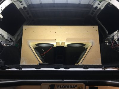

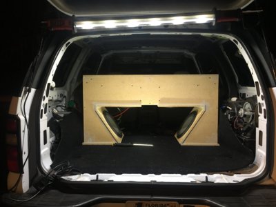

Here’s a custom box I built for my hoe. In the process off wrapping it now. Houses 4 12’s
