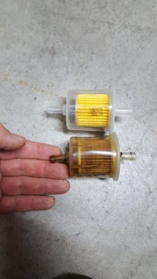

After cleaning the head ports again I also replaced the screen inside the catch can. I also installed an inline fuel filter on the vent line right at the intake manifold. I made sure I had a clear filter so I can see if oil starts to seep up the vent line again. I guess time will tell it this works.
View attachment 182514 View attachment 182515
Update
It's been appx 4000 miles since I installed the fuel filter and the results are in. The oil is still seeping up the hose to the intake manifold (see pics). The good thing is that the gas filter did its job, it kept the oil from going thru into the intake manifold. It's time to try a new oil catch can, I'm going to order the RacerX catchcan and see how that one does.
http://racerxfabrication.com/catch-can
View attachment 191757 View attachment 191758

I guess I could throw some relevant info in here as well. I stuffed a stainless scrubber pad in my catch can two oil changes ago (10,000 miles) and I've gotten a small, but noticeable amount more in the drain cup than before. So, that must've increased it's air scrubbing efficiency some. I wanna get a fuel filter now.

I've heard of people using those. I don't think it looks bad at all and I like the idea of being able to see what's collected. If that works just as well or better, then I'd run one. I'd still use one of those fuel filters after the catch can like Ivan did for the extra filtration and to see what's passing the catch can.

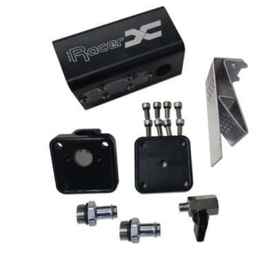

Several weeks ago I bought the racer x fabrication oil catchcan and this past weekend I installed it, I hope this catchcan does its job. I will post and update later on the year since my Yukon is not a daily driver, it will take several months to rack up some miles.
View attachment 194293 View attachment 194294
Looks like a nice piece. Def different.

do they recommend mounting it that low ? most are above valve cover level
