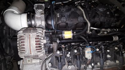

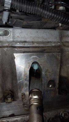

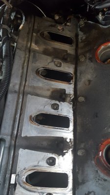

After cleaning the head ports again I also replaced the screen inside the catch can. I also installed an inline fuel filter on the vent line right at the intake manifold. I made sure I had a clear filter so I can see if oil starts to seep up the vent line again. I guess time will tell it this works.

I have the same catch can. I didn't think they were anywhere near 100% effective, but I'd hope for less buildup than that.
No chance on that being deposits from the fuel? I'm doubting this as I type it because it looks like the ports are clean on the walls and it's just the floor that's gunked up. But, I can't tell for sure from the pics. I'm looking forward to what you find with the fuel filter.

I don't think is gasoline gunk because I noticed oil on the intake manifold. When I cleaned the ports the first time I also cleaned the intake manifold. I'm going to monitor the clear fuel filter it and post any findings in the next few months

I wasn't doubting you! I was more like trying to be optimistic, giving the benefit of the doubt from what I couldn't ascertain from the pics. I'm sorry to learn that these things aren't nearly as effective as we had thought. But, at least they're doing something. I recall seeing in a thread of someone running two catch cans in series, but I don't know if they ever reported of their efficiency.
