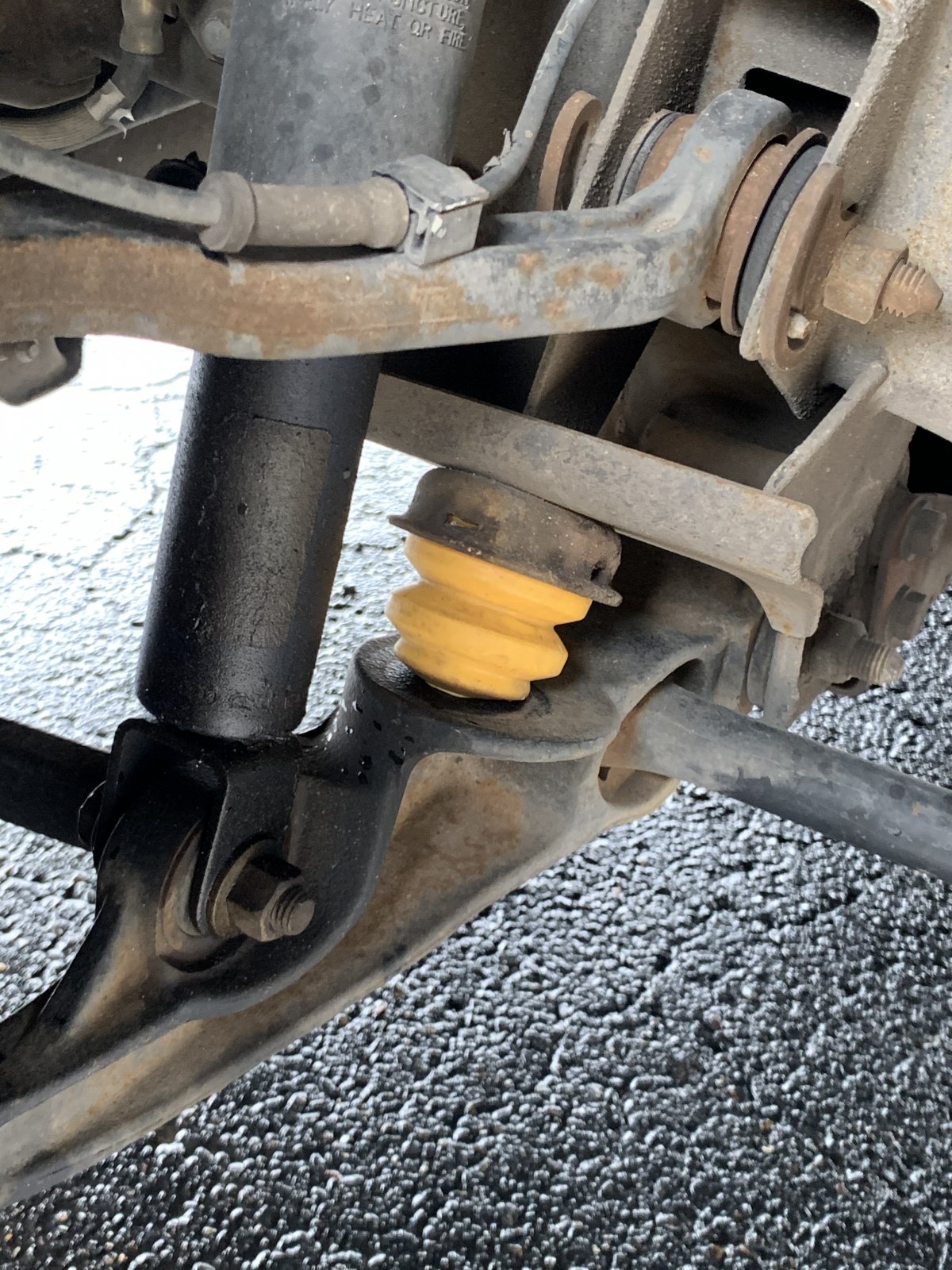

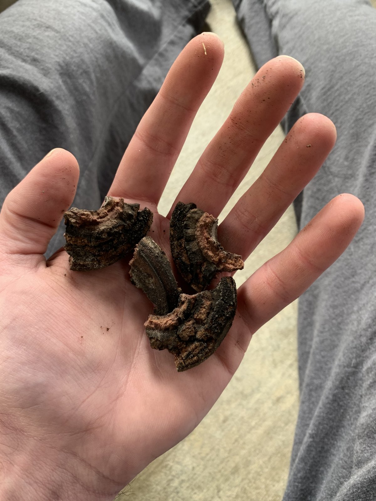

This is just a PSA for anyone who hasn’t checked on their suspension in a while. The first pic is what was left of my front LCA bump stops when I got the truck. The rears were just completely gone.

That front should feel better now, those jounce stops are important.
It would, except the shocks are wore slap out and I’m sure the rest of the front suspension and steering needs to be rebuilt. The first weekend I had it I went through and greased everything that I could and what grease came out that was in some parts was blacker than black and a few boots even spit water out at me.

When I rebuild the front end at some point this year I’m going to get the triangular ones that I had on my 3/4 ton of I can figure out how to mount them.

Are those beefier? I'd assume so. Mine lasted 4-5 years.
From what I remember they seemed to be. They also don’t squash as easily and supposedly have a bit different way of dampening due to their shape. Might be a load of shit but they seemed to do the job well. The factory ones on that truck were falling apart when I got it as well so I don’t have anything to really compare it to.

Cool. Do you have a link? I'd like to check them out. Guessing that they won't fit in the cups tho.

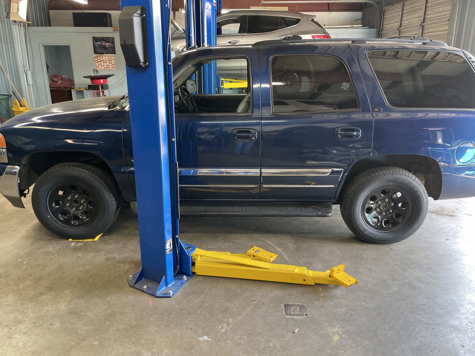

Going to look real nice once I take the time to get the door mouldings and badges off and lower it. Also going to have the center caps powder coated because I think they look dumb in chrome!
