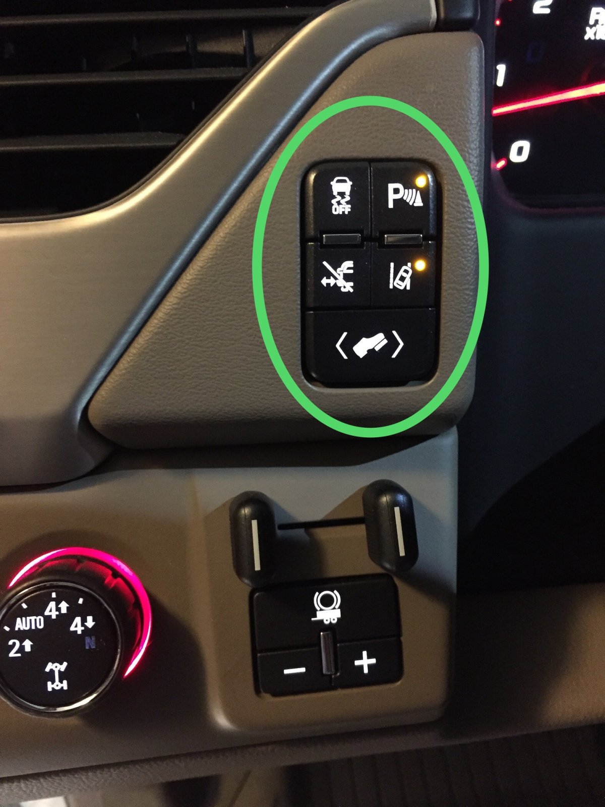

what on off button? a oem button for the steps?

that 2nd row left button is for oem running boards. But mine came without it. I had to switch out that whole button for one with running boards
