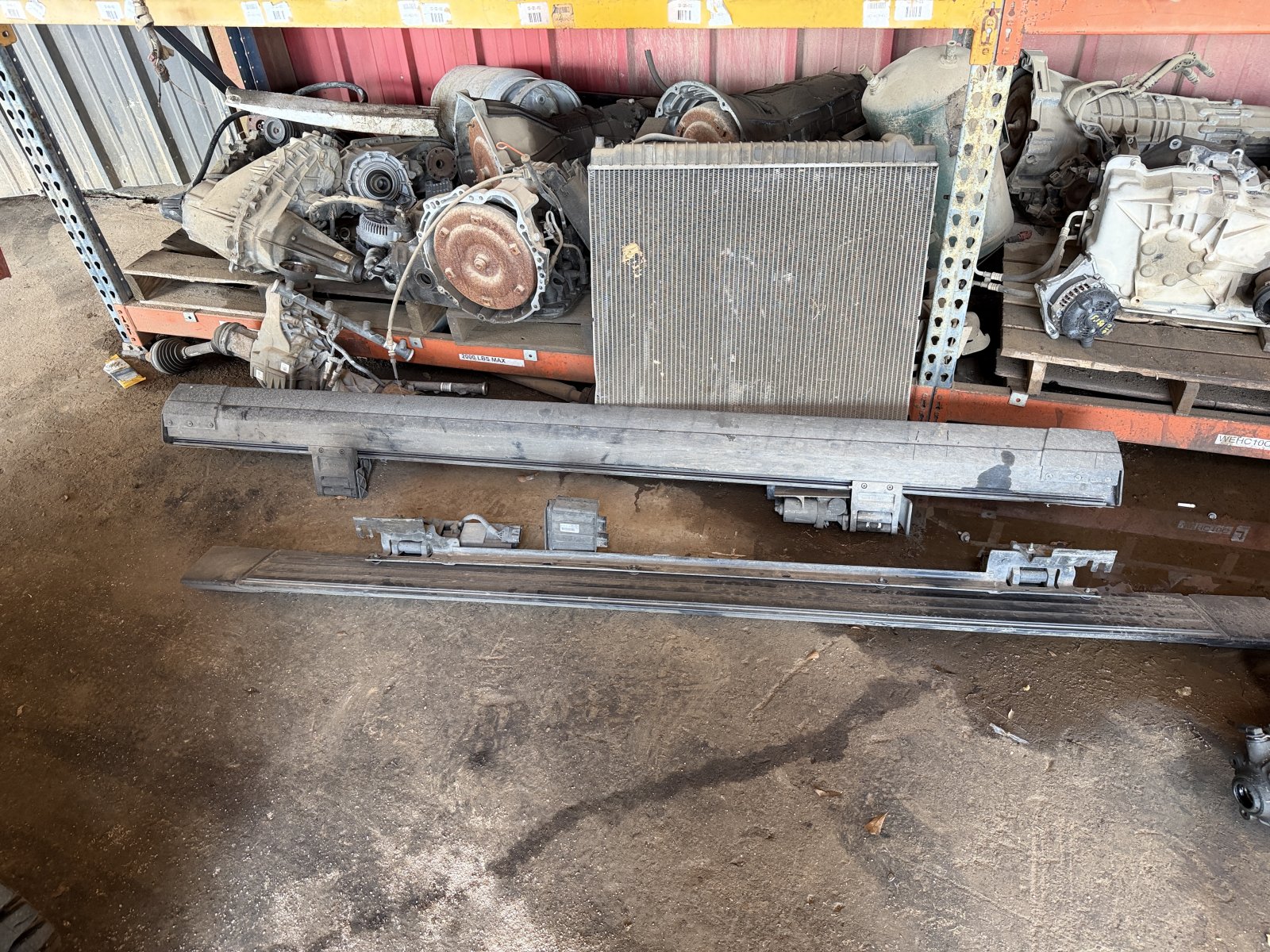

I wanted to put the OEM Power Running Boards on my Suburban. I found a 4 year old YouTube video where a guy installed them on his Tahoe. I prefer the OEM look over the plain flat board that AMP offers. I picked these boards off a 2008 LTZ for a great price.

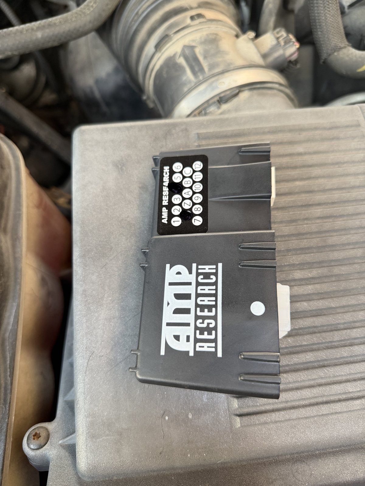

Parts you will need:
AMP Research Wire Harness Part # 19-03348-91L
Amp Research Control Module: 19-04280-STA
I ordered both parts from www.realtruck.com
The wire harness is $150, and the controller module is $99.
There are knock offs of the controller module I’ve seen on EBay for $50. Don’t get it. Spend the extra $50 and get the real deal.

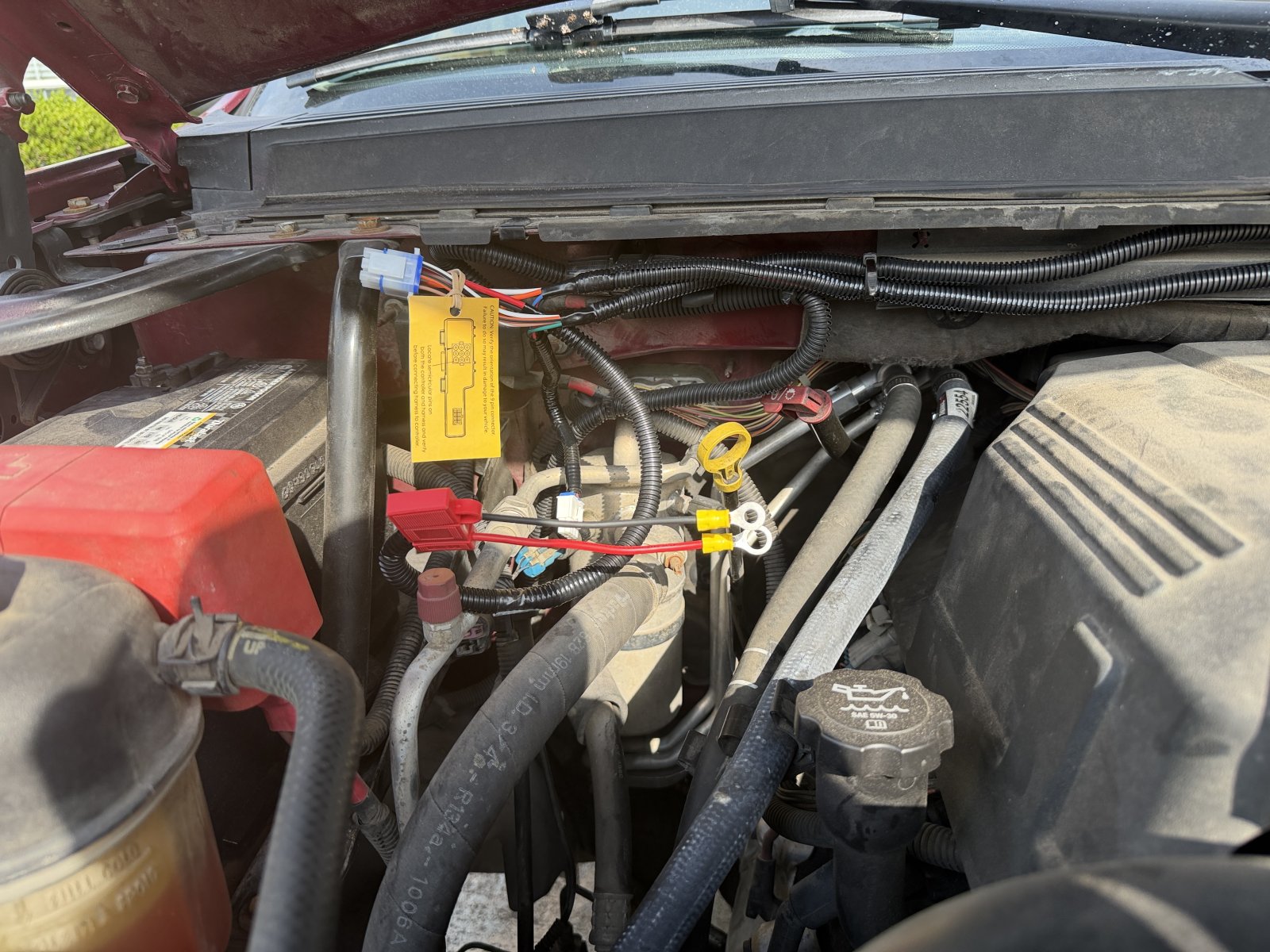

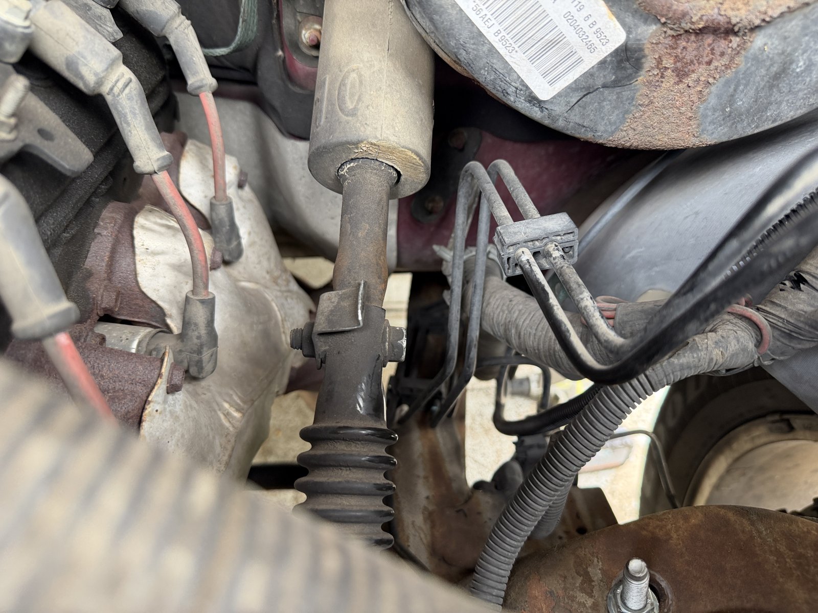

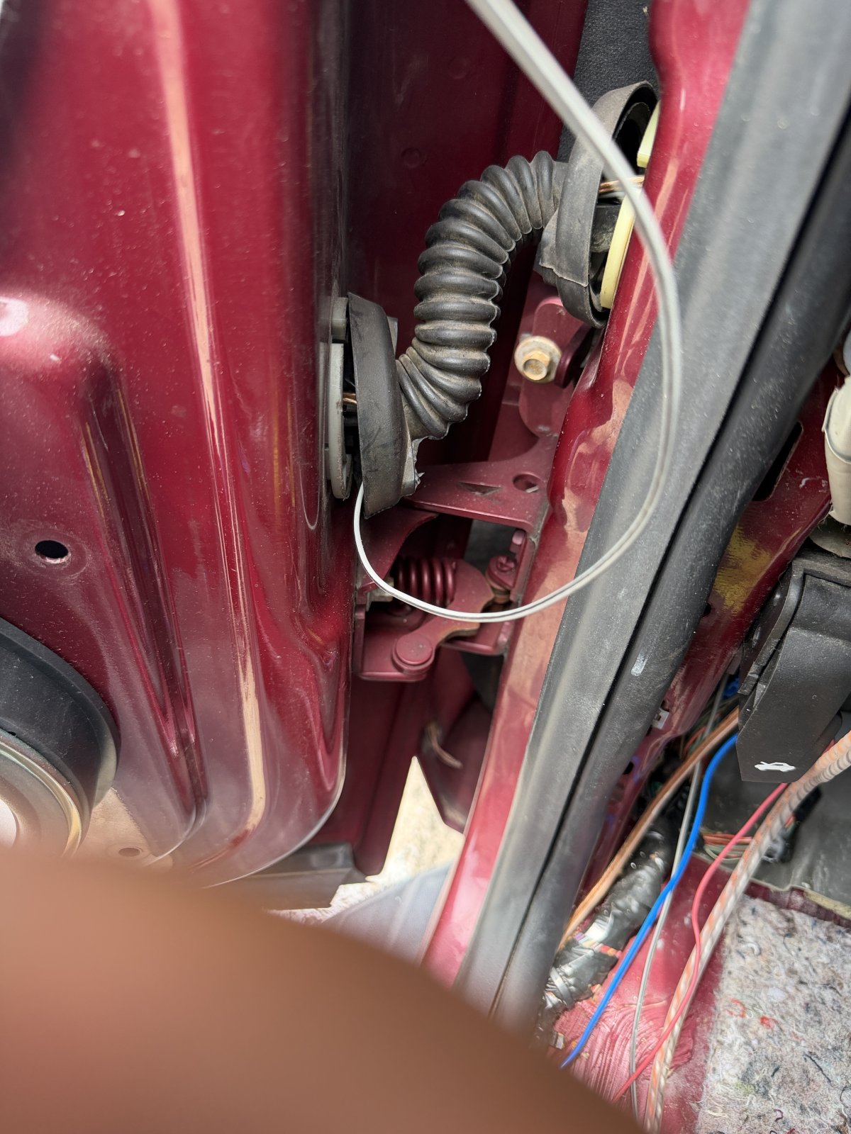

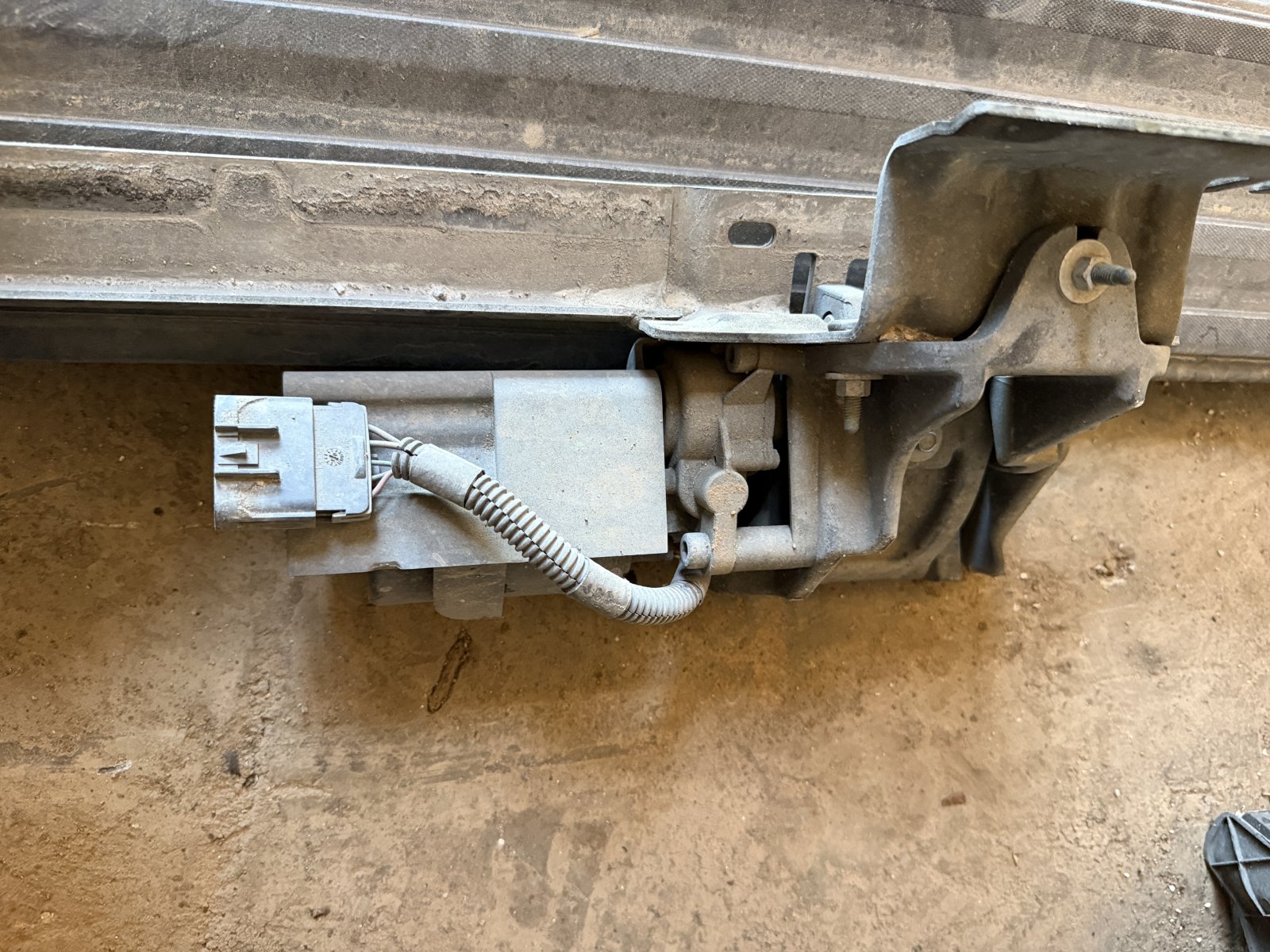

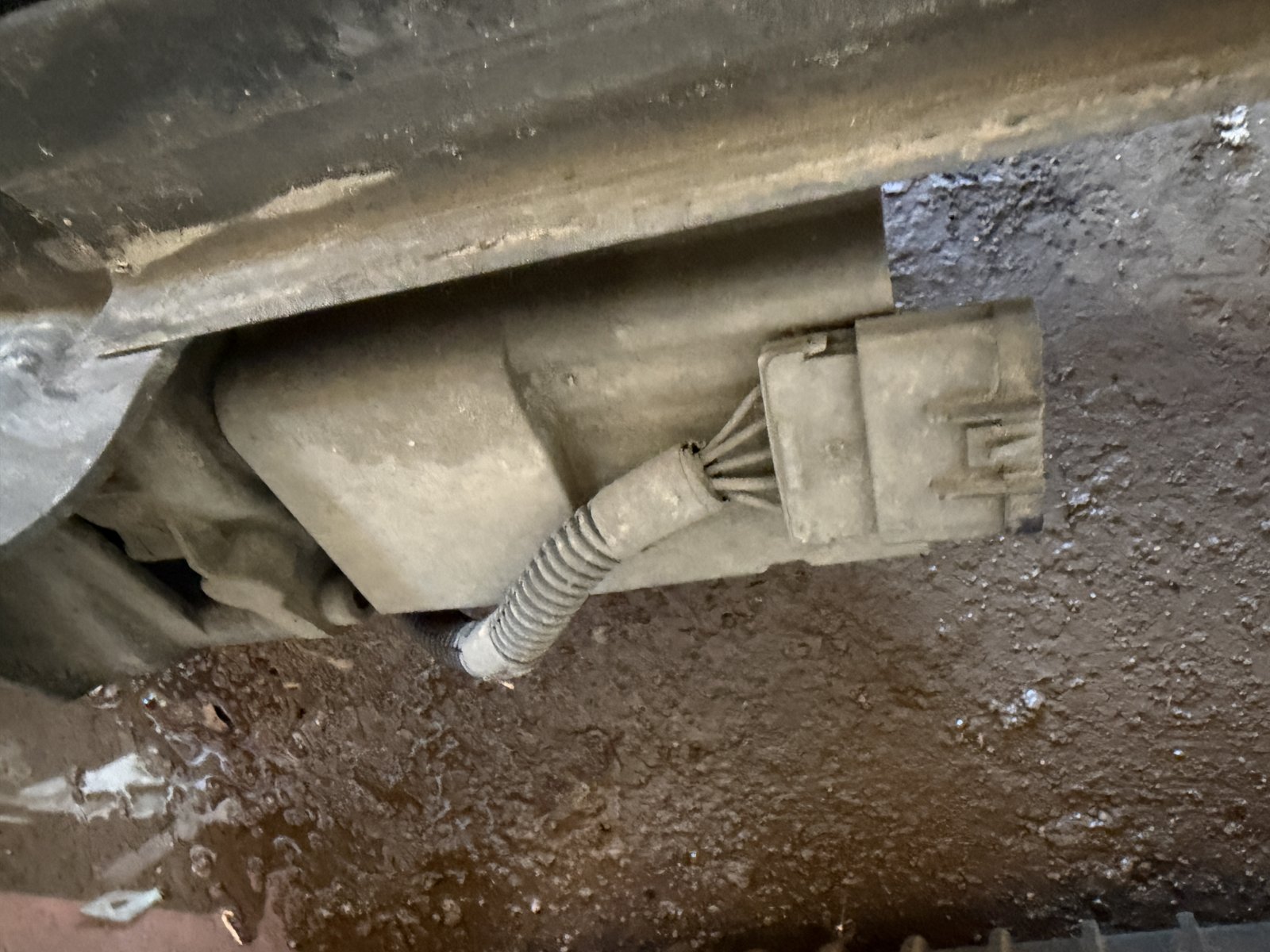

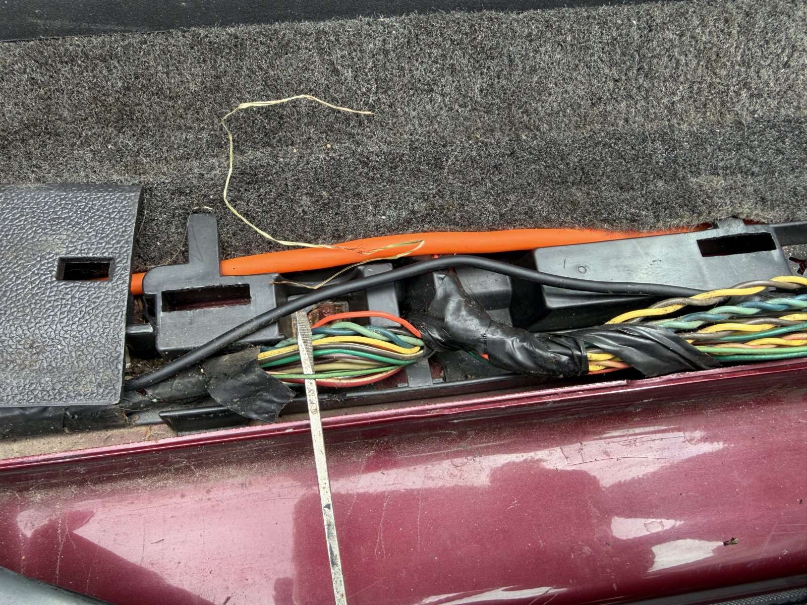

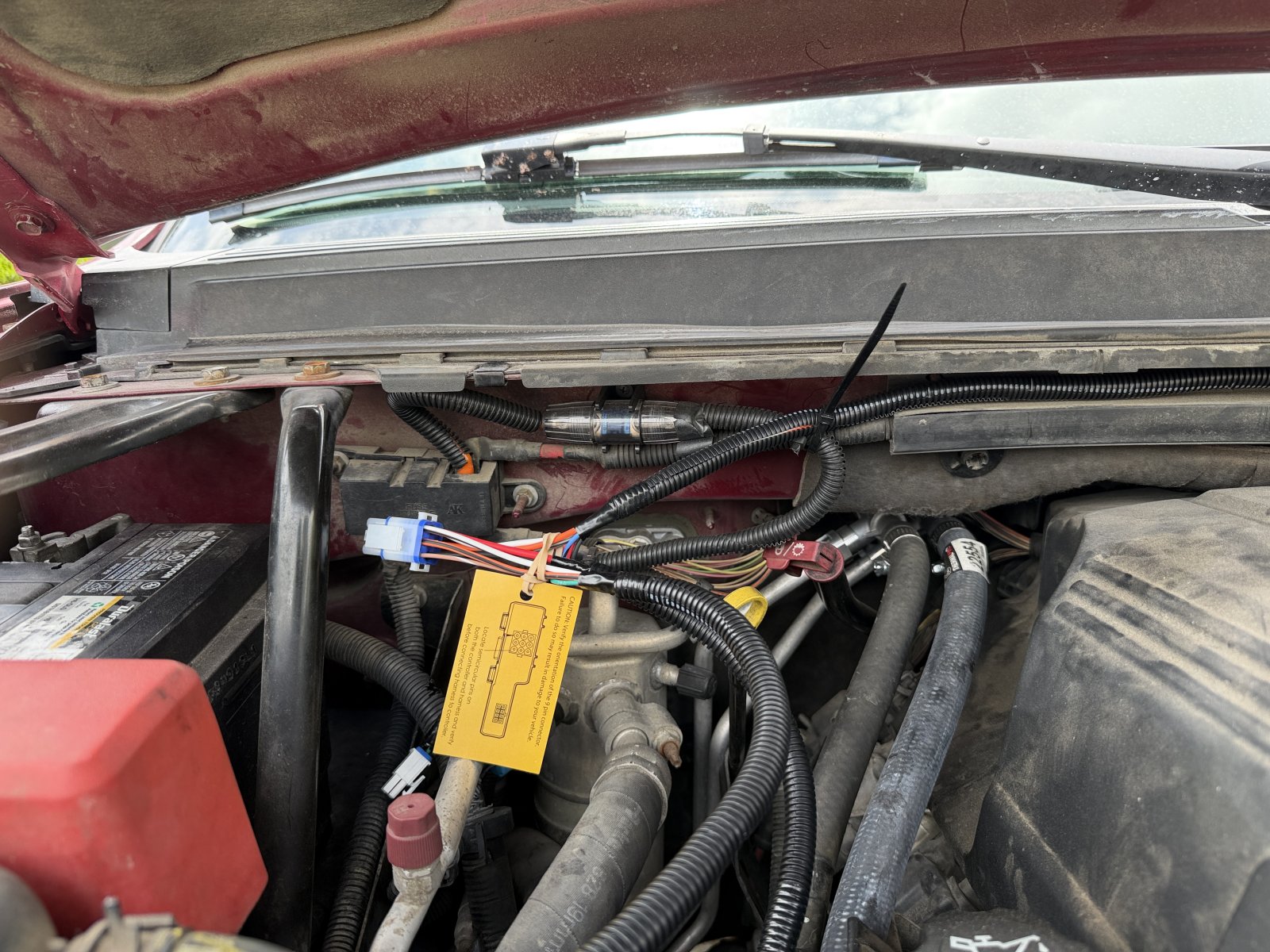

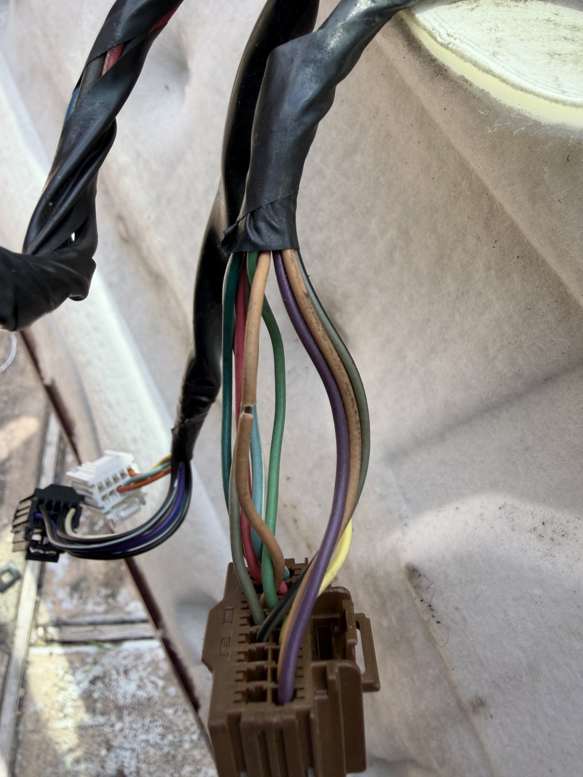

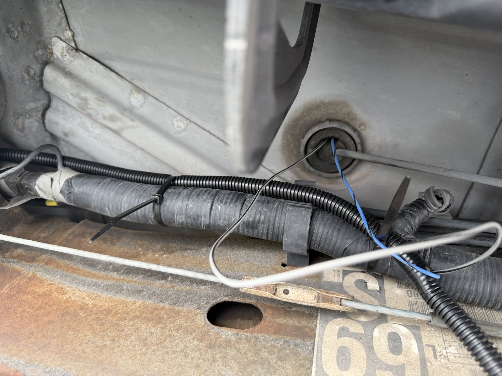

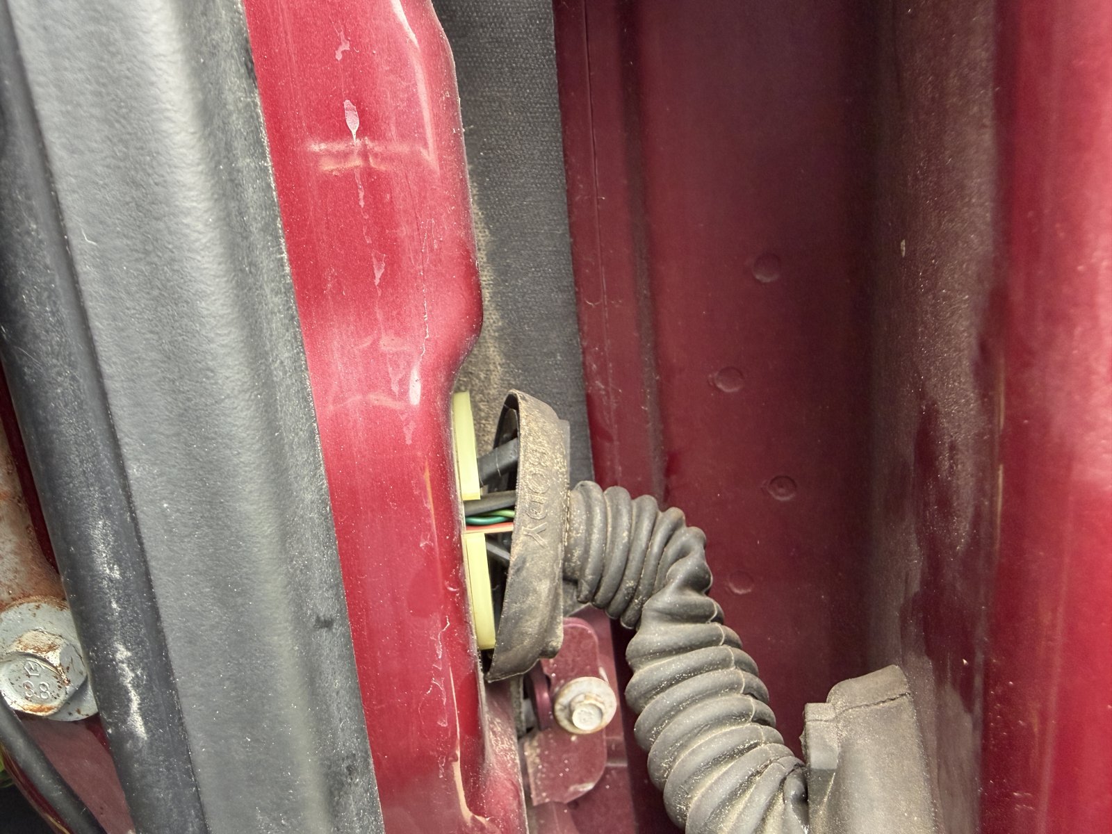

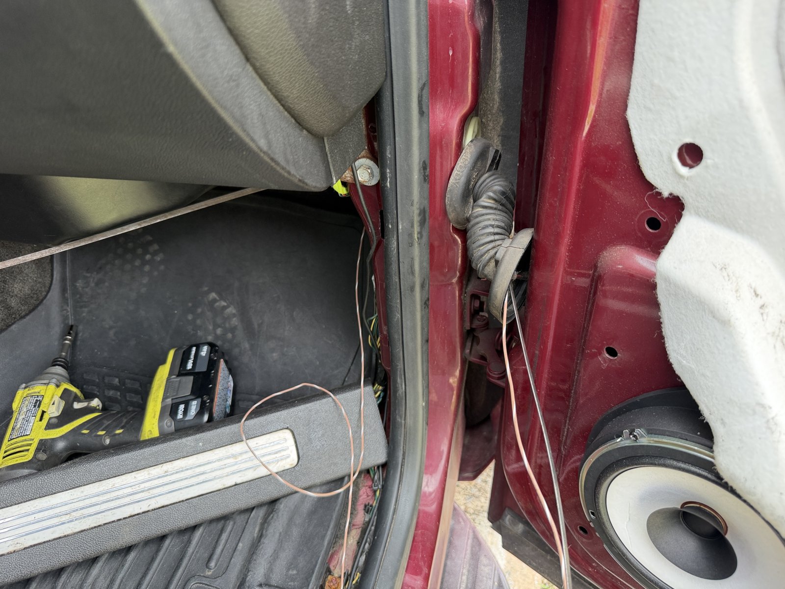

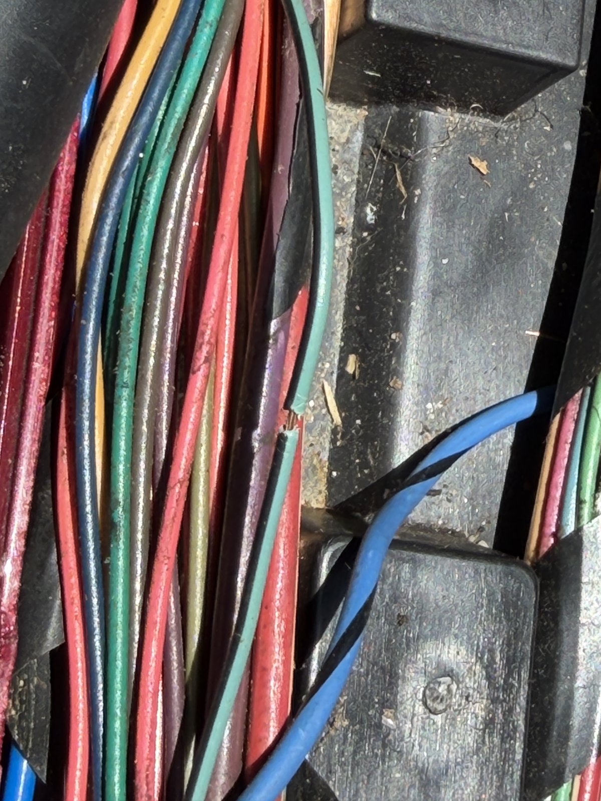

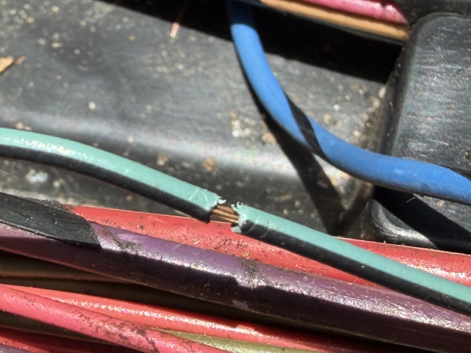

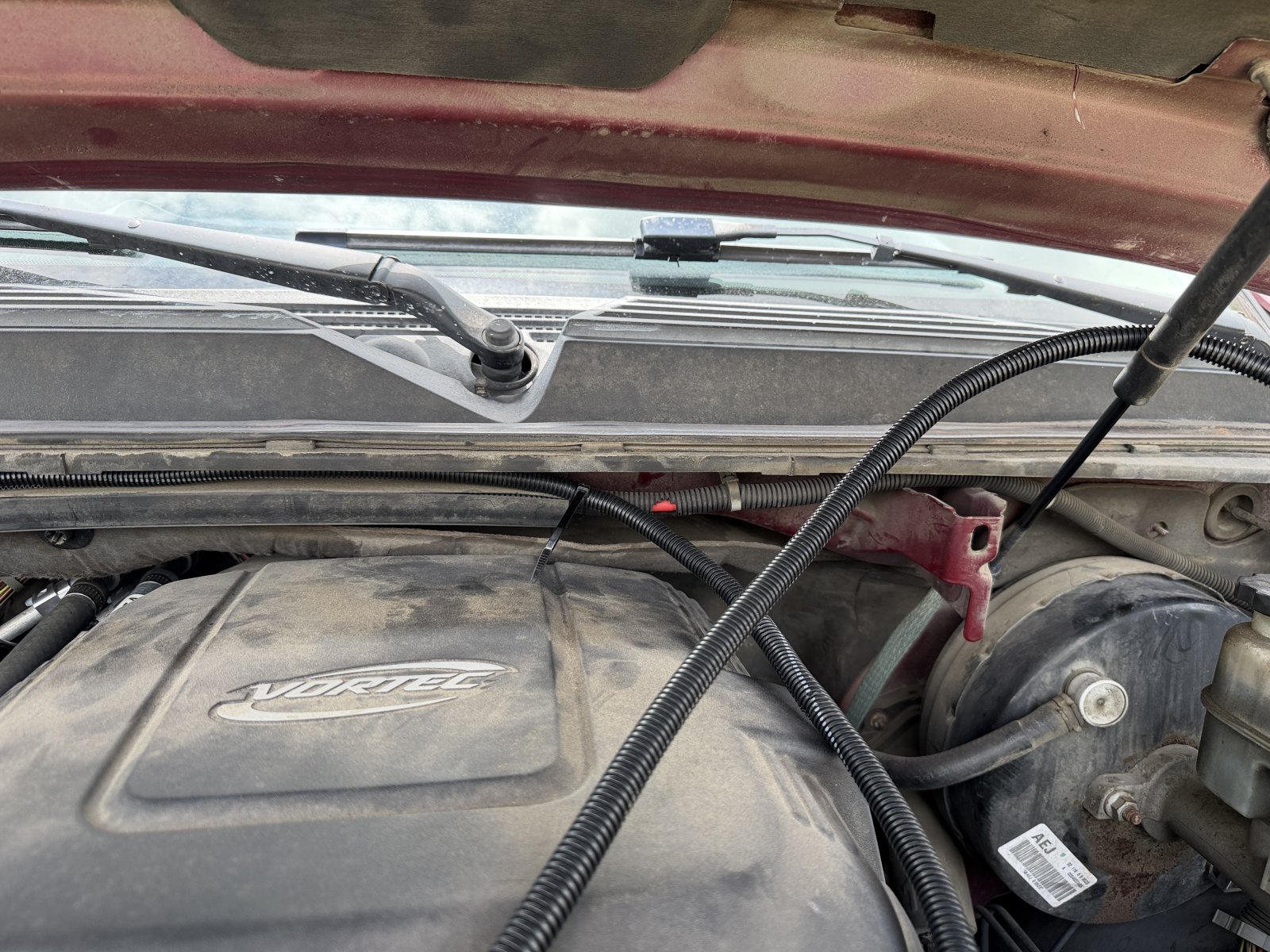

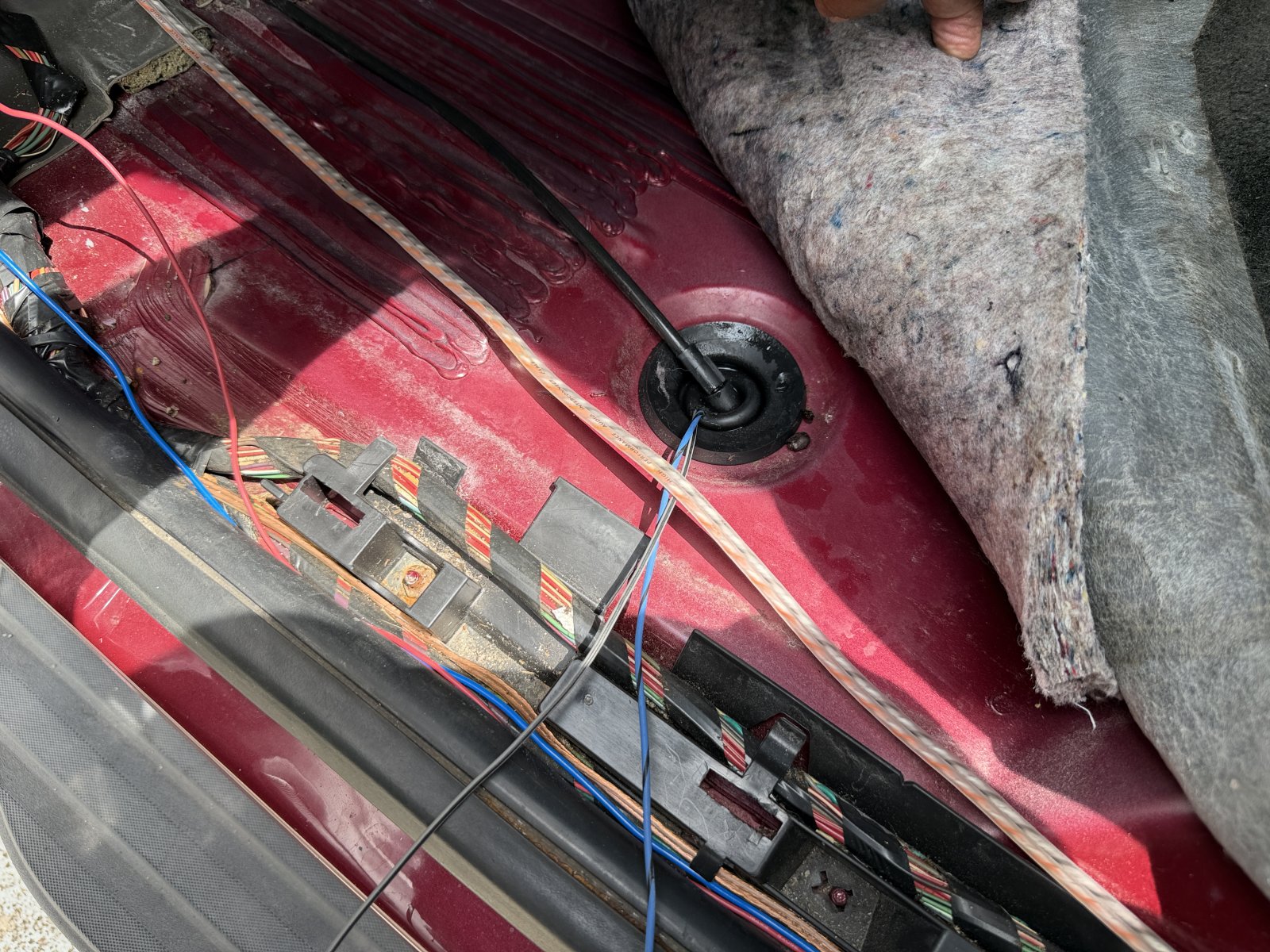

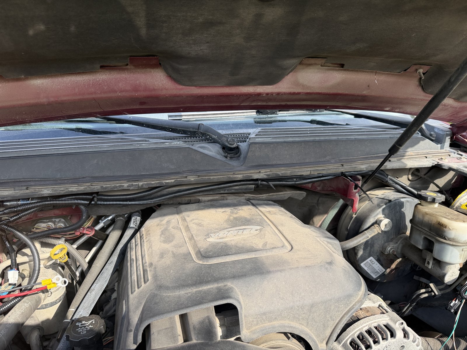

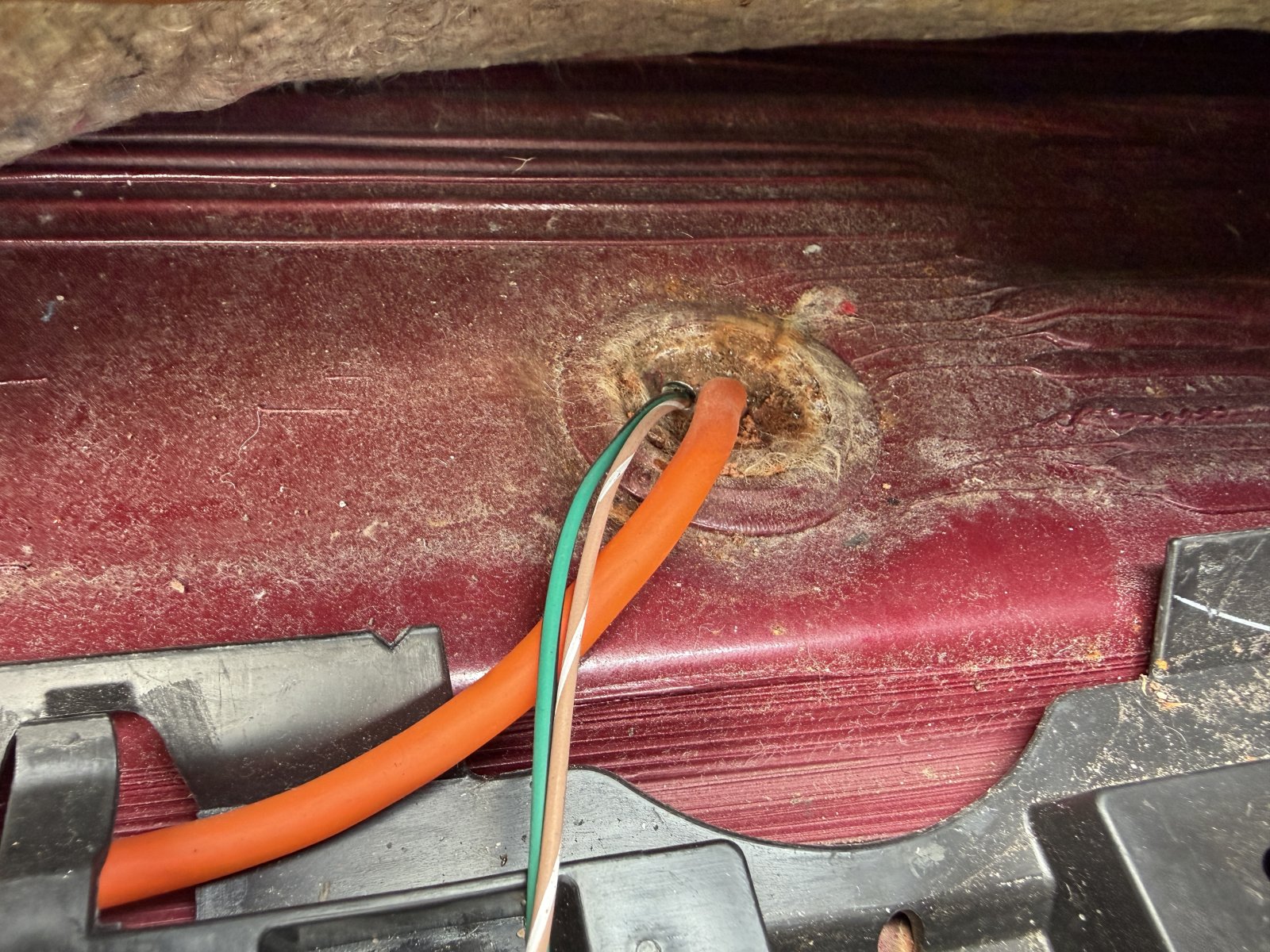

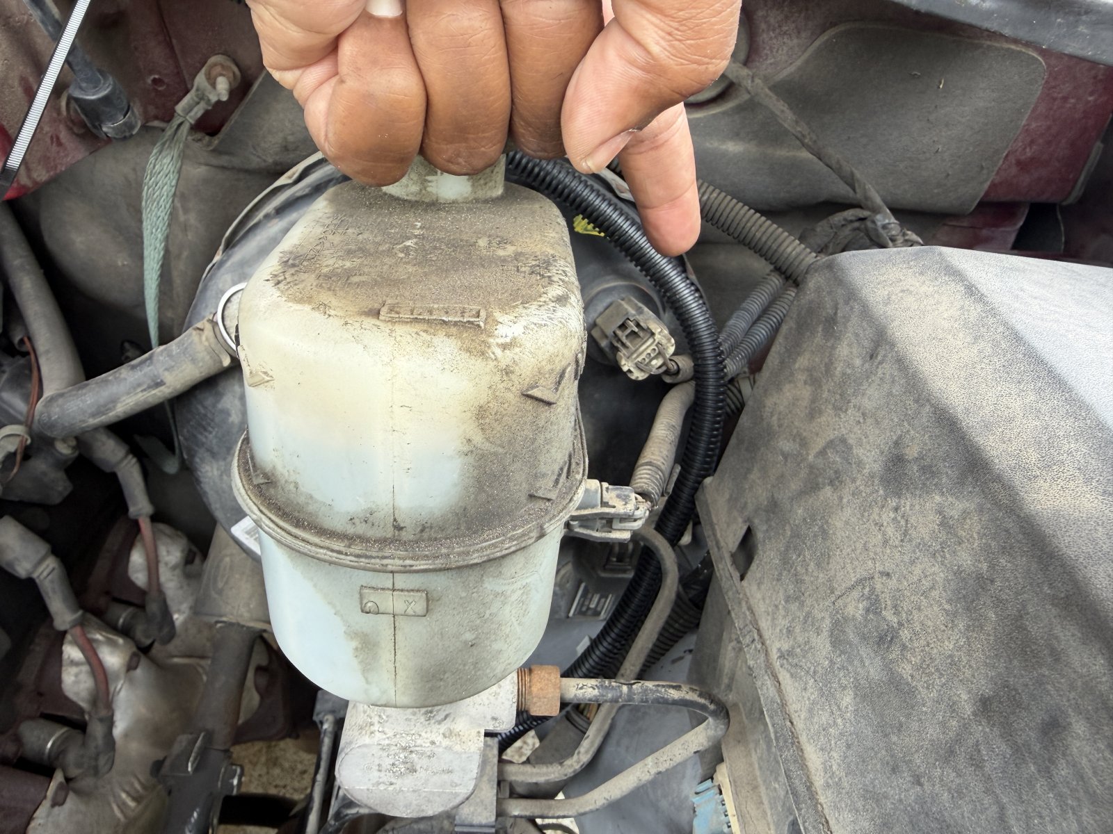

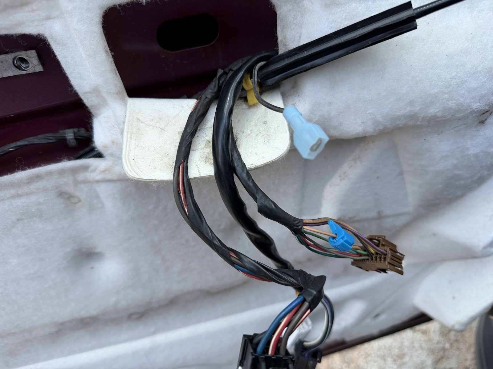

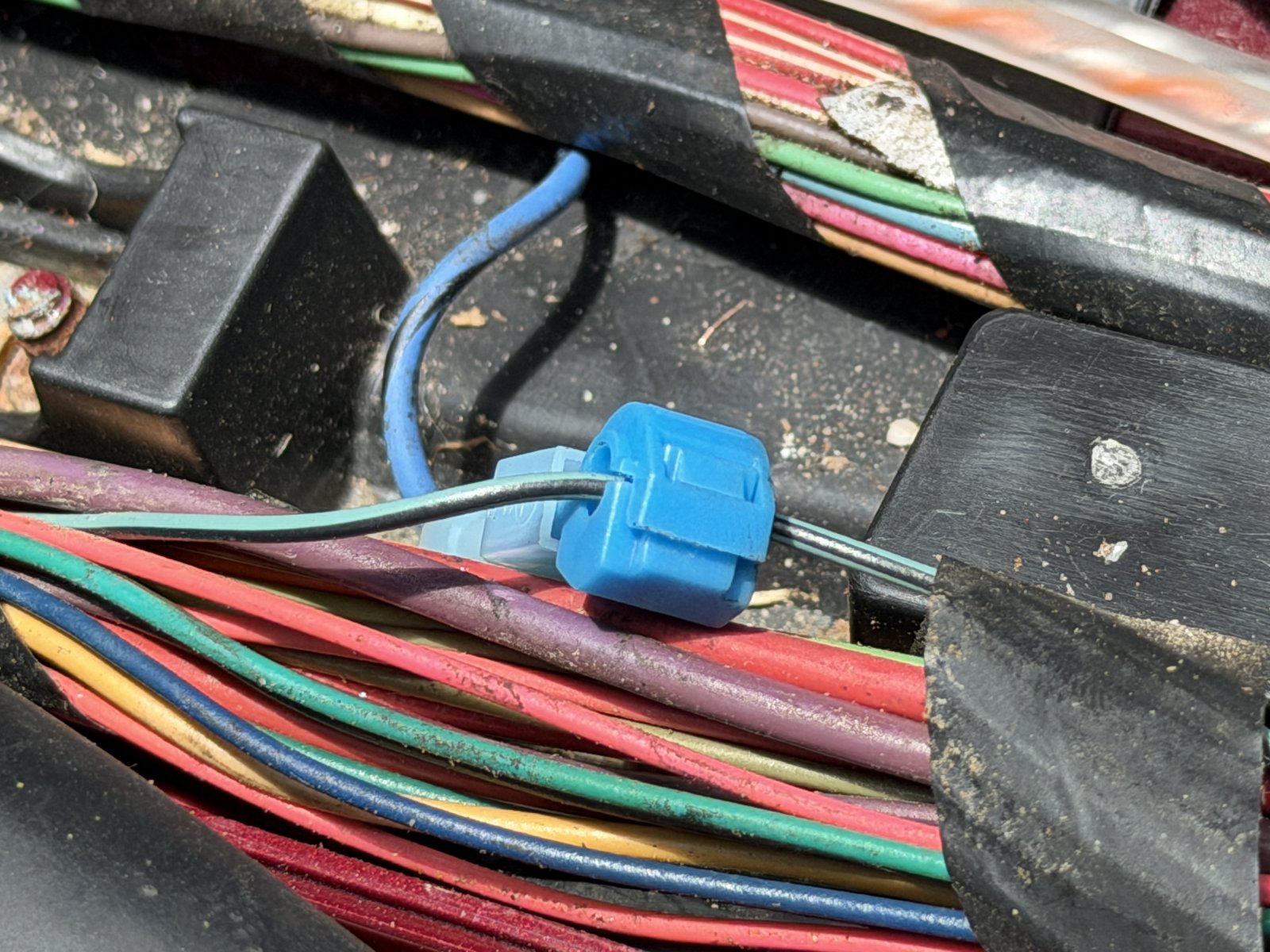

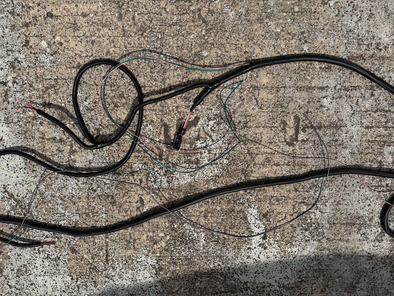

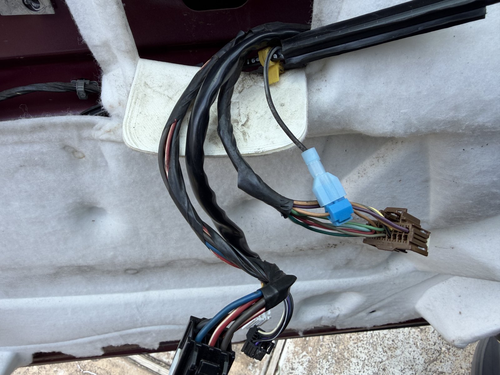

I followed the AMP research PDF and routed the wiring harness across the top. I followed the body harness down the driver side and the passenger side. the routing of the harness was pretty straight forward. I drilled a hole thru the a rubber grommet that brings the trigger wire up right under the carpet on the drivers side. The same on the passenger side. It's not a rubber grommet on this side, it needs to be drilled thru the floor. The most difficult part was routing the trigger wire thru the door boot. Pain in the ass, but I got it done. The trigger
