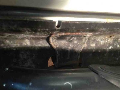

Snapped Bolts
So finally had a warm/dry enough day to get under the hoe and check her out... I took a couple pictures to show everyone what I found... If yours are flexing I would take a look and see if you have any bolts missing. There are about ten on each side that were missing/sheared off. They are aluminum (SP?) so not exactly sure what I want to try and replace them with, but when you take the gray piece of plastic off they you will be able to see really quickly what I found and if you have the same issue

Mine is not a Z71, but a 2000 yukon xl, it flexes bad on the drivers side, thanks for the pic, I bet thats exactly the issue with mine!
Thanks for the pics! I know what I'm doing this weekend....

So I had a chance to take mine off today.....
I was planning on slapping some stainless steel bolts in there along with lock washers and nuts, but you can't get to the other side of it to be able to put the nuts on. It seems as though GM used an aluminum push pin type thing to secure these (no wonder they're loose). This is obviously a crappy design, but without being able to get to the back I think I may have to get a few of these from the dealer.

This is one of 5 brackets that bolt up to the truck to support the step tubes. As you can see ALL of them have they're bolts sheared off!
