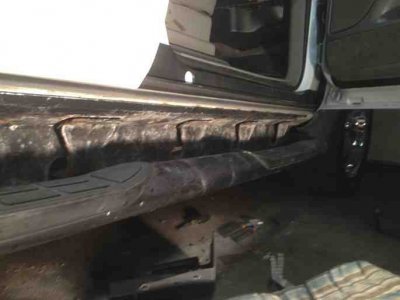

So I had a chance to take mine off today.....
I was planning on slapping some stainless steel bolts in there along with lock washers and nuts, but you can't get to the other side of it to be able to put the nuts on. It seems as though GM used an aluminum push pin type thing to secure these (no wonder they're loose). This is obviously a crappy design, but without being able to get to the back I think I may have to get a few of these from the dealer.
Any thoughts guys??

I had the same issue with my 04 Z71.. What i did used some bolts large enough and tight enough to screw them and it held up pretty good
Are you refering to like self tapping screws??? or an actual nut and bolt??? I'm out at school and can only lay on the ground so I may not have the best angle but how did you keep the nut from spinning???
No nuts, just used a bolt. not sure on size but it held up my PLUS SIZE ass
