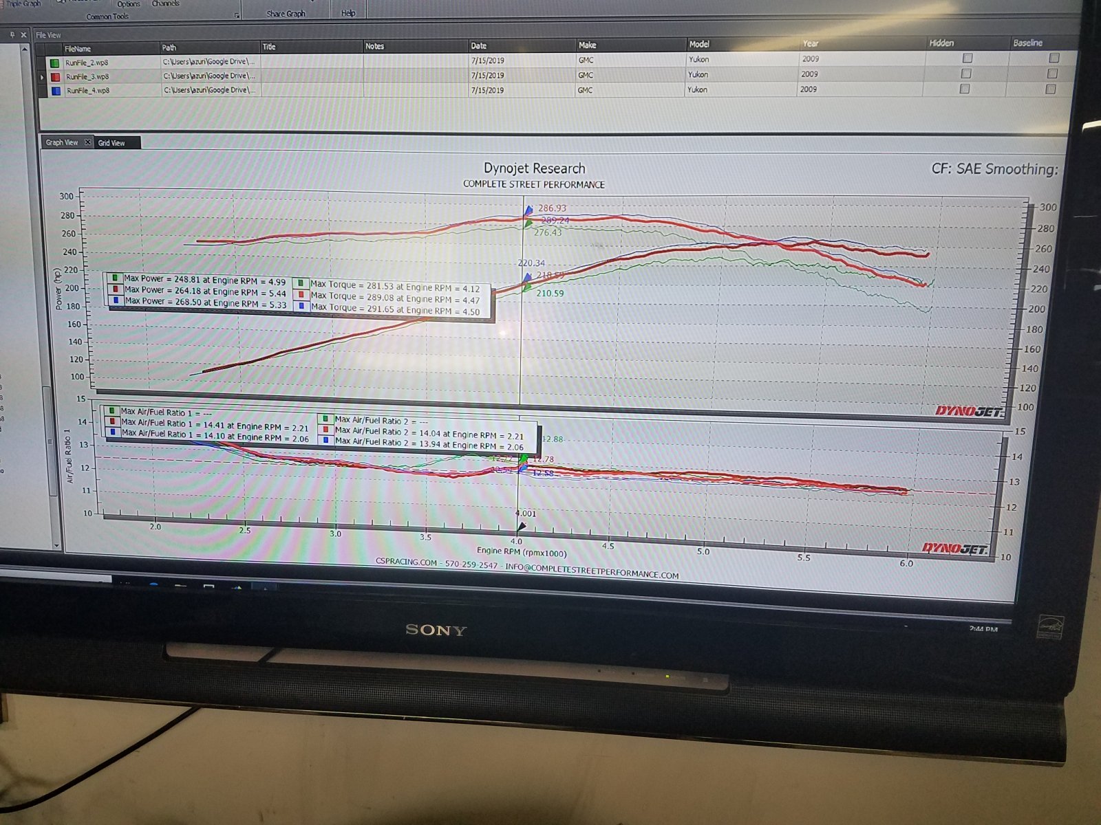

Hey guys I was just curious what kinda dyno numbers everyone got along with your list of modifications. I'm curious to see if my Yukon is on the low end or if it's right where it should be.
Mine is 09 Yukon 110k
5.3
6l80e trans
3.42 gears
4x4
Stock 20" rims and tire size
S&B intake
Ceramic Gibson Shortys
Magnaflow Muffler 12589? The popular one.
Slp resonator delete.
Keep stocking piping as its already 2.75in
Dynoed at 268hp and 291tq

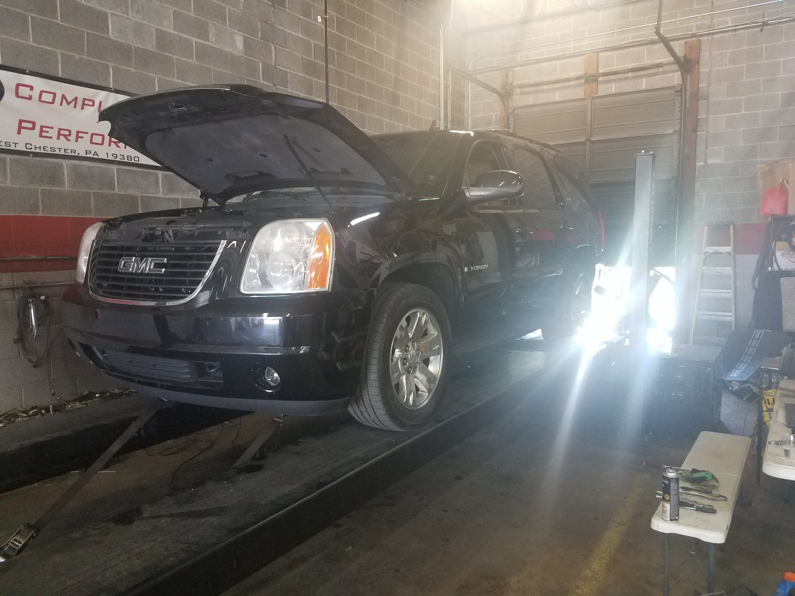

She was dynoed at complete street performance in west chester pa.

Just curious, what gear did they dyno the truck in???

3rd or 4th. I think they initially did 4th but it got up to 145mph on the dyno so they did the next pull in 3rd. I'll find the actual print out maybe that will tell me a definite answer.

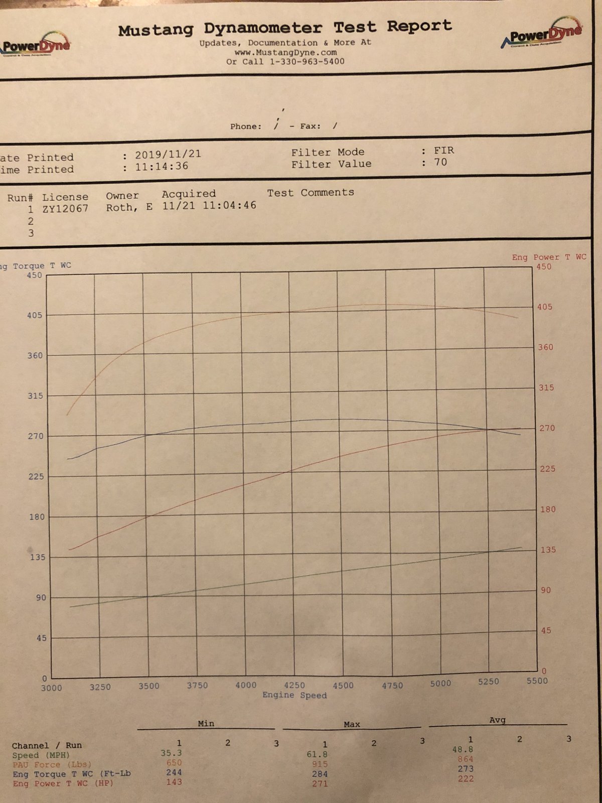

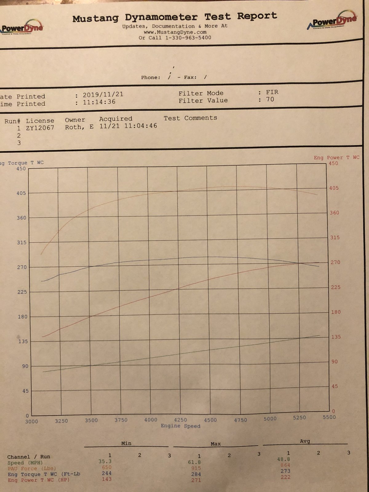

I have a stage 2 Texas speed high lift cam , dod delete , ls6 springs , ls7 lifters , ls2 timing chain and sprockets . While getting the cam replaced , my mechanics noticed my cam bearings were worn so had the whole motor pulled , all new bearings , pistons and rings and balanced . Made 271 hp and 284 lb/ft . The pull was made with stock 20” rims and in 4th gear on a mustang dyno

Ohh man that doesn't make me feel good about my up coming build. I was really hoping to break 300whp. The only 2 things i have different that can help hp is ill have upgraded trunions and PRC CNC ported 243 heads.

Eric, did you notice the cam bearings were worn, befor ethe delete install or after? I just purchased one from TSP, along with LT headers and a torque ocnverter
