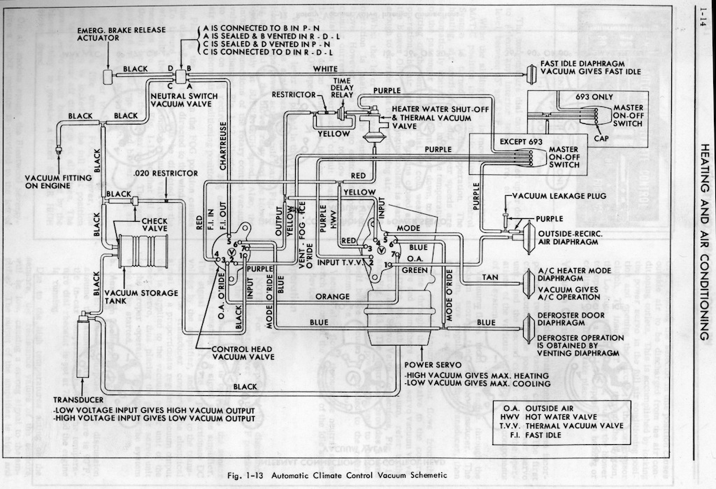

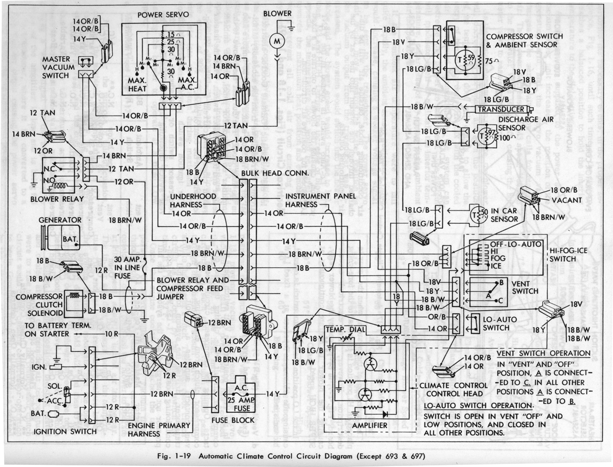

I did find these online

Yeah I had a diagram but still couldn’t really figure out what I was doing lol. His manual explained things so I could understand them. Told me where to test and what the readings should be. If they were not in range it tells you what to check next.
