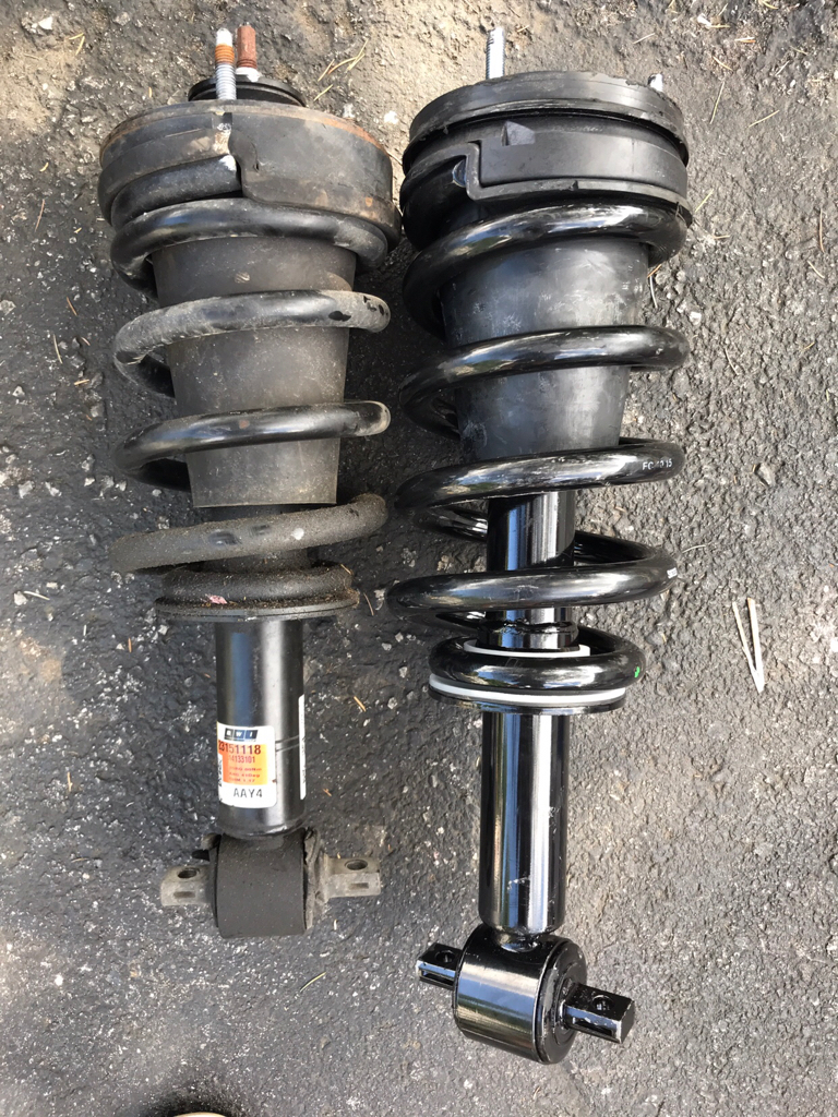

With roughly 80k on the clock our 2015 Tahoe Magneride struts were absolutely shot. Actually around 70k some mileage we noticed lousy performance.
Considering the ridiculous Z95 replacement costs I purchased the half kit from Xineering and replaced the Z95s with a regular strut assembly an LS or LT would take.
While the new struts were a bit of a handful to wrestle (longer than Z95 units) I was able to complete the job within a few hours by myself.
The Xineering Kit worked flawlessly and the new struts are providing a taller (didn’t need to reuse leveling kit) and smoother ride at a fraction of the Z95 replacement cost. Win - win - win!!

Great! Those Fox units will be darn nice. The only pain was that I had to trim the studs on top of one strut assembly just a bit to get the to fit as they’re 2” taller than the Z95 assemblies. Also passenger side top strut mount is slightly more tricky to access due to AC lines, etc.
All-in-all not too bad. Give yourself plenty of time, a decent impact wrench, (few brews) and you’ll be fine!

Holy shit, those are waaaaaay longer! Are they supposed to be factory replacements?!
The fox units can apparently be adjusted down to no lift. I would like to run them up around 1.5” of lift. I currently have a suspension max 1.5” spacer kit under the struts now. Rather it not be any taller than it currently is, otherwise I will have to put a small spacer out back.

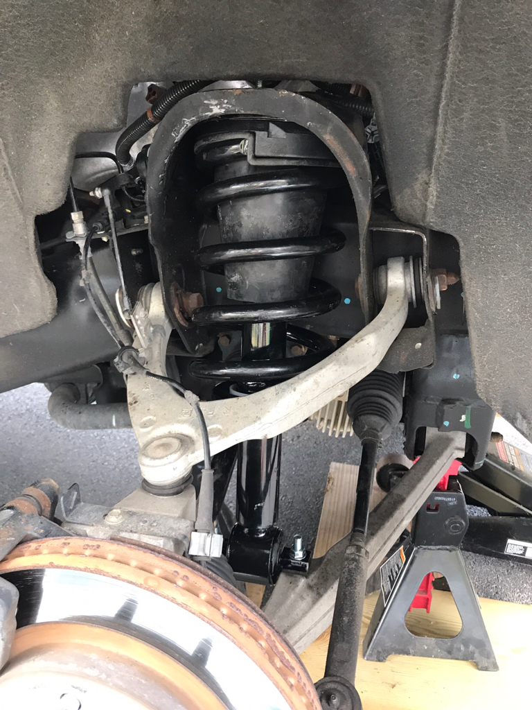

I did the same for my wife's LTZ and she hates the level ride. It had 3 inches of rake in it before I did the work and now it is completely level. Trying to find a way to lower the front or raise the rear by about 2 inches. Pucks in the back would probably be the cheapest option but then I'm concerned about over extending the shocks.

so you installed the fox units? They are adjustable. You have to remove them, fully compress the coil, then adjust the lower nut down.
We got nearly 3” of lift when i originally put the fox units in. That was where they were preset. I have since adjusted them down.
another option would be a rear coil spacer, which you could add in a shock relocation bracket to reuse the factory shocks. But, imo 3” is just way to much added height up front for an otherwise “stock” suspension.

My bad, I didn't mention I installed Monroe 139104's in the front (not Fox) and it raised the front by 3 inches. I'm thinking about putting a spacer in the back now. A rear spacer would solve it and keep me from hitting my head when the lift gate is open too. :)
