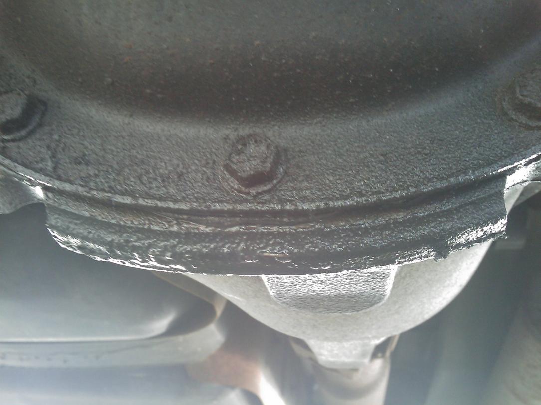

Guessing a leak, but hoping not
Well finally had a chance to look under the tail end of the truck and so far the muffler looks intact and secured, heat shields and other lines are secured. Went to check to ensure that the spare was secured and noted that the back of the u-joint was dark around the edges. Upon further evaluation there appears to be an oil-type substance leaking out the lower aspects. My hope is that it is nothing...but my guess is that I should get it into a trans shop to have it checked out, any thoughts as to whether or not this could cause the noise that I am hearing before I spend the time (and money) to have a trans shop look at it?
