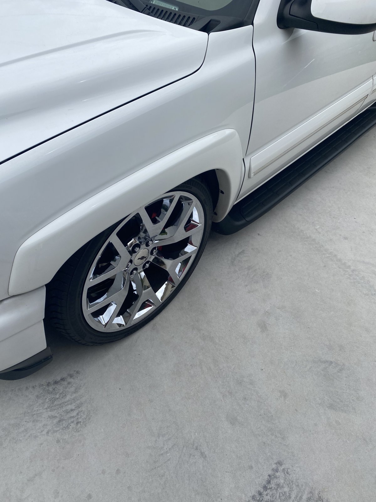

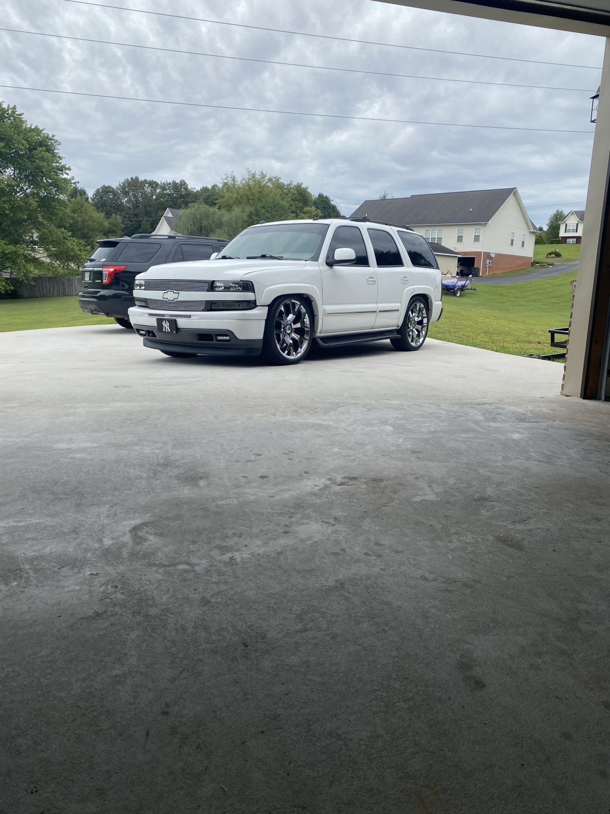

They will for sure fit. I’m slammed on 24s so 20s won’t be nothing.

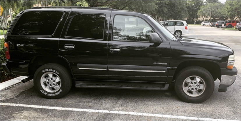

Welcome to the Forum from NH.
Pics of the truck, please.
