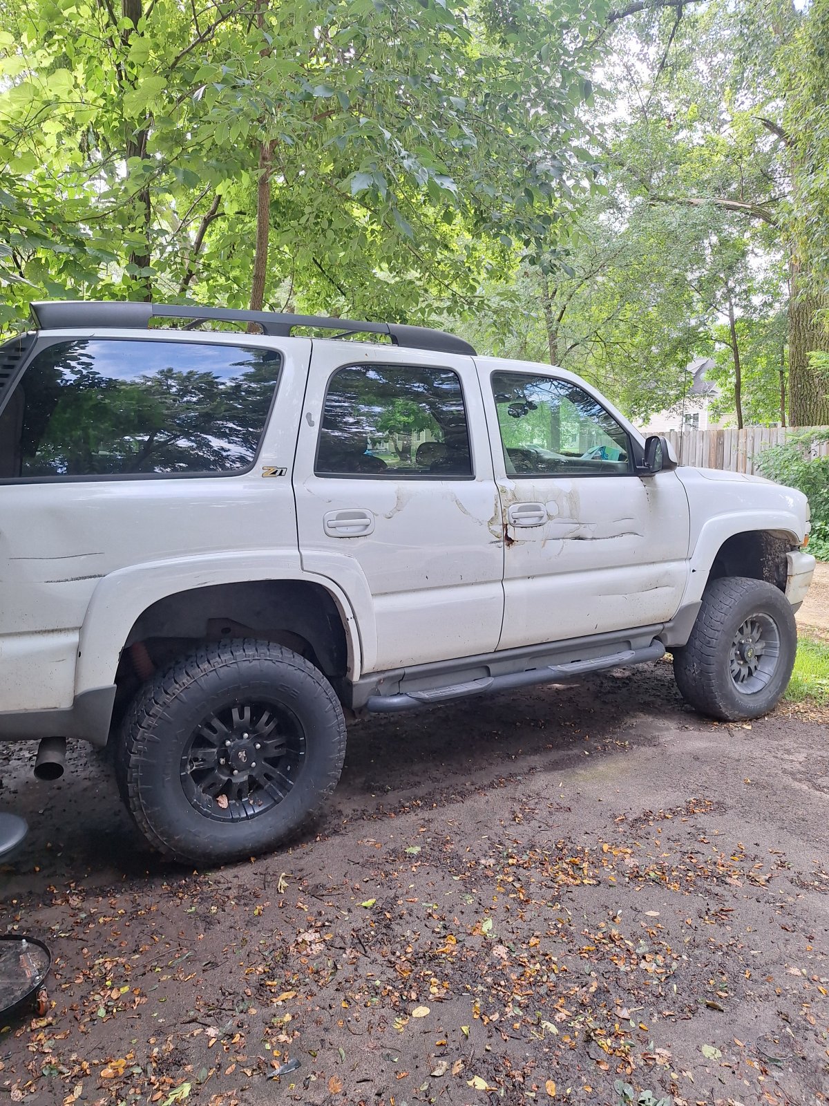

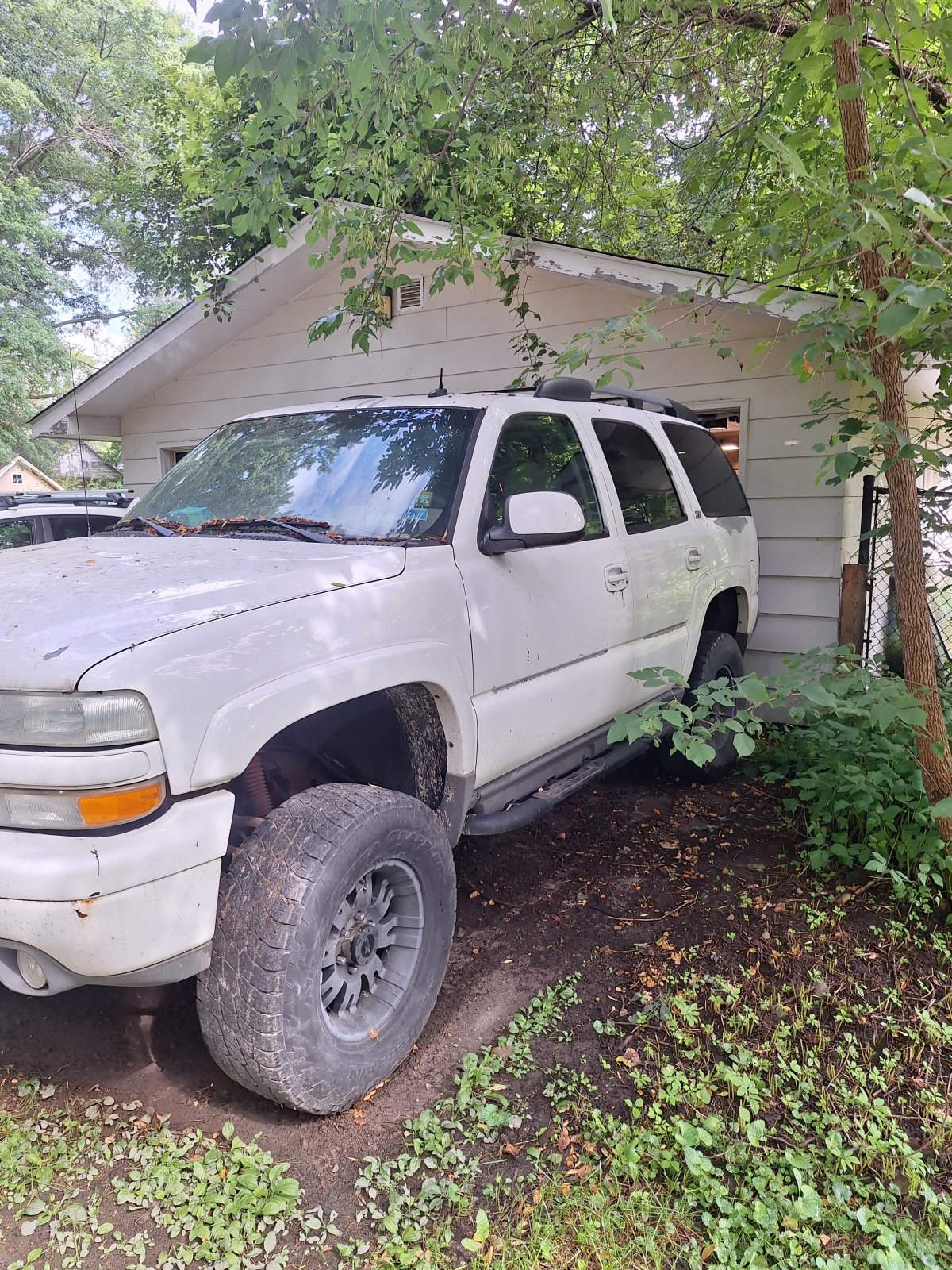

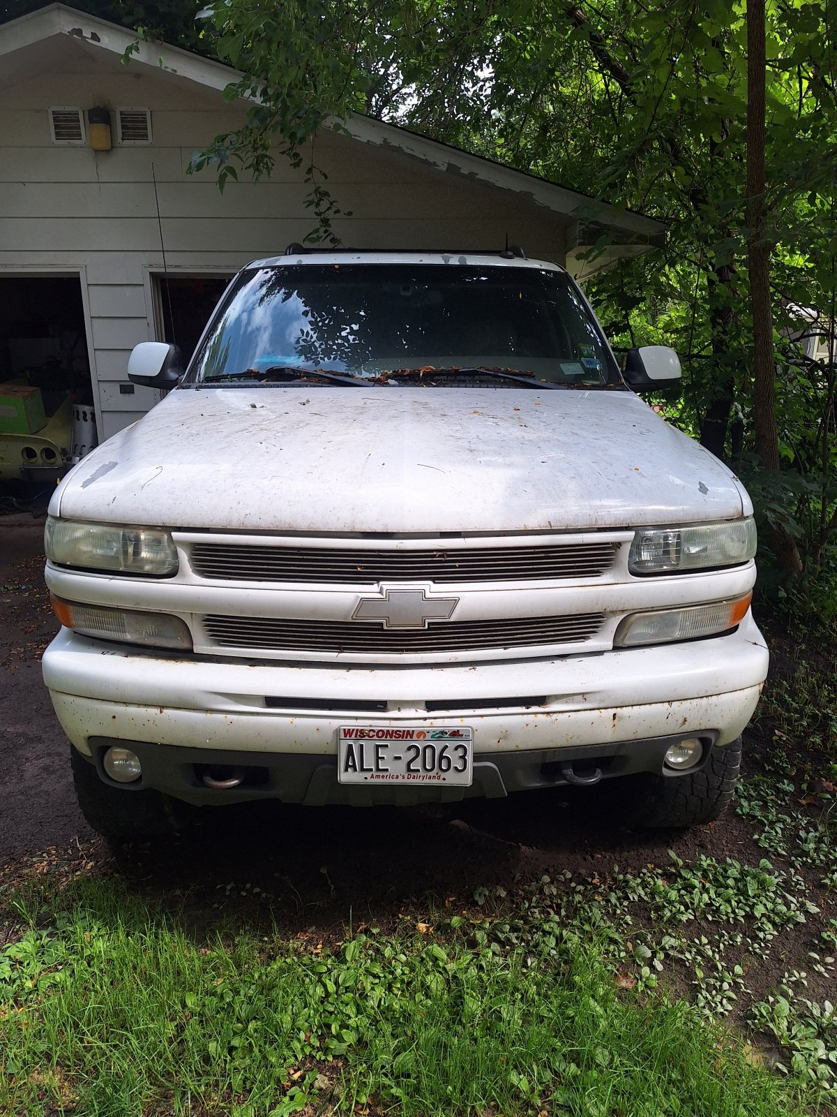

Welcome to the Forum from NH.
Pics of the truck, please.

I will get some pics over the weekend. I am sure i will be posting more as i have some plans for this tahoe. I will also try to get it off the ground and see what happens.

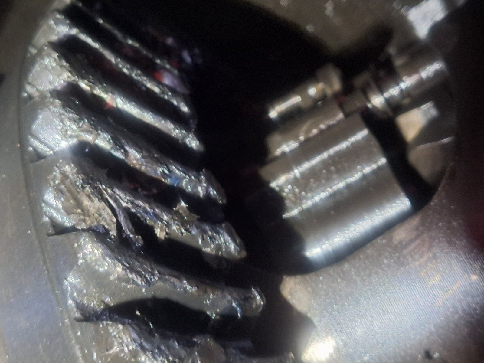

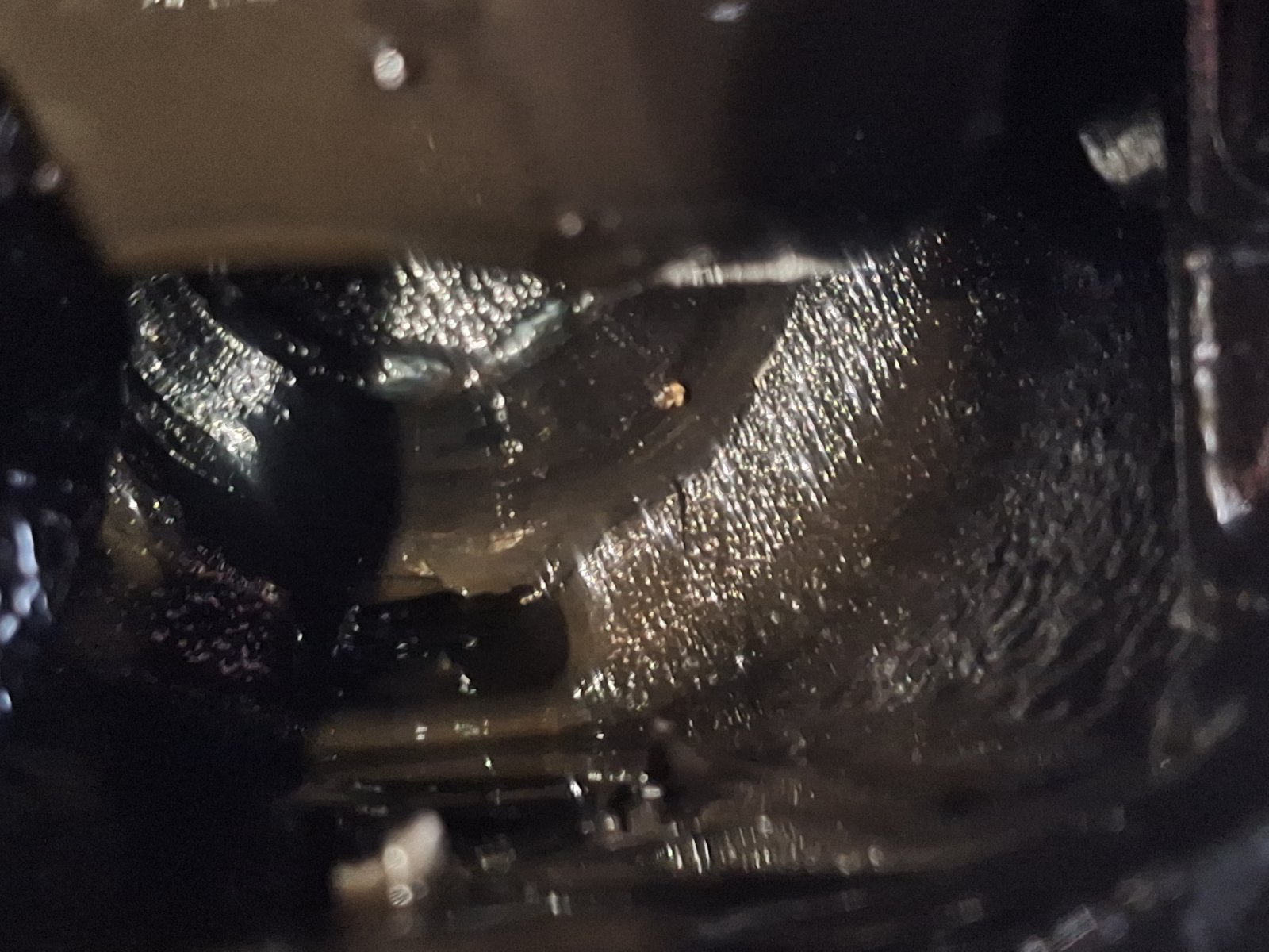

Well, here she is, in all her glory! I willgo to the boneyard shortly and grab another door. But first I must address this.
Kinda hard to tell, but that is my rear pinion gear. Mirror smooth. Where did the teeth go?
There's some of them. I can't believe this thing even moved on its own. The rest of the teeth are in the bottom of the housing. I've been wrenchin most my life and I've never seen a pinion gear like that. Needless to say I am going to replace this whole assembly. It's the gt4/g80 so 3.73 locker. Yes I know it needs to match the front. But that's always good to point out for those who don't know. I'm going to try to find a Hoe that I can pull the front and rear from. Did any of these 04ish years come with 4.10's? With same wheel bolt pattern? I need to look up the RPO Code for that. Luckily, the yards only have about 20 of this model in inventory at any given time! What a shame. When I get this rear-end out I'll pull that ring and pinion and take better pics. Probably go on my customer states shelf lol!
that's what happens when it gets ran bone dry! that was the first clue

H*O-Lee Chit Batman!
