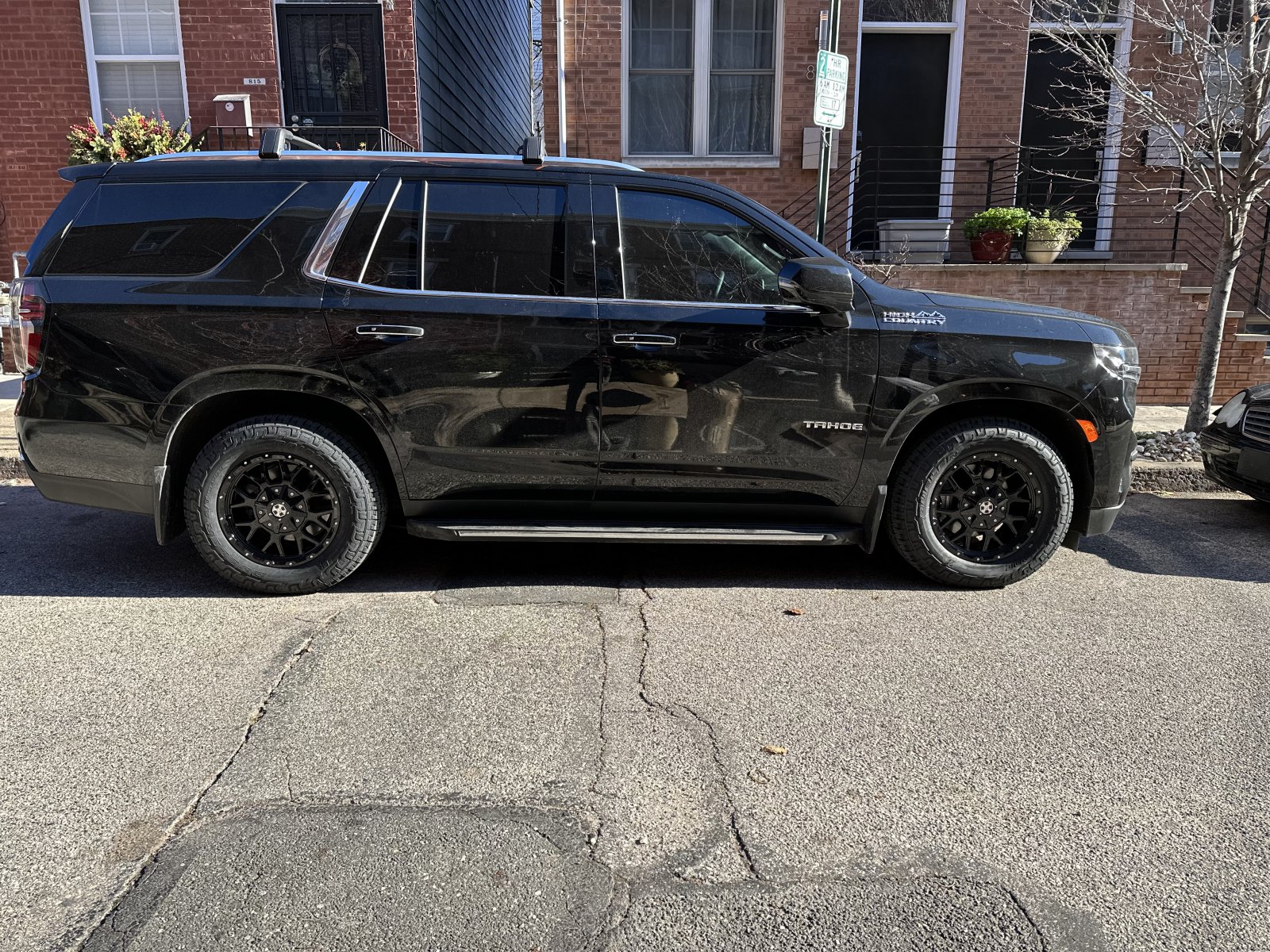

johnnyjr79
johnnyjr79
Jul 2, 2022
New wheels were installed and had no clearance issues.
Do I need to do anything to adjust the speedometer reading? The installer said no, but I want to double-check
She's a little dirty, but the wheels look great.
Thanks again
