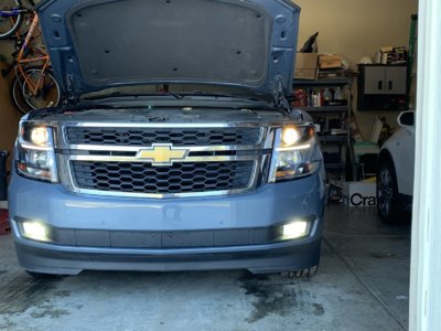

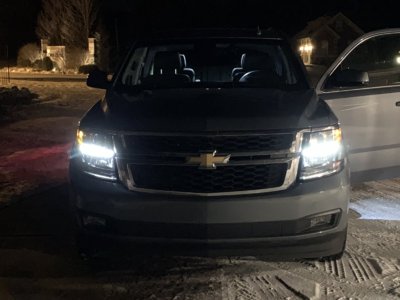

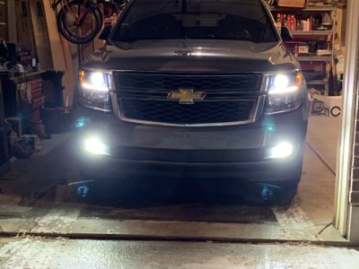

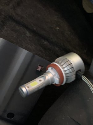

Phase 1 completed. Low beam LEDs. Drove it last night and it was fine. Below is also a pic of my DDL without low beam. I added a relay to my existing fog light jumper with allows me to turn off Head lights via factory switch, then press the button to “turn on” factory fogs, which causes the jumper circuit to open and leaves the LED strip to shine. Maybe not as bright as a LTZ. But it works if I want it too.

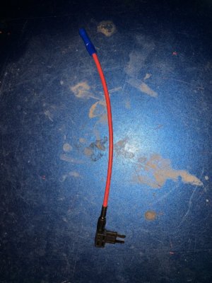

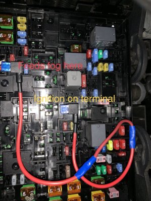

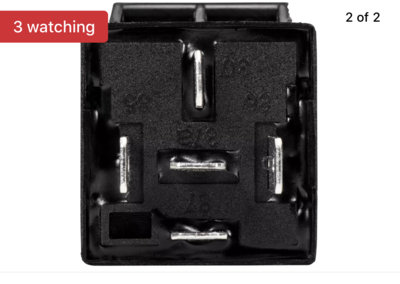

It kinda happened by accident. One pic shows how I configured a jumper from a hot/accessory open port in the center of the fuse box to the feed side of the fog fuse. This makes the fogs live while running, AND allows the auto dim feature to work. It is not able to work with fogs powered on normally.
Yesterday I added a 5 post relay. It receives switched power from the FEED side of the fog fuse slot. I used the relay’s normally closed circuit to allow the fog feed to travel as before. But, when you engage the fog power button, the relay circuit opens, killing fogs. Then you power off headlights, theonly thing you see working is LED strip without low beams. I need to find a smaller5 post relay since it is difficult to get thecover closed with the one I currently have.
