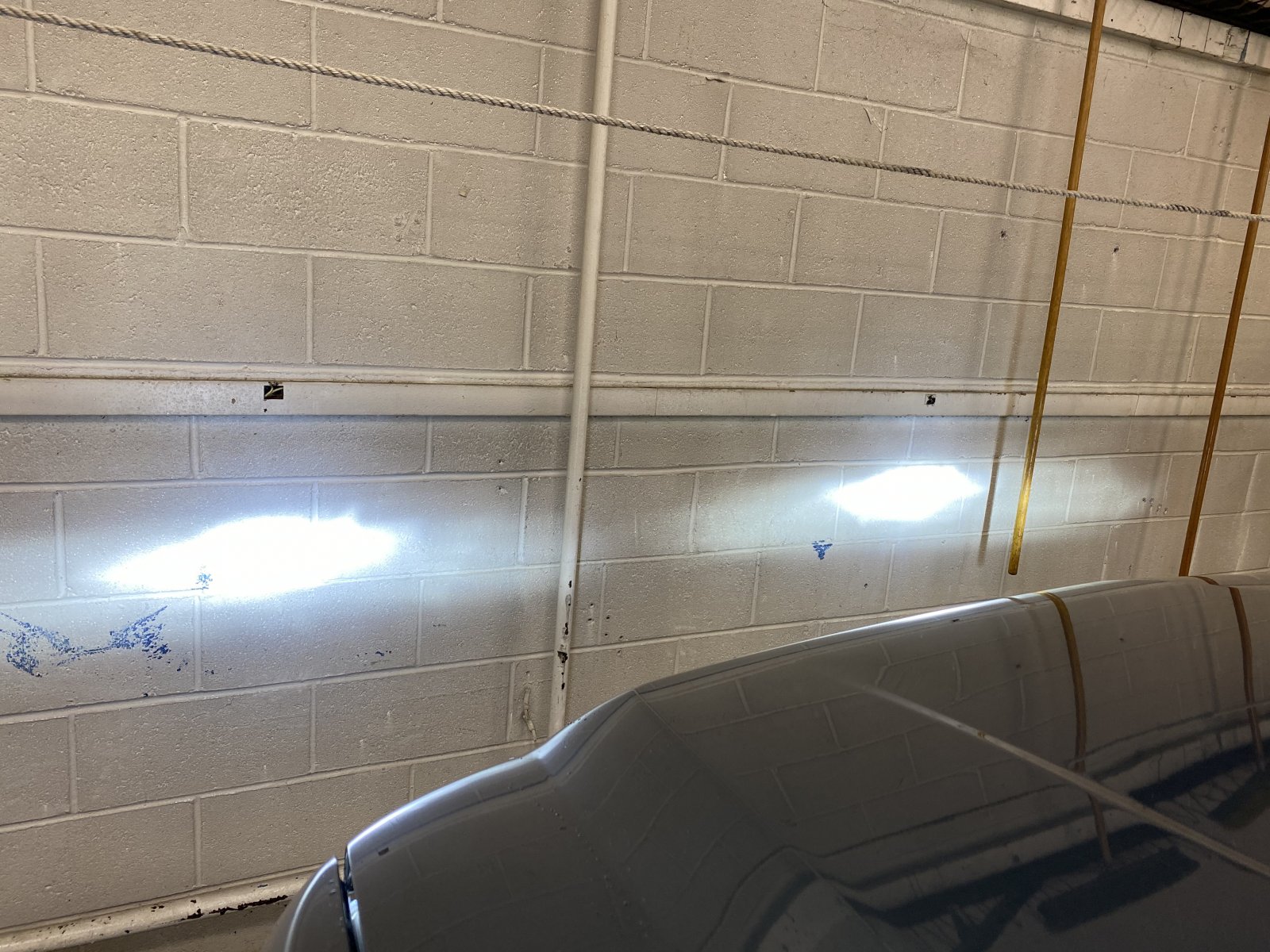

I went with hikari led headlights(white box), theyre set up like the sealights where you can adjust the beam if needed. Ive had them almost 3 years and still going strong.
I a bit close to the wall i know but you get the picture of the beam style haha
