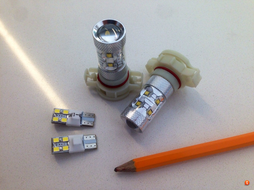

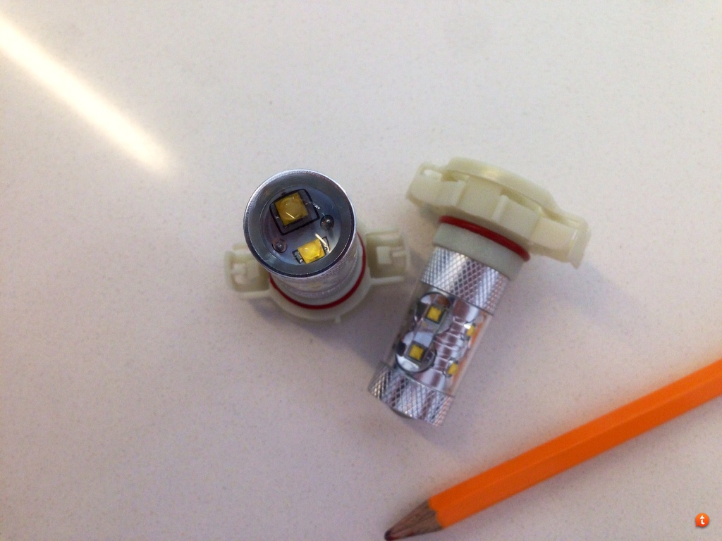

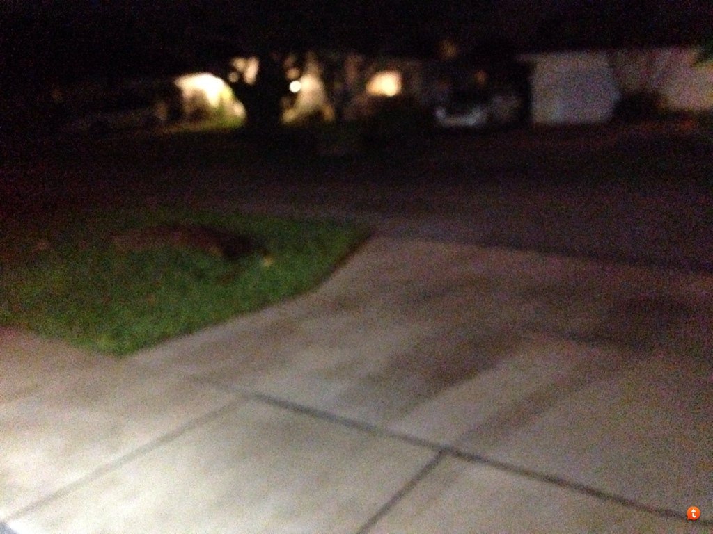

Here we go! Update once the sun sets :)
---------- Post added at 12:07 AM ---------- Previous post was Yesterday at 11:24 PM ----------

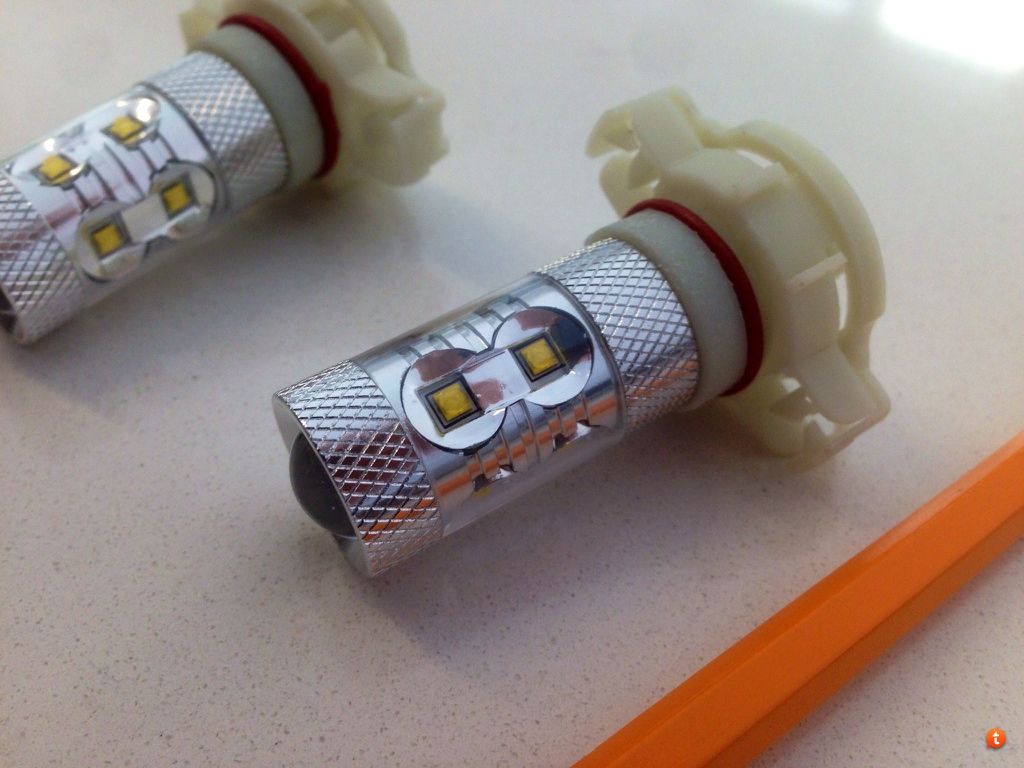

Wow, high quality is right! These are really beautiful in person...
(pencil for scale)

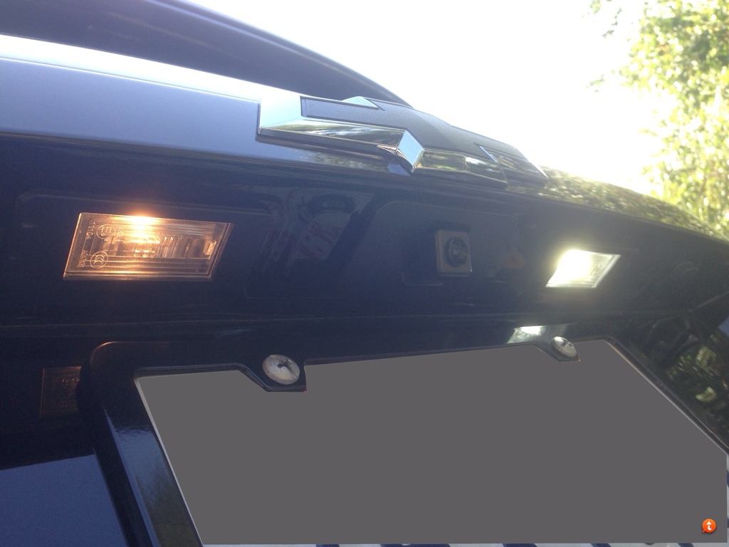

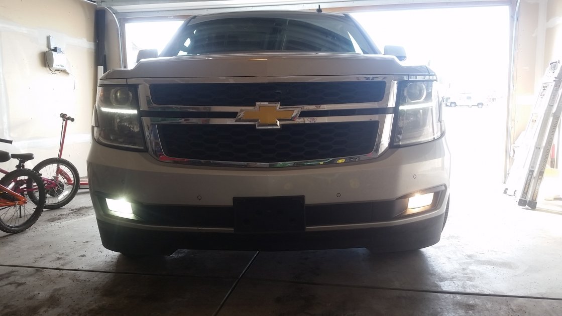

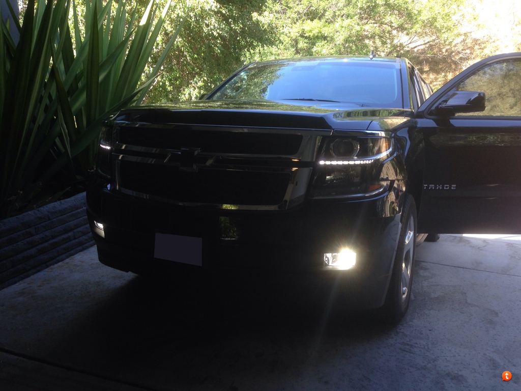

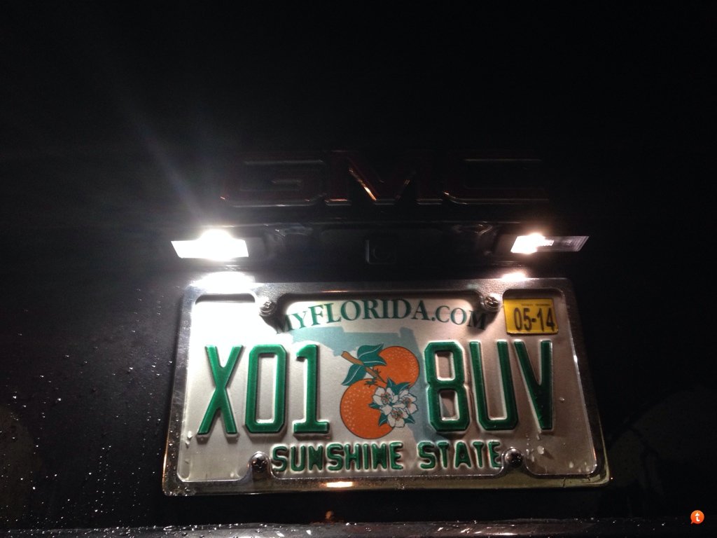

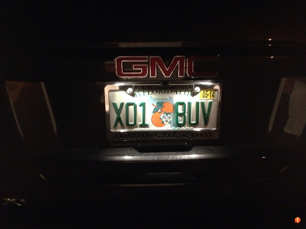

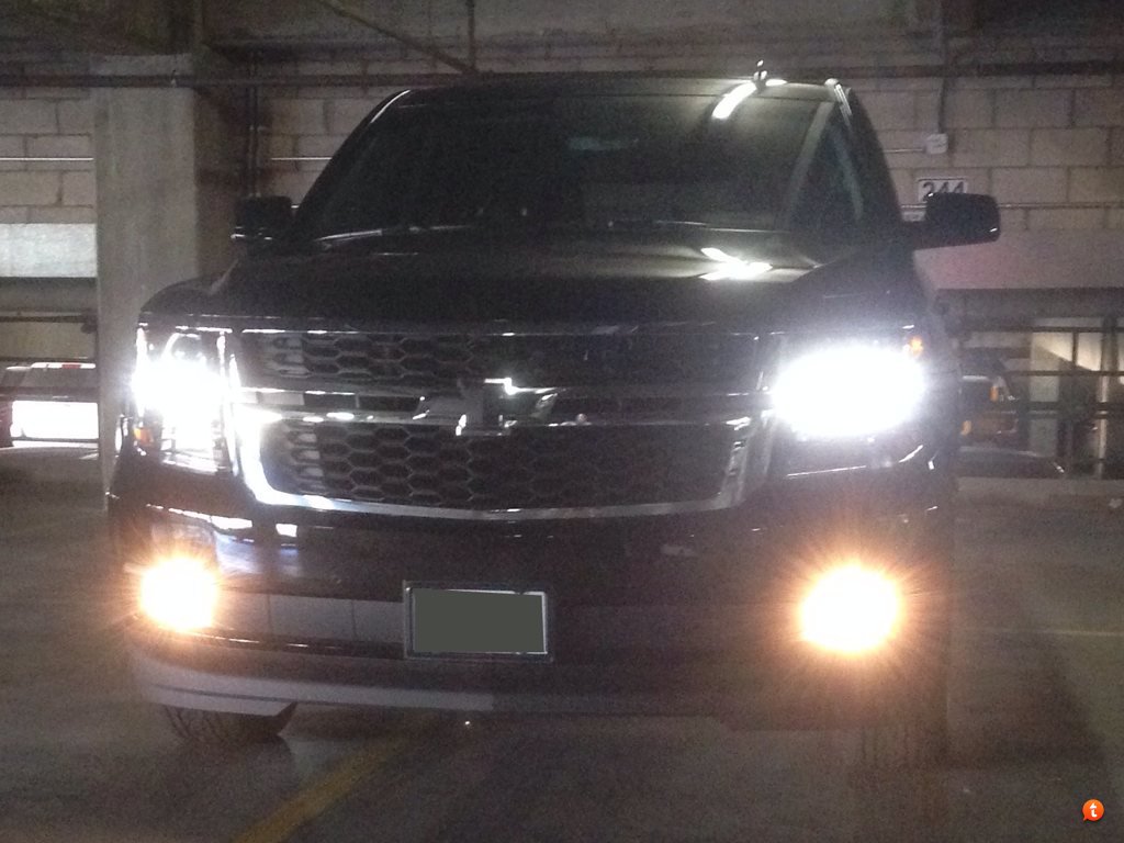

Before (fog color comparison)
After (vLEDs)
Plate (stock on left)
Really pleased. Thanks so much to Steve1081 for the post!

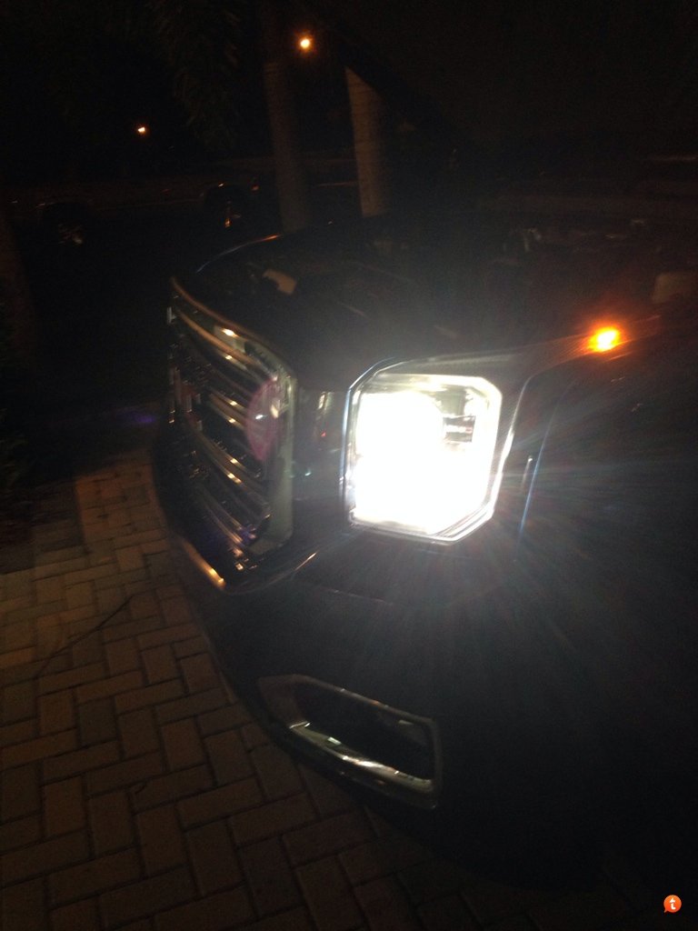

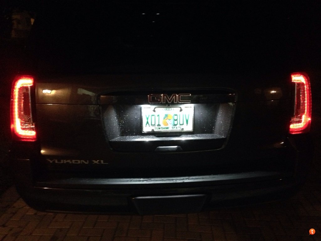

Received the following from vLEDs today and installed:
5k white 10 LED PS24W - fogs
5k white 15 LED 921 - reverse lamps
5k white 4 LED flank W5W - license plate bulbs
I had previously installed silver star incandescent bulbs in the reverse lights and Philips extreme vision 4k LEDs in the license plate. But wasn't really happy with the improvement. So when I ordered the LED fogs I got 5K vLEDs bulbs for these too.

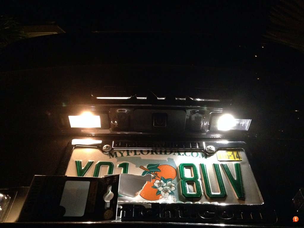

Plate bulbs:
Stock left and Philips led right
Philips LEDs (not much better)
Philips LED right and vLED left
vLEDs (way brighter)
vLEDs lighting up the ground

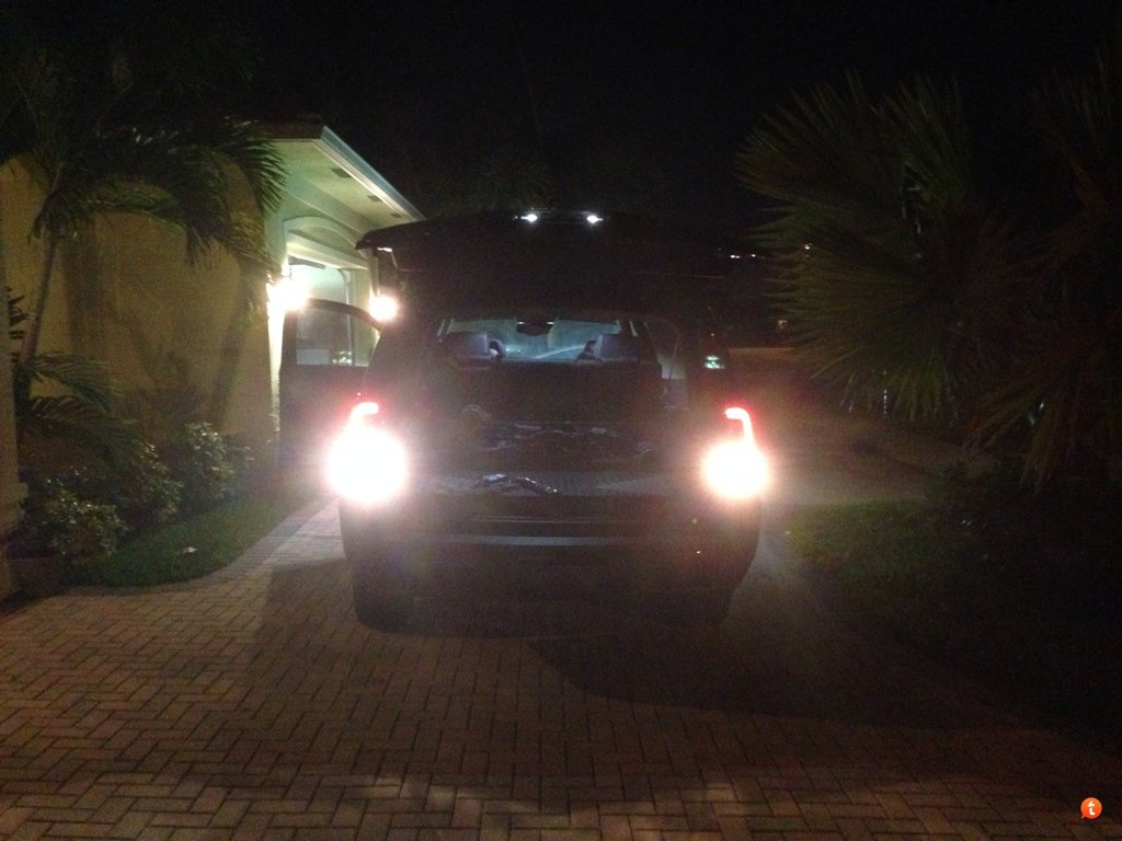

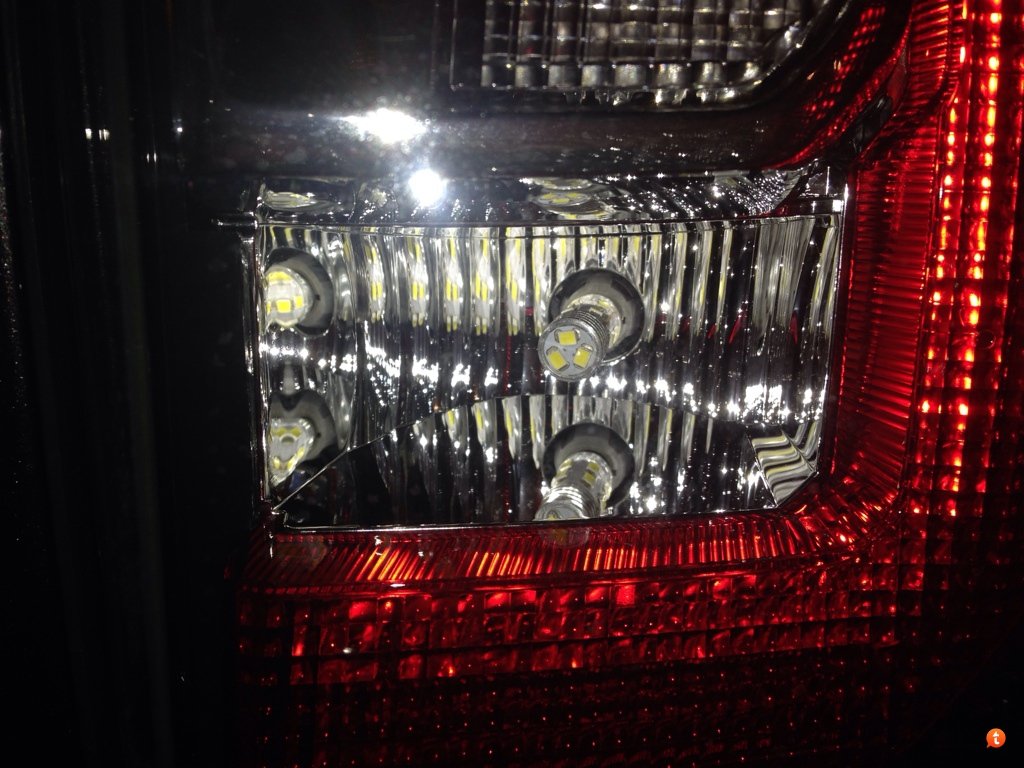

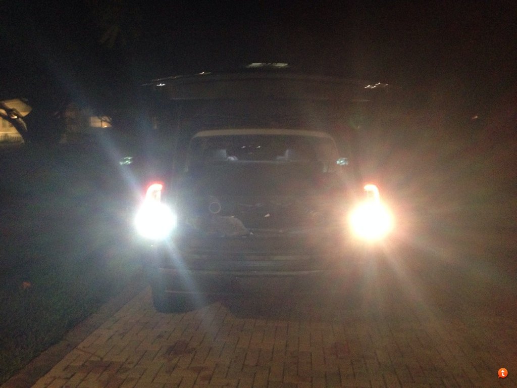

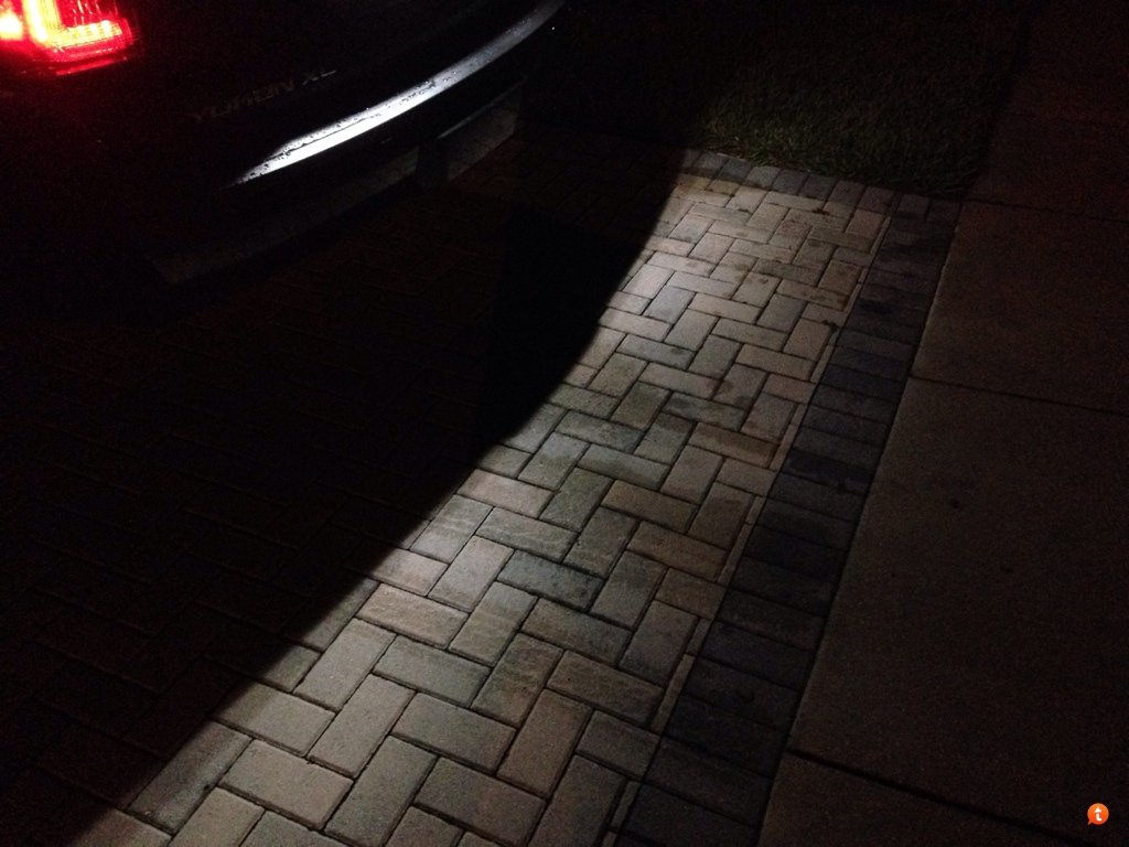

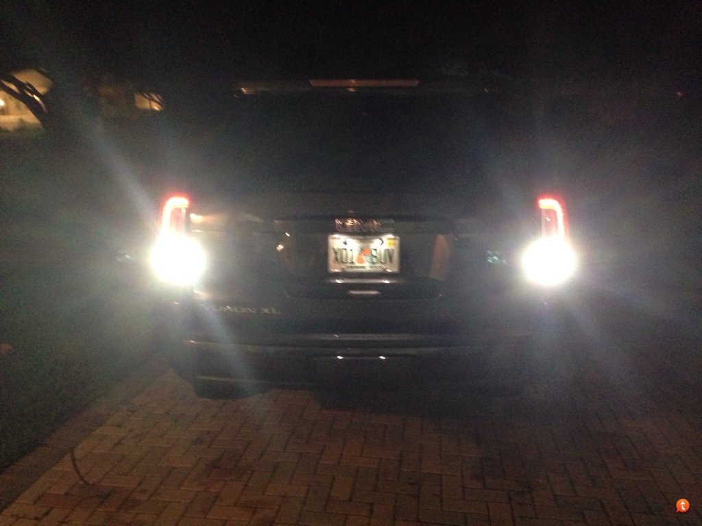

Reverse lamps:
Stock right and silver star left
vLED left and silver star right

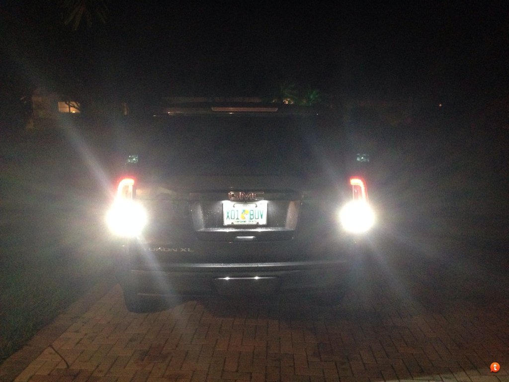

vLED reverse lights (still Philips 4k led plate bulbs)
vLEDs for both reverse and plate bulbs
Ground shot of overall light output in reverse
vLED bulb in reverse light housing

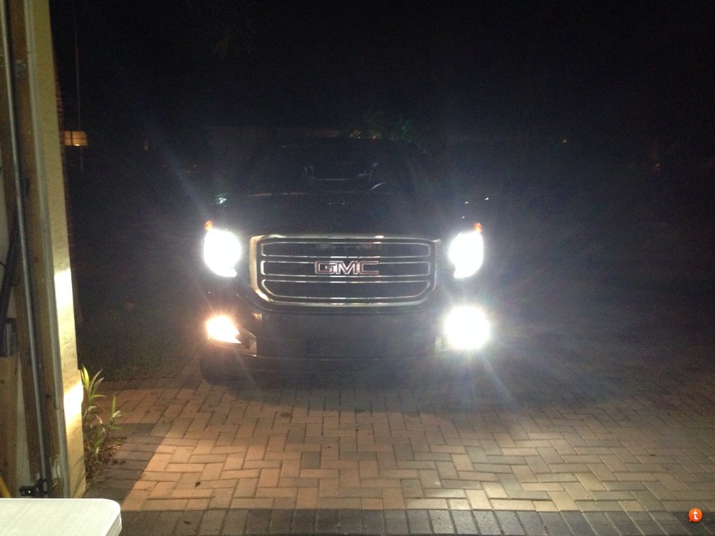

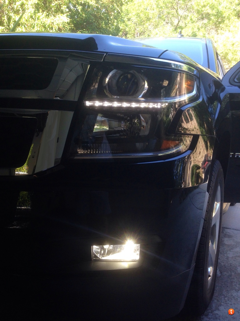

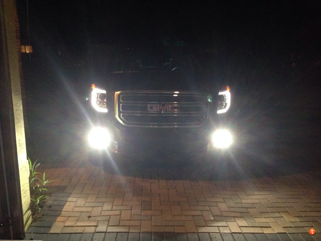

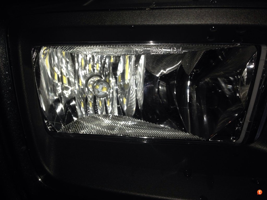

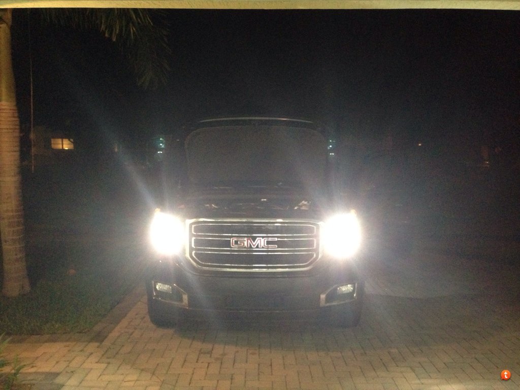

Fogs:
Stock left and vLED right with 4300k TRS HIDs on
Both vLED fogs with headlights off. 5K is a good match to DRLs
vLED bulb in fog housing
Also installed 4K osram highbeam bulbs from TRS. They match the LED fogs and HIDs much better than stock. Kinda hard to capture high beams in a picture but here is a shot at it
Overall i am very happy with the results. The vLEDs bulbs are definitely much brighter than the Philips and a better value. High quality and super bright!
