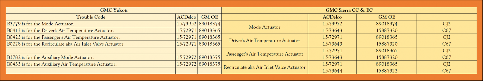

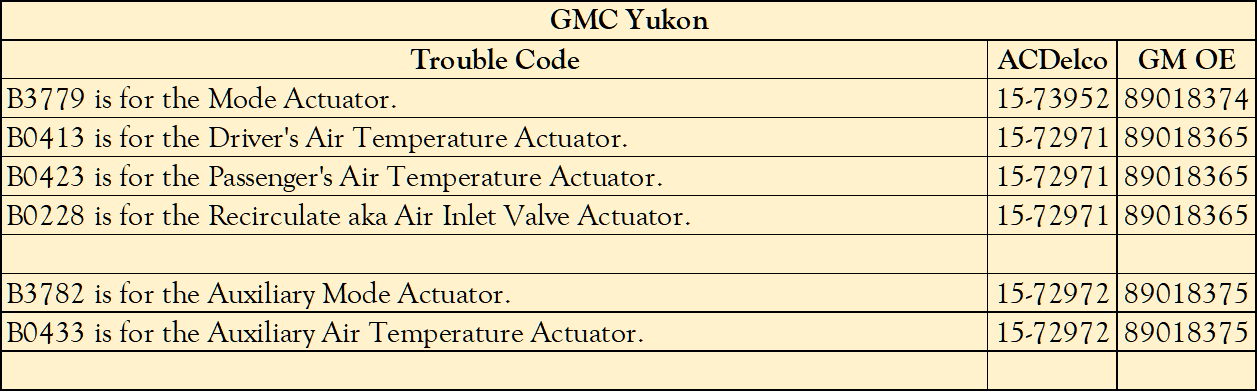

Well, you need a Tech-2 or some other bi-directional scan tool that can tell you what's wrong, allow you to test the actuators, and possibly do some programming.
Only the actuators get calibrated and only the front HVAC control module gets programmed. Double check the part number of the actuator you used against the ones posted below:
