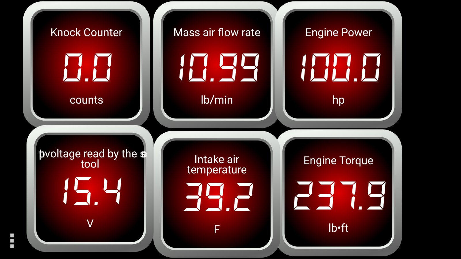

Airaid MIT for a 02 6.0 in a 2500 Sierra on my 06 Tahoe. Stock box and filter.
Outside temp was 38 so barely over a degree difference at 60.
