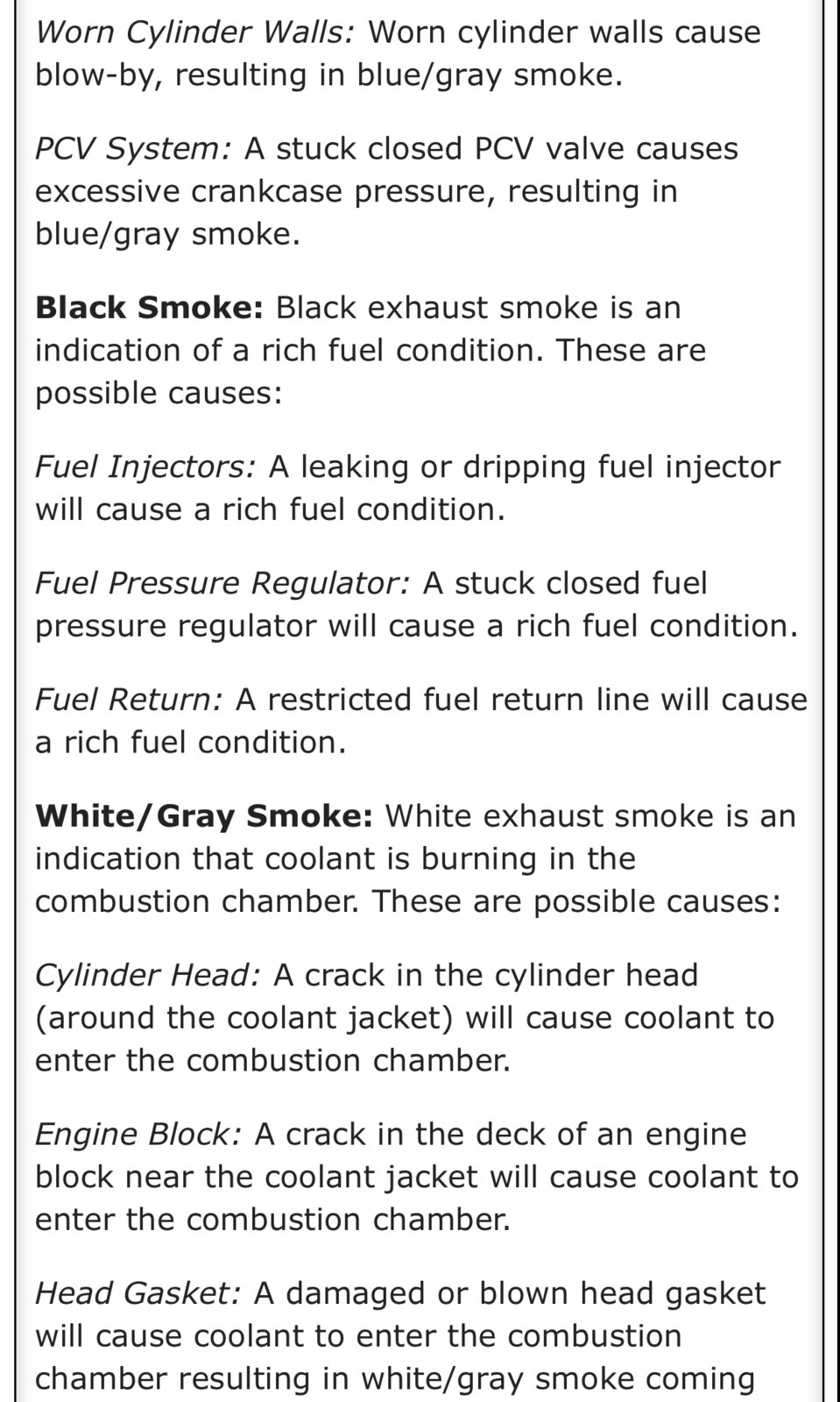

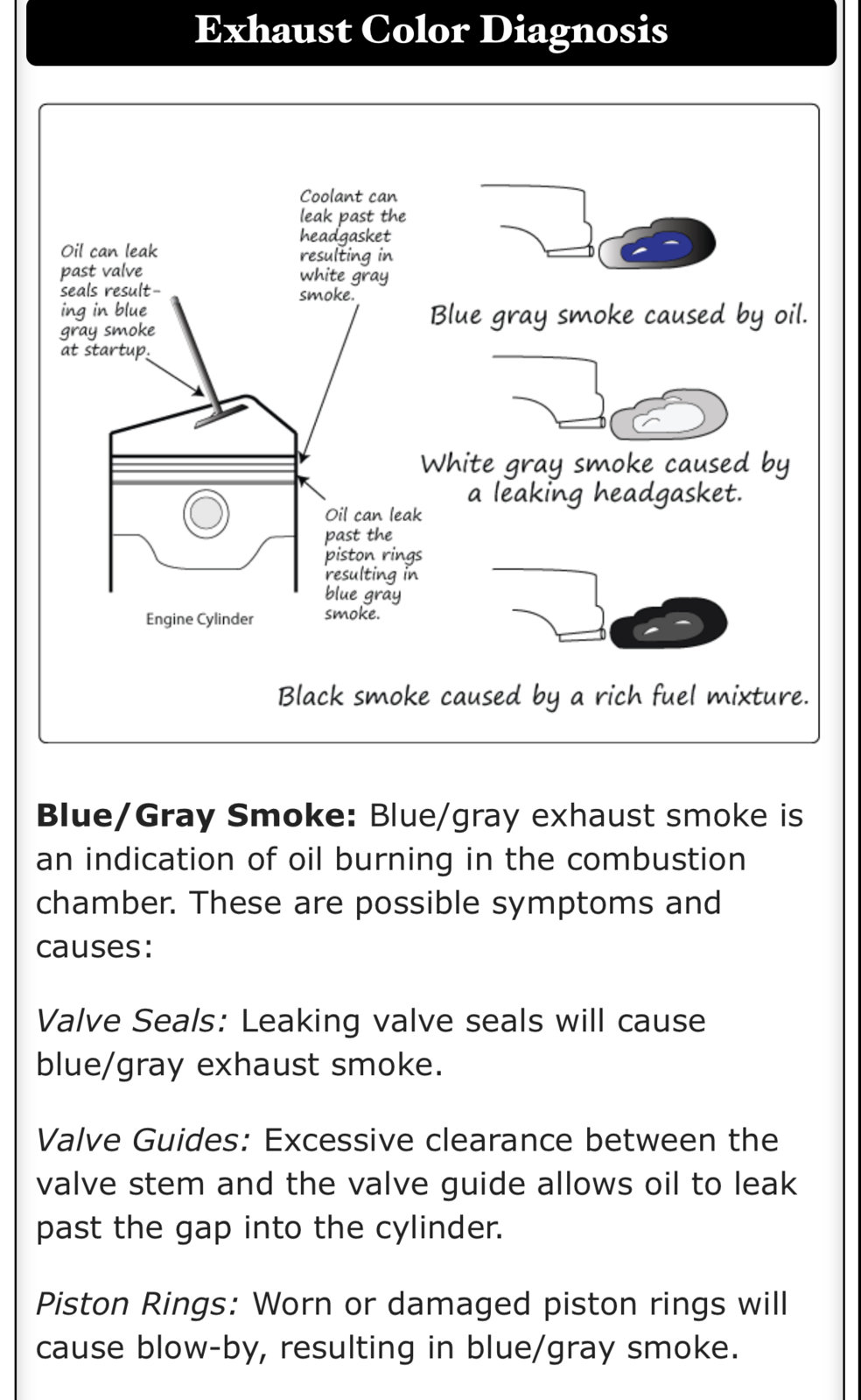

As shown above,..you most likely have a head gasket leak, coolant from the water jacket is passing thru a head gasket, into the combustion chamber. As it gets worse you run the risk of burnt valves/piston in the cyl.
