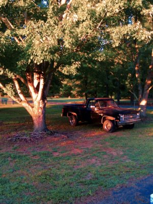

Here's the picture I was trying to send. This is my '83
