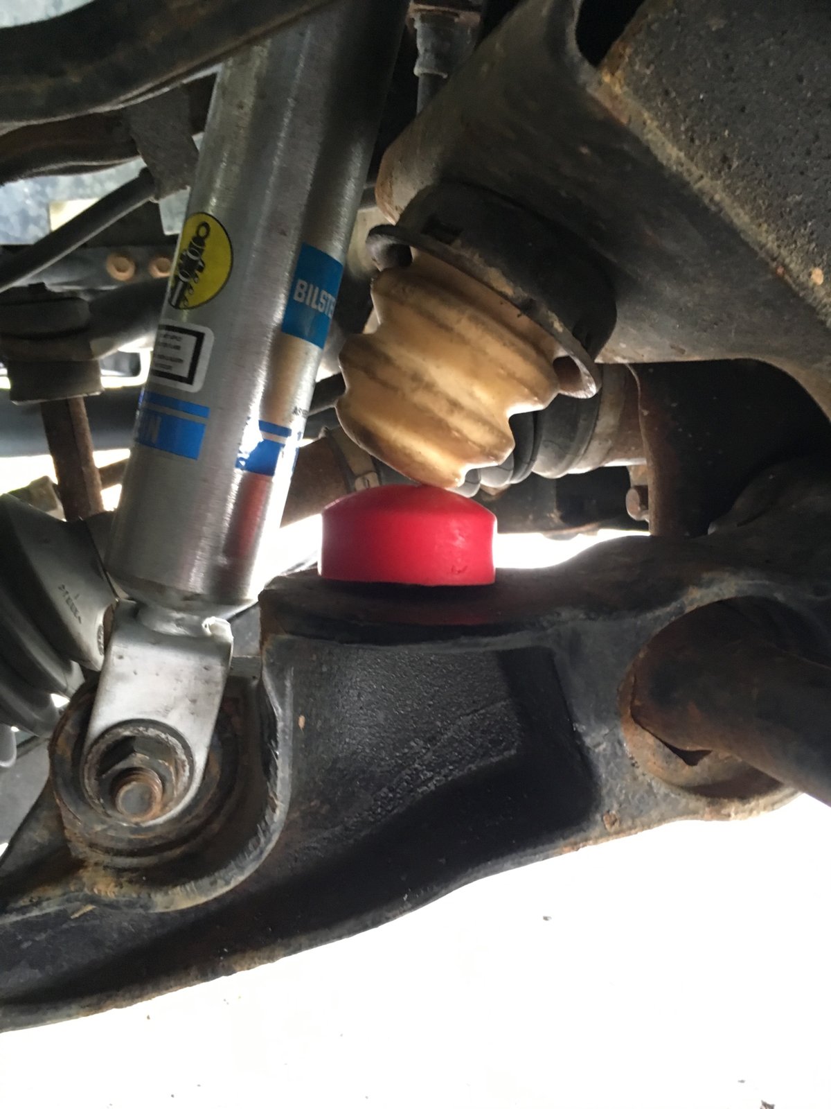

I got the aftermarket ones from Energy Suspension off Amazon, something like $14 shipped. Drilled a hole through the pad on the lower control arm, and bolted them in, after hitting them with a belt sander to create a better angle of contact.

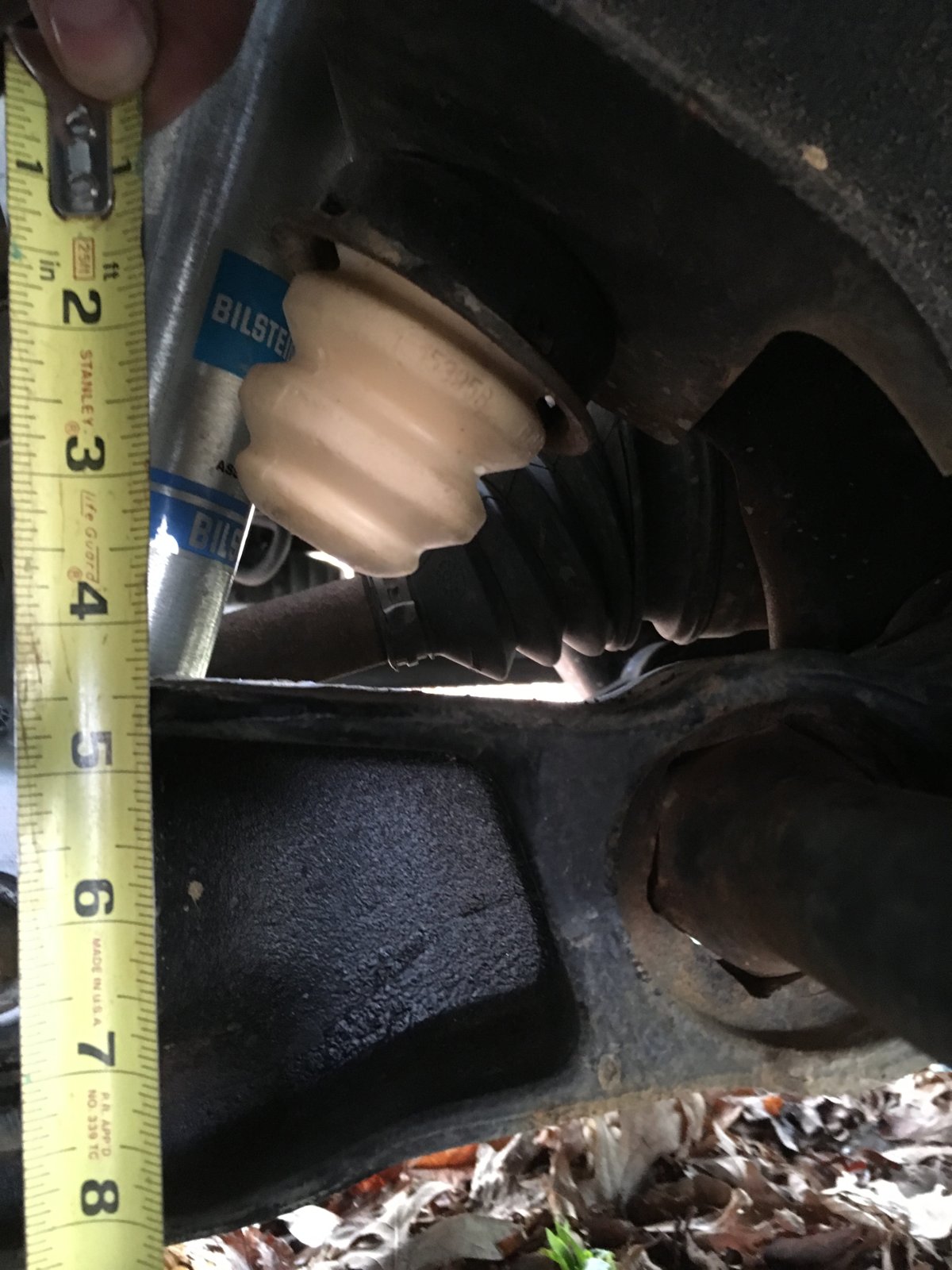

I went with stock jounce stop replacement, energy suspension spacer

So are they supposed to touch at normal ride height? So if you raise it with keys you need to add the spacer?
