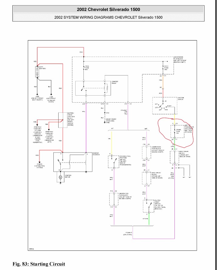

yeah, i think crank fuse would be a good one...wouldnt even have to mess with going under hood twice as its right on left side dash...just slide it in a blank slot or under car mat. I attached a diagram so folks can see its role in starting circuit.
