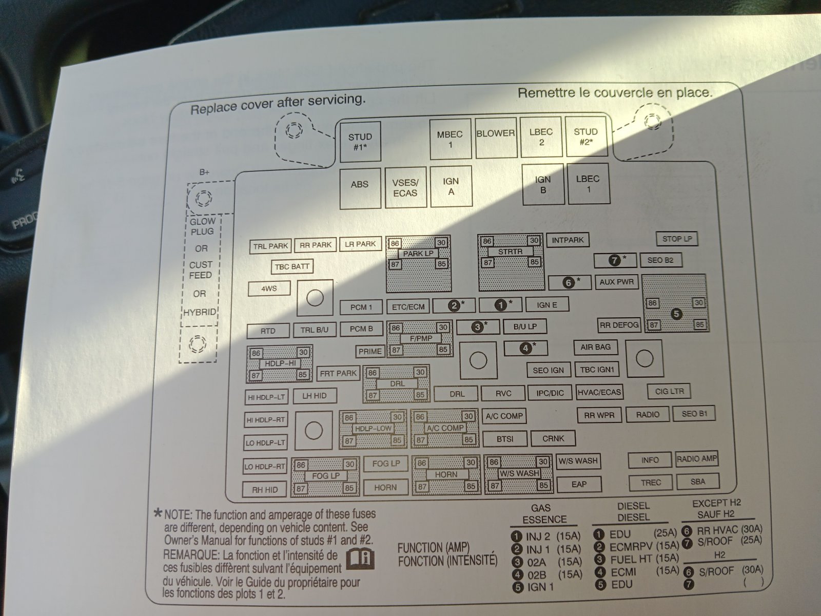

I thought about the fuel pump relay I just don't want to mess up anything on my computer from what I can tell I've got a few more choices like ignition 1 ignition 2 crank fuel pump and starter relay
You won't mess it up. With the engine running, pulling the fuel pump relay is how you change the fuel filter. It stops pumping fuel, and it burns off what it can in the line.

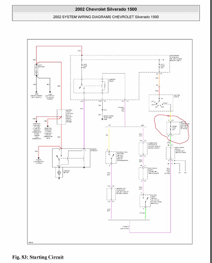

yeah, i think crank fuse would be a good one...wouldnt even have to mess with going under hood twice as its right on left side dash...just slide it in a blank slot or under car mat. I attached a diagram so folks can see its role in starting circuit.
