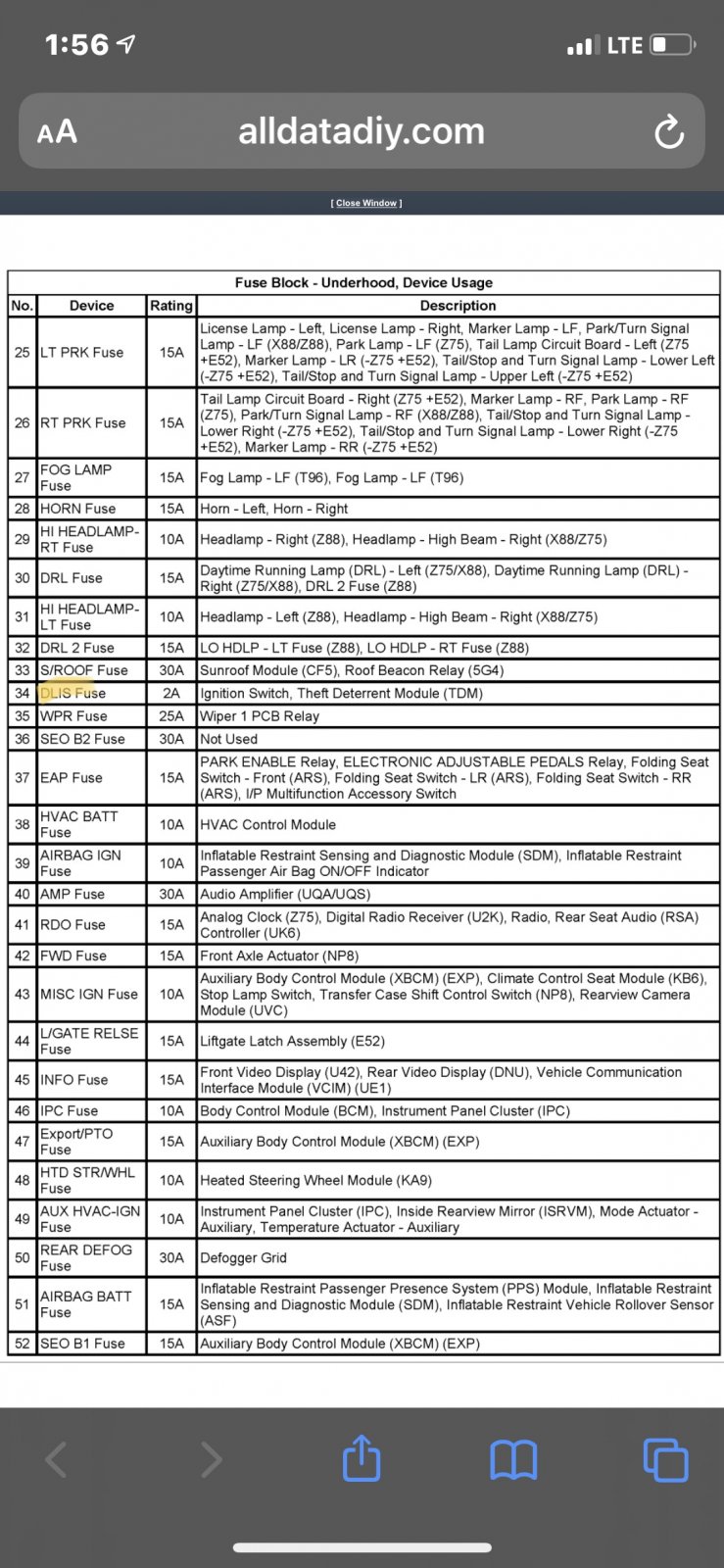

Check ground wires..I don’t think the issue was related to that fuse. The truck sitting for a little while triggered something that may have been corroded or loose. The DLIS is the ignition switch and theft deterrent module.
