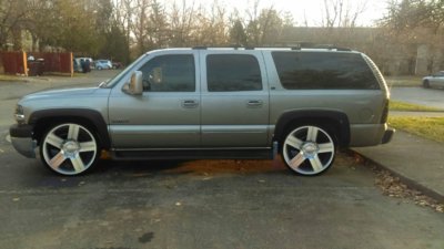

Here is mine
Isaiah W
Isaiah W
Nov 20, 2016
78
154
I like that. How much drop is that?
No idea, previous owner did it. I'm guessing it's a 2/3. The 20's with the 275's are tight but work. Only rubs on LF at full lock in reverse.
