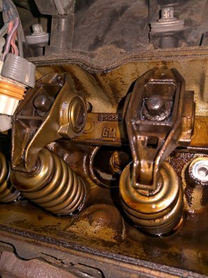

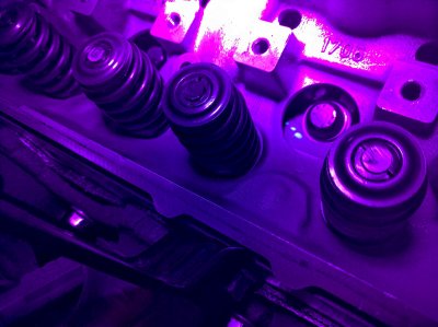

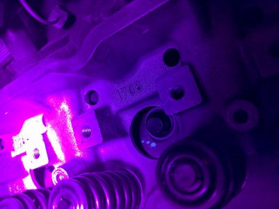

Larry was very helpful with my questions when I was going through replacing heads and then replacing a refurb that cracked, too. In my case, they were both 706 castings and cracked in the same spot but Larry's were 862, IIRC.
Pull the valve cover, look for milkshake. If none, then look for clean spots near the bolt holes. If none, clean the shit out of the heads/springs/oil ports and pressurize. Observe with your UV light. Mine was obvious within minutes but others have taken significant time to bubble up.
First two were from original to vehicle heads, next two are the refurb that had less than 500 miles on it with UV - note the bubbles and visible crack: (click for larger)
45,013

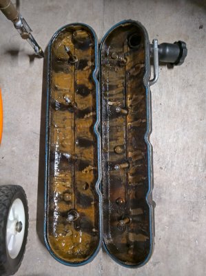

To make a crack even more difficult to check, in addition to only showing when torqued down, the crack may not leak unless it's at operating temperature. If you change your oil regularly and use good oil and the underside of the valve cover still looks dark and gunky, you may have a cracked head.
