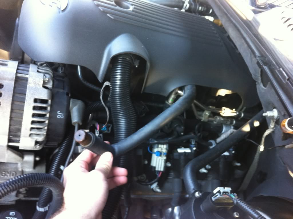

My hose looks diff from all the other ones I've seen. There's something on the end of the hose? Is it the PCV? Does it need to be taken off before seafoam? It's pretty nasty looking. Is this the right hose?
It's the 5.3l
ATL
Dec 27, 2011
491
the tube in your hand in last pic is the pcv tube, that in the end of hose is the valve. it wont want to come out after being in there so long, but pull and twist on it and itll slide out. i think poured the seafoam in a cup, and use the hose in your hand to suck it up

durrrrrrr, lol, youre right

I just did a seafoam today through that hose. I don't think it's a pcv valve because mine didn't have anything in it. Just basically a spacer. Regardless, that's where I put the seafoam in and it sucked it up just fine.

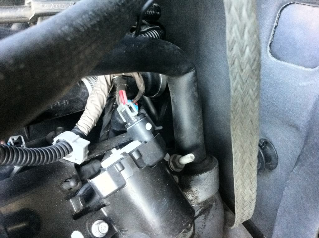

It's not the PCV valve. It's the vacuum line ya want. I just replaced my PCV valve. Here is the vacuum line you need to pull.
This is your PCV.
I connected a cone to my hose and pour it in that way.
