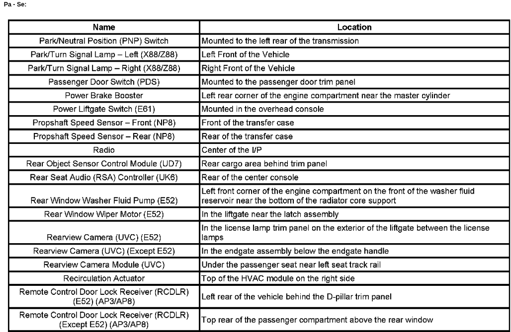

It looks as though I need to replace my Remote Control Door Lock Receiver (RCDLR) module on my 2007 Yukon XL Denali, and I'm having a challenge to find out where this module is actually located on my truck. I've searched around, and I get different answers on where it may be located.
Any tips that will help me find this module will be very much appreciated.

FWIW diag procedure here:
Location here (see the last two in the graphic, depends on RPO code).

Be careful with messing with this, make sure you remove ground post before touching. I have had a hell of a time getting mine working again, DO NOT BUY THE UPGRADED PART NUMBER THAT SAYS IT WORKS. you will also have to have the module programmed after its installed. i found a dealership for $190 to do mine.
