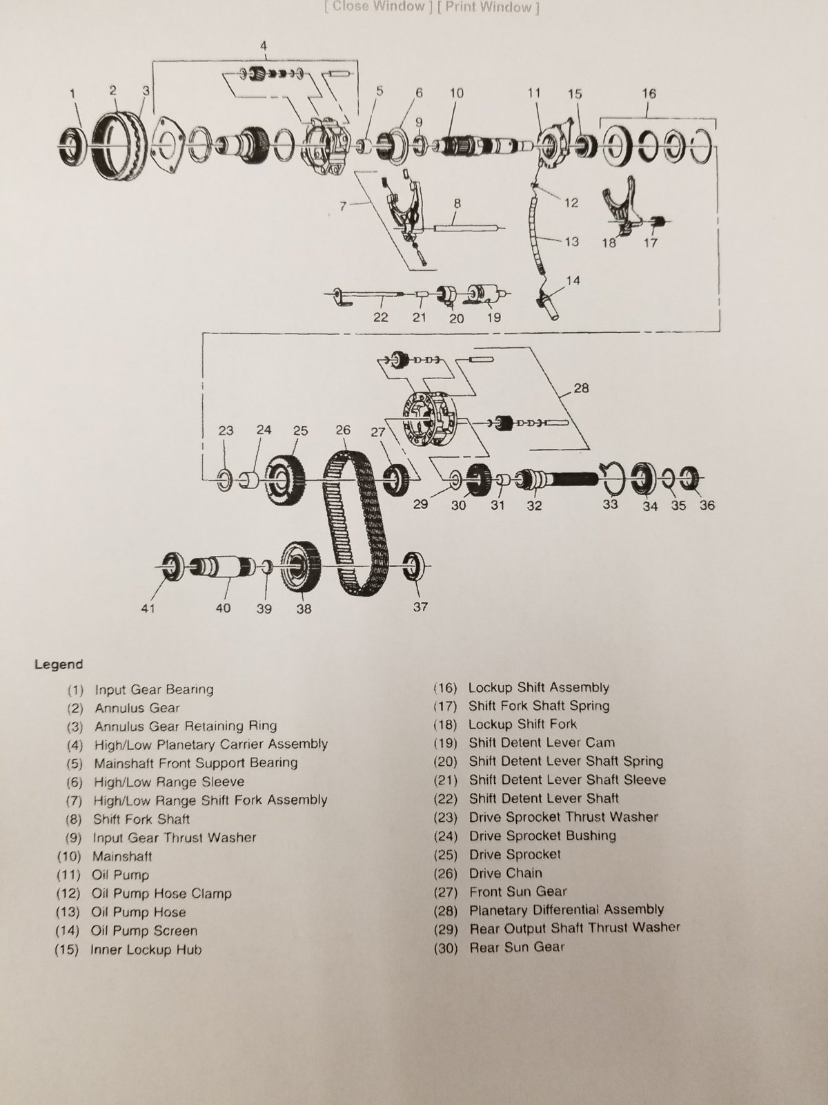

The differential in your transfer case is not allowing the front axle to slip, move independently, of the rear axle.
Is that the plabetary differential assembly you are refering too? I was told by the mechanic that it was fine, some barrings, shifting fork, lock up shift assembly, and oil pump were replaced.

All three differentials are the planetary style. My earlier post referred to the one in the middle as that is where I think you should start and then check the others. You don't live in Florida by chance do you?

No I am sorry to say I dont live anywhere near flordia. I see a High/low planetary carrier assembly and planetary differential assembly in the NR4 transfercase.

That's the one. Now which of those two inside the transfer case I do not know. I was seeing if you lived close by and could hook up my Tech2 computer to see what the computer is seeing and pull codes.
