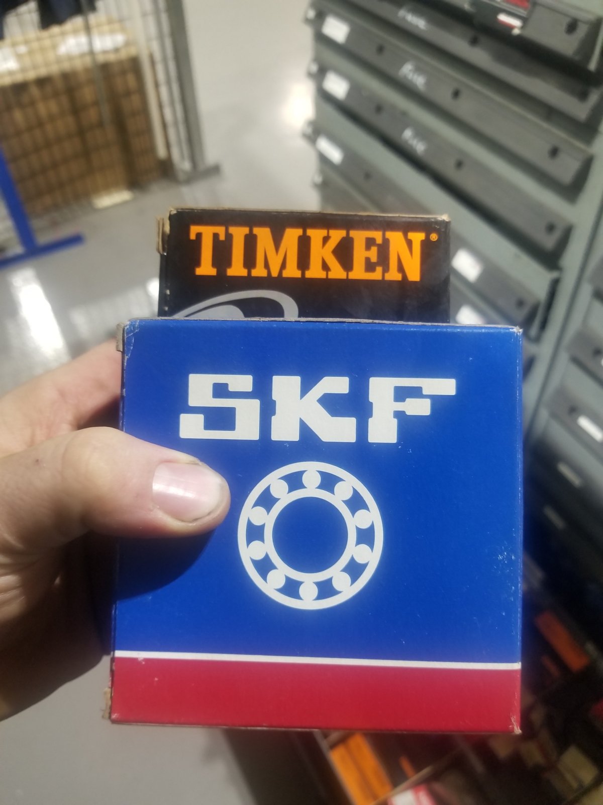

Moog is shit, IMO. They maybe used to be hot shit, but I've yet to get anything from them I can look at and say, honestly, "this is quality"
Timken has always made top of the line bearings. Not just for automotive, but large scale industrial stuff. Is there a bearing on a critical piece of mining equipment that costs $3k+ per hour on downtime? It's probably timken. No, seriously. I have a bit of contact with the heavy equipment world and the folks there tell me that on anything larger, or more labor intensive to get to, they use timken. Smaller stuff, non critcal parts, low labor things use SKF. Take that info how you will

I have relayed this once before on here, but will do so again quickly, as supportive info to this convo. The facility I work in also houses a one-client print shop (whose things land on all of our porches and are produced by the millions, wink nudge) along with an international printing equipment supplier. ALL those rollers that spin 24/7/365? Timken boxes everywhere.
I work with aerospace companies a lot. I also have a few helicopter mfr as clients. Rotor bearings? Timken.
Mars Rover? You get the idea.
